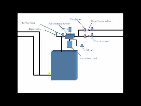

    Zman - what do you mean by pumping away? Do you mean during fill, or that my radiant circ's should be drawing vs pushing those loops?
  • ewang
    ewang Member Posts: 81
    Zman - I see what you are saying. Nicely explained in this video, to pump away from the boiler...
    https://www.youtube.com/watch?v=IMLwFeYNYKs
    hot_rod Member Posts: 27,459
    Here are some graphics to help understand pumping away from the expansion tank.
