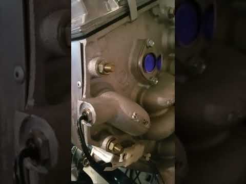

I have a 11 yr old GB142 that just began making a loud whistling noise as it heats for H/W. Doing some Google'ling it appears that I might have a boiler thats "Kettling". The whistling sound is not there at burner start up but as it goes to higher flame the whistling starts and increases in loudness as the boiler heats. When the burner shuts down the whistling continues for a few seconds and disssapears. I cleaned the combustion side of the boiler in hopes that maybe thats what was causing the noise but it's still there.
Last night I tried back-flushing the HX to see if anything would come out. The water came out clean and clear with no scale particles with what I think was good flow. I purged this boiler 2yrs ago when I added radiant to a new room...I expected the water to be discolered but maybe this is why it looked so clean.
I can hear that the sound is coming from both the left&right side of the HX. I think my next move would be to flush the HX with a cleaner.....Rhomar 9100?
I'm going to take a video and hopefully get it posted in a bit.
Anyone run into this problem or have any ideas?
Here's a video; https://www.youtube.com/watch?v=tG0ma5vVuAQ

  • Zman, Thanks for responding. System is piped with factory pump manifold, 4zones of heat and DHW. The supply/return Delta T at the boiler (above pump manifold) was 38.3*. The circulator for the H/W is a Grundfos US15-58FC. this is normally set to the lowest speed and with a 153* BT, 75* DHW Tank my delta T is 16.5*. Same temps on Highest speed gave me a delta T of 9.8*. Boiler pressure maintains at 16psi and does not fluctuate at all.
    Couple things I noticed while working on it.
    The boiler starts the loud whistle at about 180*BT.
    While making the whistling, if I switch the DHW circulator to the highest speed the whistling will almost go completely away even as the boiler temp climbs into the 180*s. I tried running a zone of heat and setting the DHW circ back to low and the whistling came back.

  • So this morning I ran a zone of heat with the boiler temp climbing to 190+ degrees without any whistling noise. Seems my problem is only with the DHW loop. I pulled the DHW circ off to check the impeller and FC. figuring it was plugged with something but it was clean. I reinstalled the pump with new gaskets, set it to high and gave the loop a good purge.
    After taking a shower later in the day I went back to the boiler to watch it reheat the tank. The boiler temp climb back up into the 190s without making any noise whether the circ was set to high or low....? I ended up leaving the circ in high and we'll see how it goes.
    Wonder if it was some air trapped in the loop...?

  • BillyO, I've heard this before when I used to service propane pool heaters. My problem was the DHW loop. Must of had just enough air in it to slow the flow through the HX. Been working fine now for 2wks...?
