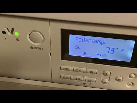

  • sunlight35
    sunlight35 Member Posts: 35
    I recorded a video of the start-up:
    https://www.youtube.com/watch?v=LTqt_xNjvi0
    See if it offers any clue from the sound that it made.
  • Ironman
    Ironman Member Posts: 7,851
    That doesn't really offer much other than it showed 73* outside temp. If that's correct, th boiler would be in WWSD.
    Bob Boan
  • sunlight35
    There is a call from DHW
