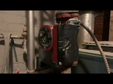

Hi everyone, I've been lurking for a while trying to learn enough about radiator systems, boilers, and circulating pumps to troubleshoot a persistent rattle. I have tenants moving in soon with a new baby and I'm hoping to get the nursery as quiet as possible.
Note on the system:
- 110 year old with a mix of Cast Iron fed by steel that looks like 1", a bit of copper to basement wall mounted rads (3/4 inch maybe), and a couple newer rads running pex (looks like 3/8").
- Circulator seems to run constantly (it doesn't cycle with the boiler). This is in Canada.
- Circulator is Grundfos UPS15-58FC
- There is a bad leak near the boiler which I plan to have fixed when it is warm enough to shut down the system for a couple weeks
- The system has been bled for the most part, but there is one upstairs rad that needs to be re-bled about once every week or two for 3-4 seconds (it makes a "tinkle" noise prior to being bled which, when bled, goes away).
- There does appear to be an air lock in one of the more recently added rads in a back room...I haven't figured out how to fix this yet, but it isn't annoying me like the rattle.
Are there any steps you can recommend to troubleshoot or mitigate the sounds?

I presume -- I hope! -- that there is an expansion tank and pressure gauge on this system? If so, what does the pressure gauge usually read? With the boiler on? With the boiler off? The combination of the leak and possibly low pressure may account for the air getting into the system and having to bleed that radiator.
The pump noise -- there are others on here far more experienced than I, but I'm think that it sounds tired... bearings or seal.Br. Jamie, osb

> @Tim_D said:
> That circulator rattle is common in Grundfoss circs when they are running to far to the right on the curve. In other words, there is no system head and it is free wheeling and killing itself. Could also possibly cause NSPH issues, also very bad.
Hi Tim, could you explain what “running too far to the right on the curve” means?
Is there a way to fix this free wheeling problem or is there another pump that would improve my situation?
I’ve been googling Net Positive Suction Head, but nothing seems to give clear directing on how to solve for it? Do I need to adjust the pipe design at my boiler or can I fix this with settings?
Thanks for the input, Tim!0 -
Technical terms... "running too far to the right on the curve". What @Tim McElwain is referring to is what is called the characteristic curve of a pump -- the relationship between the pressure which it is developing and the rate of flow through it. "Running too far to the right" means that the flow rate is towards the high end and the pressure developed is towards the low end of the pump's capability. In some pumps under those conditions the impeller -- the moving part -- can move slightly along its axle and that can make a rattle. The way to fix the problem is to increase the pressure the pump is working against, such as by slightly closing a valve in the circuit. Wasteful of energy, but it might help.
Net Positive Suction Head is the term for the absolute pressure at the inlet of the pump. Absolute pressure is the pressure related to a pure vacuum, rather than to the atmosphere (that's called gauge pressure) and if it's too low the water (or whatever) will boil, then the bubbles collapse in the pump and make a racket -- or worse. The way to help that is to increase that pressure. Increasing your overall system pressure -- as I suggested earlier -- will help. In hot water heating systems, it also helps -- sometimes a great deal -- to have the expansion tank and water feed very near the inlet to the pump.Br. Jamie, osb

It appears to me that the pump is installed backward, but whata I know. The motor body could have been rotated at the time of installation. I can't see the volute very well in your video. If it is the newer 15-58 FC with the internal flow check, maybe that is malfunctioning.
The tridicator seems to me in the wrong place.
You could always pull the four allen head screws and remove the motor body from the volute. I have found solder balls and wood sticks in a volute once. Check for the smooth rotation of the rotor while you're at it.0 -

I don't think there's a simple solution to this problem, such as adding balancing valves. Pumping away and adding a micro bubble air eliminator should help with the air issues, but the distribution piping sounds like a nightmare.
If it was my house I would probably rip out the all the piping, correct the boiler piping by moving the expansion tank, air eliminator and circulator so it is pumping away on the supply side. I would home run PEX to all the emitters and back to manifolds on the boiler, piped reverse return with flow setters to each emitter.0 -
Based on what I've read I believe the only issue is the noise. Assuming that's accurate, my guess is something is bad in the rotating assembly of the circ, although a rattling check valve external of the pump could be the cause as well (doubtful).
Try touching something like a screwdriver to your ear and various locations on the circ (creating a stethoscope). You'll be able to get a better idea of where the noise is originating. Close the valve and see if the noise changes. Same for changing circ speeds (does the noise stop or just change).
As your system has the old "captive air" expansion tank it is almost impossible to remove a substantial amount of air from the system fluid. Air, water and cast iron/steel create rust, and rust can cause sleeve bearing failure in these little circs (to be fare, all wet rotor circs not just GF).
It's possible to take the motor off to inspect the rotor, impeller, bearings etc - just remember to isolate the circ from the system (close the valves up and downstream) and turn the power off. You'll also need a metric allan wrench - if memory services me correct.
The wallies are as usual correct regarding running the pump off it's curve - think of how your car's engine sounds when in neutral at 3,000 RPM vs driving uphill against the wind at 3,000 RPM. Like car engines, these little circs don't like to "free wheel" at higher speeds, operating better under load.
In my 17 years with that particular manufacture I've occasionally seen where the circ's rotor rubs against the rotor can (caused by abnormal flow, abnormal system pressure or worn bearings as a result of abrasives in the system fluid).
Probably time to replace the circ... Might be a good time to check things like strainers, water quality etc at the same time. If it was my system I would replace the tank with a newer bladder type and add a good air separation device. Less air, less corrosion, longer component life and improved heat transfer (efficiency). If investing a little bit, invest a little more by having a professional heating person inspect/update your system.
