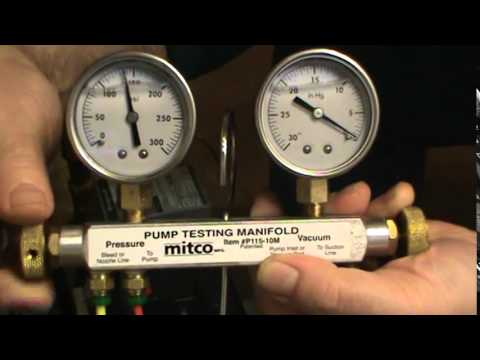

    Another reason to call a tech is to make sure the oil pump pressure is correct. This can change the flame dynamics too. A tech would have the equipment to measure pressure.
    https://www.youtube.com/watch?v=YH_0FuBK46k
    Thanks for the video.
