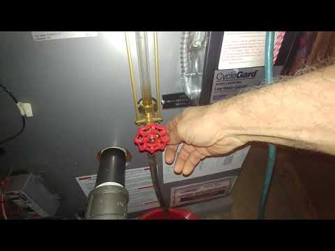

Gentlemen,
We have a new replacement boiler which repeatedly shuts down from low water and bangs at the moment of shutdown. The noise is coming from the Hartford loop. The attached photos show what I think is Squick , which needs to be removed. The contractor has returned 3 times to flush and skim, with very little improvement. Any suggestions?
Thank you all for your speedy response. Photos of the boiler are attached. The installer is coming tomorrow for a fourth 2 hour skimming session. I asked about possible chemical treatments to clean it out, no answer. The skimming seems to make a small improvement, but the junk reappears in a couple of days, along with the low level shutdowns and noise.
    ethicalpaul Member Posts: 8,050
    hmm wow I wonder what his skimming procedure is

    You mention skimming, but also mention Squick. The ones I see pop up on here think Squick replaces skimming.
    Skimming takes hours of slowly taking water off the top of the boiler, has the contractor been down there for hours doing this? If not they are not skimming. Your description sounds like classic surging caused by oils on the surface of the water, but out of curiosity can you post pictures of the install? If the boiler isn't piped correctly that can exacerbate the surging issues.
    2014 Weil Mclain EG-40
  • The installation manual for the boiler probably gives clear instructions on how the boiler should be cleaned.
    Peerless for instance suggests adding Arm&Hammer washing soda and simmering for a while, followed by draining, and skimming through the port installed specifically for that purpose. Skimming will take several sessions of several hours each, and adding Squick is no substitute.
    Is there such a port on the boiler now? If not theN check the instructions to see what else may have been left out.—NBC

    Your recently posted photos of the boiler show a good install. I would be surprised if that installer didn't know how to properly skim it given they set up a proper skim port.
    It generally takes multiple skim sessions to remove the oils and sediment from a new install. The boiler casting, in particular, takes some time to leach out all the oils and foundry junk. My own experience is it took several skims every few days for the first week, then about once a week for a month, and then every month until the end of the season.
    You probably just need to skim some more. It will clean up over time.

    Thanks. I had to request the skim port as our last boiler didn't have one and it hampered the boiler cleanup. With this install we had to beg them to start skimming as they would not acknowledge the problem.

    It doesn't seem to make that much difference with Force boilers, hot or cold. One can skim for hours and seemingly get nothing in the bucket. It is only after weeks of run time does the goo show up. I think that each manufacturer has different formulations with their oils (and some vary their formulas with different models...I'm looking at You, Weil Mclain!) , but they all of them seem to consist of two broadly different parts (1) A water soluble series of compounds which appear to be largely made up of surfactants... they cause the most problems initially in causing wet steam... lots of bubbles! But these compounds are also the easiest to remove, i.e. drain and refill a few times. (2) The second group appears to be insoluble or partly soluble oils. These oils appear to form a colloidal suspension with the rust particles. The various traps and drains we add aids in capturing this goo. Columbia boilers had at one time seemingly the most tenacious goop in their oil formulation (which is what this boiler above replaced). As I understand it, many of the formulations needed to change due to EPA regulations.
