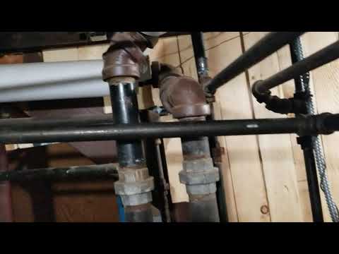

I've done a test and my homework.
I removed the air vents from the East Main and Used them on the West side. I expected that the air would now "get out" of the East much slower, giving the West a chance. Not even close. From cold system, I fired the boiler and steam started entering the header. In the header are two take offs, one for east and one west.
The east (pic left - pipe coming at you) started getting hot, the west (pic right) stayed cold. Shortly thereafter the returns from the east were hot and the first elbow of the west run was still only warm to touch. I'm lost. The west side is way shorter than the east and had main line vents. Why was that still cold and the East flowing? Easily another 20min before the west side heated up.
At this point I noticed condensate dripping out of one of the vents on the West. I busted the vent when installing it, however I should not have water up that high for sure. I looked at the boiler and noticed the water level was high. So, I shut everything off and let it cool, while I fixed some of the leaks I had on the West side and replaced the air vent. I saw the water level after cooling was above the sight glass. I wondered if that had way too much water in the system and maybe my drains were full? I skimmed the boiler to get the water level back to the water level mark on the boiler.
With everything back together, fired the boiler back up. Water level looked good, but after the east side got hot again, water level was dropping on the glass and then the LWCO turned off the boiler. Autofill kicked in, boiler restarted, steamed a while, then LWCO again, no autofill, just condensed and refired. LWCO kicked in again and then autofil. I want to say it cut out one or two more times, and then stayed running. After a long wait, got steam on the West side. However now the glass is full of water. I warmed up the house and then turned the stat down while I did my homework.
After I did my homework and while I type this, I am letting it run again. Before the boiler started, the sight glass was totally full. I heard air flowing out of the radiators on the East main. Then the boiler cutout again. I am hearing the boiler short cycle again and again.
So, like I said, i did my homework. I calculated the lengths of all the mains and then the cubic feet. They are not long and they do not have much volume. The East side "T's" north and south. I have no idea how to add a vent to the north end without busting up some really old pipe.
West total is 0.75 cuft
East total is 1.18 cuft
I can't imagine needed more than a couple Maid O'Mist #1 vents on the end of the West or East, right? I had 4 on each end.
I also calculated my radiator EDR to figure the cu ft in each of those as well. I also calculated lengths of the feed from each main to the radiator. See the table. The results were not as obvious as I expected. I calculated the minutes to evacuate air from the radiators based on the vent size. Do I want all of these to match? Or do I want the West side to be faster than the East since I can't get steam on the west. I have no idea where to start here with the venting.
Also, on the main air vents.... My mains run tight against the joists. I do not have room to stub up 10" to the vents. Does anyone have a diagram that shows some good details on how to pipe the air vents?

    Let's focus on why your LWCO is flooding your boiler.
    Can you post more photos of your near boiler piping? From the posted photo is looks like you header slopes down, loops back, then up hill to the two take offs, and then to the equalizer?
    What's your pressure gauge doing while it's running?

    I'm with @acwagner -- forget the venting until you figure out why your boiler is flooding. Do you think it was flooding before? I don't remember reading about that. That could certainly keep steam out of part of your system, if it's flooded with water!

    Where are the high points on your steam mains? Are they counterflow (high point at the far end), it sure looks like the one on the right might be.
    But I see in your picture 3 vents on what look like drops from dry returns to the wet return near the boiler. ThT will work, and it looks like you have room for larger vents there, either Gordon #2 or big mouths look like they would fit.
    Are you sure the problem main does not have a low point somewhere along it that could block the steam.
    Alos check that the wet return of the problem main, where it drops below the boiler waterline is not blocked or plugged.
    Are there any valves on the mains or wet returns?

    I bet your return line is partly plugged- that's why the water level drops when the boiler is running, causing the feeder to feed, and when the system shuts off the water slowly comes back, flooding the boiler.

    Your previous post showed the Maid O Mist main vents in the wrong place, they should not be inline with the main on a reducer so the vent is at roughly the same height as the main.
    On your systems the main vents should be near the ends of your dry returns. You have two chrome main vents in picture 1, those are your main vents. Not the ideal location, should be set back 18" but it can work. It looks like you can put a nipple on there to raise them up, do this as high as possible and add more main venting as I said above.
    Plug where you have the MoM's, it's the wrong place and is likely the cause of your overfilling issue.

    Picture is deceiving. High point is the elbow just above the boiler and low point is the equalizer.
    I think my pressure gauge is the wrong size. When the system is off it reads 1psi and when it is doing this bouncing between 2 and 3. I need a gauge that only goes 0 to 5 or something.
    @ethicalpaul I think I have made this short cycling worse as I have been messing around.
    @Gary Smith I am fairly confident that my mains are not counter flow. The high points are at the boiler side and low ends at the drops for condensate returns. I have not removed insulation to check for low spots, but running my long level along the whole run, it is always pitched. I am concerned about the first drain shown in West 1. Piping from boiler pitches to that point before going over the main header. People said the return wouldnt be clogged. I think this proven that when it is off it is cold, but when steam finally makes it that return gets nice and hot.

    For #3, yes, it should reach a steady state of steam production to water return. The water level shouldn't drop like you are experiencing.
    So, either the water is being blown out the boiler into the system, or you have a slanted waterline. I noticed in your photo coming out of your boiler it is reduced to 2".
    In the Lost Art, Chapter 4, he talks about having a reduced riser to the header which cause the boiler water to favor the riser side (page 49 on my version).
    Does the waterline drop very quickly in the cycle, or is it progressive over the whole cycle?
    And, when the water level drops, does it take a while to recover, or when the boiler shuts down it's back to normal in a few minutes?
    If it recovers fast, it's probably a slanted water line. If it takes a while for the waterline to recover, it's probably out in the system and taking a while to get back.

    Confusions. Are your "dry returns" really dry returns -- that is, fully separated from the steam mains by traps so that they can never see steam -- or are they actually continuations of the steam mains back to the boiler? This is not a trivial question.
    If they are actually continuations of the steam mains, then you can put your vents anywhere along them after the last radiator runout that works. Often the easiest place for them is at or near the boiler, but anywhere will work.
    If, on the other hand, they really are dry returns (unusual in one pipe systems, but not unheard of), then you either must have crossover traps at the ends of the steam mains themselves or the steam mains have to be vented at the ends. If you are using crossover traps, then the dry return must be vented, but the steam mains don't need to be.
    As to what kind of vent. Yes, BigMouth vents do get you more venting for you buck than Gorton #2s. However. Gorton #2s have a float in them, and if there is any possibility of condensate coming anywhere near the vent, I'd use the Gortons.
    On the boiler flooding -- or conversely, the water level in the boiler dropping. Again, a critical question: does the water level drop while the boiler is steaming? Or does it seem to happen after the boiler shuts down? I'm going to assume for the moment that it's as the boiler is steaming. You mention a concern about the ends of the returns near the boiler being wet. This leads me to wonder... are those returns near the boiler low enough that water could be backing into them as the pressure in the boiler rises? If so, that's where your water is going. To go back to the commentary on venting, whether those lines are real dry returns or continuations of the steam main, they must be high enough above the water line in the boiler to stay dry -- that is, 28 inches for every pound of steam pressure at the pressuretrol cutoff. If, on the other hand, they were once wet returns but the new boiler has a lower water level -- a common enough error -- then they must be low enough so that they are never allowed to become dry, and that must be true for their full length, not just at the boiler.
    If, on the other hand, the water level in the boiler drops and recovers very slowly after the boiler stops firing, and you have wet returns, those returns could be clogged. The water level in the boiler should recover to nearly the starting level within two or three minutes after the burner shuts off. Anything longer suggests clogged wet returns, slowing the condensate. Not that it's impossible, but dry returns and vertical drips almost never clog, and a steam main clogging would be seen in other ways.

    So I can't let this sit. I noticed the radiator at the end of my west main was squirting water out of the air vent. Like streams of water. First I realized the pitch on the radiator was off. So addressed that. Then I was curious....just seems like there is a lot of water in the system. So after morning warmup. I turned off the boiler and let things settle. I broke the union on my condensate line right near the main steam line. There was a descent amount of water that poured out. I was then curious and went over to the boiler. All the air vents on the returns at the boiler are at different heights. I grabbed one I could reach and started wrenching it off. Sure enough when I got it loose water poured out. The water in the sight glass fills the glass. I then opened the pressure relief valve and water drained out of that till I let it go quick. Started taking off other air vents that were lower than the first and more water came out. The water level at the first one went down as I opened lower ones, so clearly water is communicating between the pipes and they are not clogged. So now the water level is at the height of the lowest air vent. I opened the skim port and the water level at the lowest air vent dropped. So I then drained water from the system until the sight glass showed water at the water line.
    The first elbow to the east horizontal main is higher than the west. Also the first drain point on the west is potentially below where the water level was.
    So I assume cold, my header and the vertical pipes to the east and west along with some of the west main is full of water.
    Now i just need to figure out how to keep the LWCO from cutting out the boiler.
  • bvaughn76
    bvaughn76 Member Posts: 54
    I fired the boiler with all.the vents off and me listening and feeling the pipes.
    Produces steam in like 5 minutes. The east pipe got hot like immediately and shortly thereafter the return from the North East was flowing water. I could hear it from the opening in the return. At that point I shut off the boiler.
    The first elbow for the east main was too hot to touch. The west main was barely above room temp.
    There are no main line vents on the North end of the east main, but clearly that is where the steam is going first. Do I need to trick it to go somewhere else? There are four rads on that section, three being quite large. Downsize the vents there?

    I think you need to abandon the vent situation for the moment and find out where and how all the water is getting into the mains.
    IMHO you shouldn't hear water flowing anywhere, there really shouldn't be enough volume on a system like yours to hear that.
    @Gordo recently posted this video showing the condensate return opened up and draining. You can see it's a small volume of condensate coming from the system. This is the only water that should be there.
    https://www.youtube.com/watch?v=9Ime0nqP548

    @KC_Jones, before I started to take things apart to realize that my water level was easily 6.5ft above the floor, yes, I heard lots of water movement. Which makes sense if the water level was that high. Why water kept creeping up is because the boiler would run out of water and the LWCO would kick in and the autofill would add water.
    When I skimmed the water out again and got things back to normal, the flow i heard in the return was definitely like a dribble as he was showing it.
    What I have been reading here is that if steam starts condensing it creates low pressure which draws steam towards it. So, if the air vents quickly out of one main and the radiators and system starts condensing, pressure will be lower and steam will favor that. True or false?
    If true, I am trying to get steam to the end of my mains as fast as possible and as equally as possible. Right? Venting plays a part in that.
    I think the water level issue played a roll in why the west was not heating up, at least when the system got to the state where the autofill over filled the system.
    Why enough condensate wasnt coming back and making the LWCO kick in, that is a concern.

    I think that at this point we need photos of all your near boiler piping, as well as a pretty good description of the piping out in the building.
  • bvaughn76
    Near Boiler Piping
  • bvaughn76
    So, I ran the boiler with the vents removed to see what happened again.
    When I heard water flowing (trying to get a video to load up hear), at the "T" closest to the autofill, the water level in the sight glass dropped and then the boiler turned off. I assume LWCO kicked in. Heard water flow and then at one point it flowed up out of the "T" where the vent would be.
    The boiler fired again and same thing, after I hear condensate flowing down that near return pipe, the boiler cuts out.
    It did this two more times, on the forth time, the autofill kicked in. Boiler cycled like this 6 more times. The autofill did not kick in again. At this time the two return pipes from the east were super hot. The west side main pipe was still cold to the touch.
    Out of ideas.
