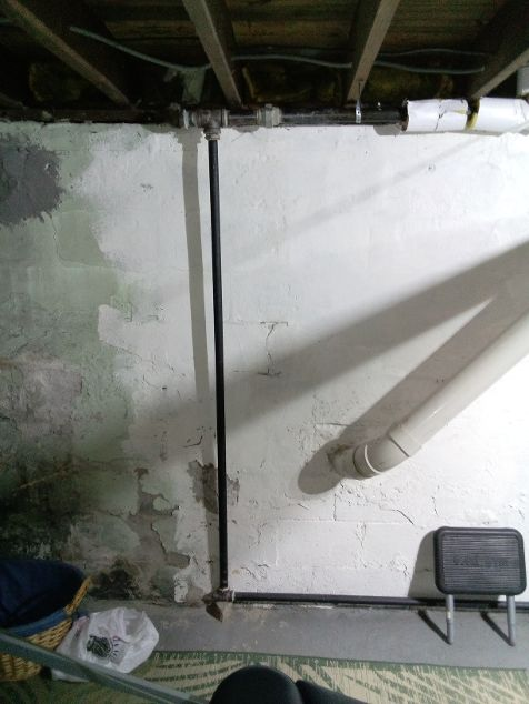

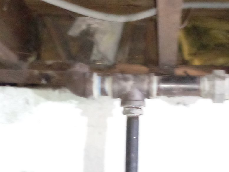

    Piping done over week-end. Dropped 1" pipe from T installed at end of trouble pipe to floor and ran to boiler, tapping-into drip from return. Also re-piped poorly pitched run-out on short supply.
    Will test tonite for any issues.
  • Fizz
    Fizz Posts: 580
    Since above piping fix notice when t-stat calls for heat, boiler pressure runs between 1-2oz, and heat shuts-off by satisfying t-stat, prior to fix, the last few minutes pressure would rise to 15-20oz and shut-off on pressure at times.
  • Fizz
    Fizz Posts: 580
    Re-visit to dropped return. What I've noticed is steam runs down dropped line from tee. Is this normal. All else is good. What has been a constant is with single pipe heat, the main must fill first before rads…this has never been the case. The main vents were at end of mains when we moved here, there is no room for putting vent 10-12" before end, so I added piping extending out and up. Current vents are MOM's. I tried BigMouth and Gorton#2 to no avail. The return of problem line rarely gets steam to vent, other line does. Is this concerning?

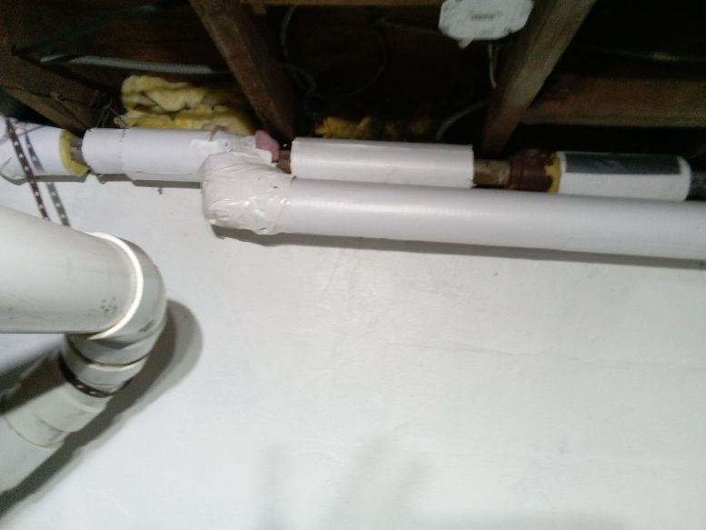

    Couple more pictures from further back would be helpful.
  • Fizz
    Fizz Posts: 580
    hope these help

    Hi @Fizz we are just teasing a bit. It can sometimes be difficult for us to get a good handle on what is going on from a distance.
    It sounds like you have a good understanding that there can be no areas in the system where water gets trapped, and it sounds like you have identified an area where water is getting trapped.
    Running a "drip" down from the trapped area via a copper pipe all the way down to the "wet return" would be a potential fix. Are you looking to do this work yourself, or are you looking for a contractor to do it for you?
    OK I carefully read everything again noting the dates of the posts…I can now see that you had someone add a "drip" for you and you are concerned that steam seems to travel down the drip. It shouldn't if it's going all the way down to the water level. Is it?
    And it seems like you have some venting questions, but I can't quite figure out what you're asking. Do you know how to determine if a vent is operational?

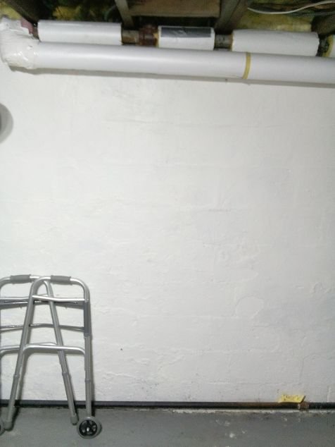

    pecmsg Posts: 7,634
    We need more pictures and clearer pictures from further away and several angles.
    Have tou actually put a level on the pipes?

    pecmsg Posts: 7,634
    how’s the pitch on the upper pipe?

    The drip does run back to boiler below water line. As for the vent issue, it may not be a vent issue, possibly sludge not allowing steam to get to main line vent first prior to filling attached radiation.
  • Fizz
    Fizz Posts: 580
    Upper pipe pitched back up to end of insulation. Prior to drip, water would pool and result in swooshing and hammer. No longer a problem in that respect. just curious as to steam filtering down drip.
    ethicalpaul Posts: 9,076
    edited February 5

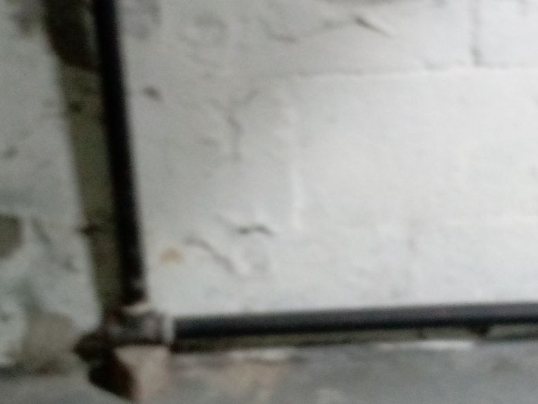

    Steam shouldn't be able to travel through a trapped air section of pipe like in the picture above. The steam could heat the pipe via conduction and the steam could eventually heat some of the air in the pipe…
    What makes you think the steam is traveling down the pipe? There is condensate running down that pipe that could be quite warm.
  • Fizz
    Fizz Posts: 580
    The only reason I have is the temperature on touch is equal to supply pipe. You're probably right, as the drips from main do same.
