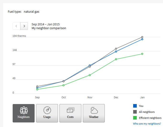

Nat Grid now makes available to us homeowners fancy "us vs. them" gas usage charts.
My charts go back to mid 2014 when I still had a 100K BTU Hydrotherm HC-100 atmospheric boiler and stand alone gas hot water heater.
The full 2014 and 2015 year charts are all atmospheric boiler and stand alone gas hot water heater usage for me.
Starting in June 2016 I installed the HTP UFT-80W mod-con with a 30gal indirect.
The interesting part is not the actual therms used, but how my usage trend changed after the mod-con install from always being alongside "All Neighbors" with the atmospheric boiler/water heater to now pretty much being along side the "Efficient Neighbors" usage wise.
FWIW- our "neighborhood" is a 1960's era development. There are several different styles of homes, but they are all very close in square footage to any of the other models in the area. I feel the NG "neighbors" they used for comparison is actually pretty valid for comparison in this case.

    Hmmm I question what the efficient neighbors are using to heat?
    Is it same, or are they on an electric type system?
    Or are they just holding a lower set point?
    Or is it a fallacy data point to give people incentive to be more efficient?
  • Gordy
    Gordy Posts: 9,546
    44 therms less in the month of January. Than the inefficient neighbors.
    Can you find out who the efficient neighbors are in your area?

    These houses (probably 100+) were all built at the same time by the same developer... every one had gas heat.. and they all had the HC-100 installed. We never see an oil truck around here- unless it's cutting through our neighborhood as a shortcut.
    I looked at my next door neighbors setup last week as she had a boiler outage.. same HC-100 that I had. I checked the boiler breaker at the main panel... six breakers for the whole house on the original 100amp service hidden behind a picture on the wall in the den.
    Most people here still have the HC-100's... I see them on the curb occasionally as they slowly die out... but maybe only three over the last three years.

    ^ no forced air in our neighborhood... these houses sold for $12K-$13K back in1962/3. Everyone got the same appliances, same windows, same siding, and same heating system. All have two hydronic fin-tube zones on one t-stat with one circulator on a HC-100. Simplest system you've ever seen... but it has worked for most continuously since 1962.

    So the efficient group either has a similar set up as yourself, or they use a much lower set point, or possibly setback scheduling.
  • Gordy
    Gordy Posts: 9,546
    The reason I question is I’ve seen how much blood, sweat, and thought you put into the build, and tweaking. I’m quite sure if like systems were in the hood they did not get the same thought, and attention as yours.
    Being the efficient neighbor graph line is similar to yours yet a bit lower makes me wonder if it’s a fake efficient neighbor baseline. Maybe even based on your system alone. In other words you are the only efficient neighbor :)

    ^ I'm guessing the "efficient group" have upgraded to mod-cons like I have. It's probably a very small percentage (if I had to guess I'd say under 10% have mod-cons). I know of a handful that have upgraded because I now see or hear the side-venting.
    The HC-100's are starting to age now (they were installed in the early 60's) and probably quite a few will be swapped out with mod-cons not only because of the fuel savings but the $1,000+ cost of adding a chimney liner for a replacement atmospheric boiler.
    It would be hilarious if I was a set of one for the graph!
    I agree it is completely possible.
    I walk my dog on the blocks both east and west of our street. I've kept a pretty good eye on them over time... if I'm correct there are about five other houses with mod-cons in my "neighborhood".

    Some other factors to consider, in addition to those mentioned above:
    Added insulation
    Better windows
    Lesser hot-water usage
    HC-199 being oversized (what was your heat loss?)

  • They're keeping temps extremely low. See it all the time.

    The cynic in me wonders if it isn't a synthetic "efficient user", along the lines of '≈10% less is more efficient, so let's show that as a separate line as a goal'. But it is interesting seeing the shift.

    The area homes all got the HC100 installed as "original equipment" 80% efficient.. 80K BTU output.
    My heatloss is a bit under 34K BTU's @ 15F.
    I limit max combustion on my UFT-80W to 60% except when it goes down to near zero outside, then I raise it to 80% for a few days.

    I get emails similar from my gas provider and they show my neighbors as being much more efficient than me even though I've compared gas bills with a few and found it wasn't true. Of course, that's only a few compared to many.
    Those same emails try to sell me things to improve my efficiency. Coincidence?
    That’s my point.....along with gas companies selling insurance on water, and sewer lines....I get those.
