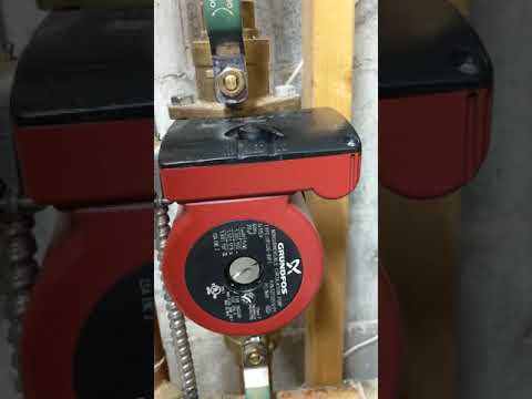

It's been a while since I last posted, mostly because my KHN199 has been quietly chugging along without issue. I recently had the boiler circ pump fail (left over Taco 0011-F4 from previous intallation so 12yrs old). Anyway, I had the heating tech install the circulator that Lochinvar apparently ships with their KHN199s for new installations. Grundfos UPS26-99FC. Boiler is back up and running, but now I'm wondering what speed to set the pump to? I'm going to attached two video's to show what I've got and whats going on. Probably easier than typing it all out, but I'll give the basics.
I'm guessing the Taco0011-F4 was over pumping because I never saw a delta-t higher than 5f, usually closer to 2f or 3f.
Boiler circulator loop is 12ft of 1.25" copper tubing with 5 90deg elbows (assuming 2 T's count as 90s), 2 45deg elbows and 2 ball valves.
With the Grundfos UPS26-99FC set to low speed and all 8 zones calling for heat, I'm seeing 18f of Delta T.
With largest zone and 2 farthest zones calling for heat, I get 5f-6f of Delta-T at the low speed setting.

That was my thinking, but I just wanted to get opinions from people who know more than me. I find that my primary source of confusion stems from the fact that after the pump was installed, it was left on high by the tech. Granted, he isn't very familiar with my system, but does maintain Lochinvar boilers.
I spent a bit of time looking at the Lochinvar installation manual but couldn't make sense of the pump graphs and tables.

You want as much delta as you can get so the boiler will condense. 18 deg on low speed is fine I would leave it as is0
That is what I've always read on here. Even on slow speed, It would seem I may have more tweaking to do because the 18 deg delta was with every zone calling for heat and that never happens. More typical is the 3 zone situation which is only 5-6 deg delta t.

You are piped primary secondary. To get best possible performance at the condensing boiler system flow should always be greater than boiler flow.0
Turning the knob will get you to a screen with cycles and run hours. This will give you an idea of cycle times0
You want to make sure you have a system sensor installed after the boiler water mixes with the system water. That way it can compensate if the boiler flow is lower than the system flow.
You can also limit the high fire so the Delta doesn't get to high .0 -

Personally, I would probably throttle the boiler ball valves a bit until the max delta is closer to 25-30F (or whatever the higher end of the range the manual allows for) with all your heating zones calling, and boiler at max fire/85%limit. That way your return will stay lower under part loads, since you won't be diluting it with hot recirc'd supply as much.

When throttling the ball valves on each side of the boiler pump, is one side better than the other or both at the same time?0 -
It's better for a pump to push into a restriction than pull thru one. So I would restrict the supply ball valve. Note that this won't improve the cycling since the BTU output is the same, but it will help part load efficiency.0

I've got the system sensor insulated and partially throttled the ball valve on the output side of the boiler circ. Throttled about 30deg on a 90deg valve. Haven't really noticed much difference in Delta-T though, maybe a degree or two. Going to leave it there for a couple days to see how it's working.
Boiler is modulating between %10 and %35 depending on what zones and/or how many zones it's supplying. Typically 1-2 zones but occasionally 3 zones. I haven't noticed it in standby or set point met since this morning, but I really haven't been paying attention. I'll let it run a few days and then compare cycles/run time with the picture above.0 -
With a ball valve it takes quite a bit to throttle. 50% flow reduction is not 1/2 the stroke of the handle travel.0
