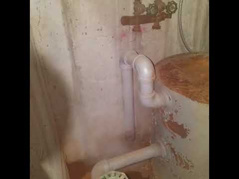

I assume more than 1 failed trap is causing this.
Double D
Double D Member Posts: 448
This is a Webster system with convectors in a 3 story Pre-K school.
https://youtu.be/qbppfaLFZlc
    Jamie Hall Member Posts: 26,328
    Be surprised what one failed trap will do -- but yeah, probably more than one.
  • Double D
    @Jamie Hall I'll be back to put a low pressure gauge on this one Monday. I dropped the pressure on the pressurtrol from 5 - 2psi on the scale. When the burner trips off, the 0-30 gauge is reading 6psi. I know you cant trust that gauge but could excessive pressure cause this? Is there a chance this system operated with a vacuum pump? The mains look rather small for the size of the building. Do you see a problem with me doing a load calculation and asking to have the boiler fire at that rate? I'm not well versed on this type of burner.
  • Double D
    edited January 2019
    More than 1 failed trap, still have more to hunt down but @Jamie Hall I am now surprised what one trap can do.

    Comparing this video to the system across the alleyway from me, I can’t imagine how many traps are bad.
