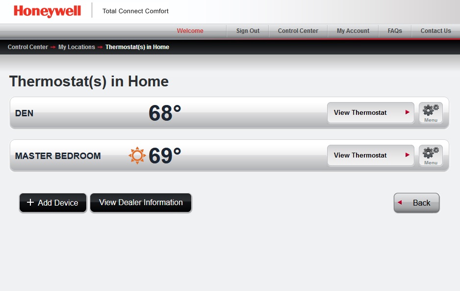

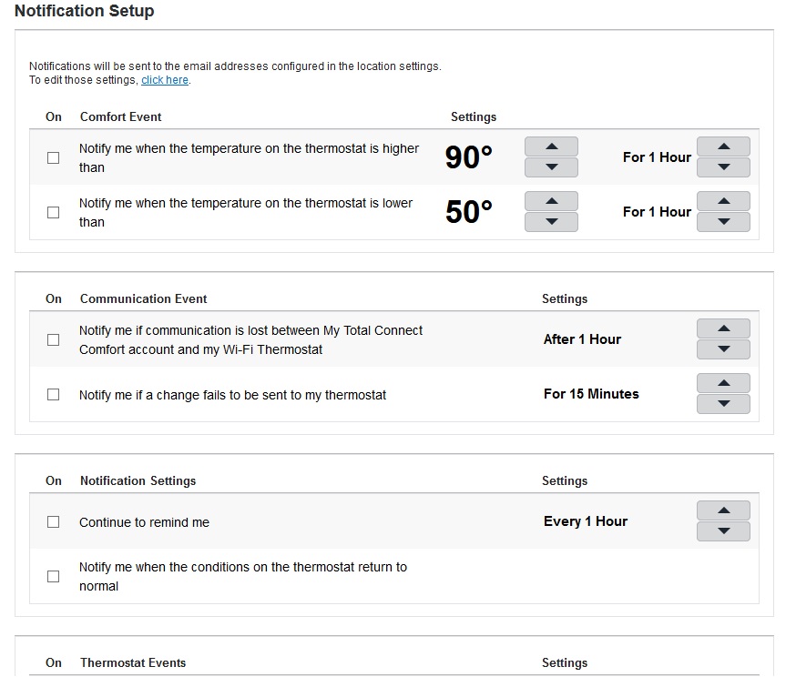

    Anybody recommend a WiFi stat for this application? I have kids who could leave the garage open and it will be nice to access the temperature from work and make changes or shut off as necessary.
    The current Honeywell 9000WiFi series should be adequate, it can be put on a schedule, monitored and overridden remotely via web browser on any PC or via app on any smartphone. It can also notify you if the room temp goes above or below certain presets.

    NY Rob, I looked up that stat and it looks awesome. But, may be overkill for the garage. It looks to be about $150, if I am looking at the right one. Any cheaper alternatives that you can recommend? Thanks.
  • NY_Rob
    NY_Rob Member Posts: 1,370
    The 6500 Series should work fine for you at about half the price of the 9000 Color series. It uses the same site and/or app as the other Honeywell t-stats for WiFi operations.
