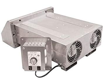

    Hello all, this conversation is going in many different directions, but I wanted to ask everyone their thoughts on this device. I installed one of these in my boiler room. I don't know the combustion air requirements of the devices but I figured any air exchange was better than none considering it is enclosed from the rest of the basement.
  • stefn
    stefn Member Posts: 25
    I’d love to know what it is and what it does. Can you explain?
  • Nysteamer
    Nysteamer Member Posts: 22
    Haha sorry guys, this is an air ex-changer. It gets ducted to the outside to pull air in and out. @ 180 cfm with both fans running.
