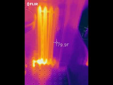

https://www.youtube.com/watch?v=rj7Y9RVyXGg
Sorry for the shaky quality of this video. "I" was the tripod pressed up over the toilet to get this shot. It is shot at one frame per second and played back for you at 25 frames per second, so what you are looking at is 12 minutes of compressed real time.
It seemed much longer!

    @Gordo, thanks for posting this.
    It is interesting to see that the radiator sections get hot from the top down (beginning at about 8 seconds). Who says heat rises?
    I have the same type of radiators and have noticed the same thing. I think I know why.

    Hot fluids rise, steam is just another fluid.

    True, so wouldn't you expect the bottom of each section to heat up first?
  • We're looking at the outside surface, not the inside volume.
    We can't see the steam (and its heat) rise, inside. We can only see where the steam's condensed, and released its heat to the radiator, outside.
    Inside, the top will be hotter than the bottom, because steam rises, so of course the outside heats up, top-first.
    I thought it was neat the way the last section broke pattern, because of the vent...

    @brooklynfrenchie, I think you can see where the steam is going in the video. It is the where you see white, just as in @Gordo's other videos.
    And I think the reason you see the radiator heating from the top is that the steam is traveling down from the top--in the column closest to the camera. (If you watch to the end, you'll see the last section heating from both the top and bottom.)
    In my three-column radiators, the center column heats up first, from the bottom, and the outside columns (or at least the one facing the room) heats from the top as shown in the video.
    Seems to me the steam is going up through the center column and down through the outside ones, since they are connected at the top.

    No. The bottom heats as the steam passes but it all wants to go up because of the difference in the density. Once it hits the top of the rad it starts to really give the heat where it's stopped moving and begins to fill the rad. I'd love to see a glass radiator in action. The closest I've seen is the glass coil condensers where I work. There were large glass tube and shell but we got rid of them years ago
