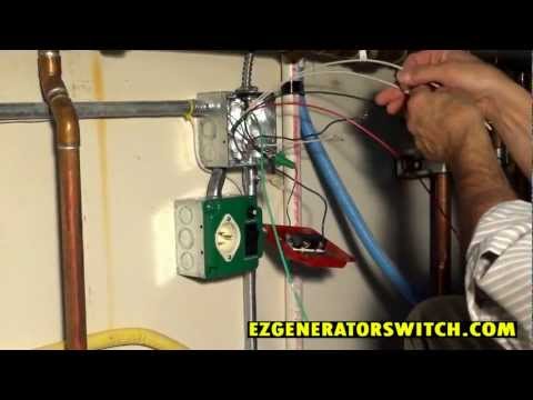

There have been a few discussions about the addition of a plug and cord to a boiler (or furnace) to allow for easy connection to emergency power (generator or battery/inverter). There was much worry about safety, and of course, code compliance. This is what I did (see photo):
Single oulet dedicated 15 A circuit.
14/3 SJOW cord about 2 ft long.
Kept service switch and MC cable pigtail to boiler.
I think that is a practical solution. I don't think anyone had a safety concern with that approach. I just doesn't happen to meet electrical code."If you can't explain it simply, you don't understand it well enough"

I do this w/ pretty much all my gas wall hung units.
The primary reason I do it is to install a surge suppressor in-line to give a measure of protection to the PCB and electronics.0 -
That would also work for people who plug their boilers (mod-cons) into a UPS. Plug the male connector into the UPS Battery/Surge outlet and you still have the ability to power down the boiler via the Emergency cutoff switch.0
kcopp--I have install many whole house surge protectors and surge capacitors, but, on mod/cons, regardless of a whole house surge protector, I always use a computer grade surge protector and power everything off of that. That means zone control boxes, too.
As I recall, the NEC requires a disconnect and a plug and cord qualifies as well as a breaker in a panel in sight of the appliance.
The switch is just more convenient.0 -
IIRC the Code also requires permanent equipment to be permanently connected, so not supposed to be cord and plug connected. The AHJ will tell you the correct interpretation for your area.
Also, a lockable breaker lockout is a Code acceptable means of disconnect, but not for refrigeration equipment, which must still be within sight.
