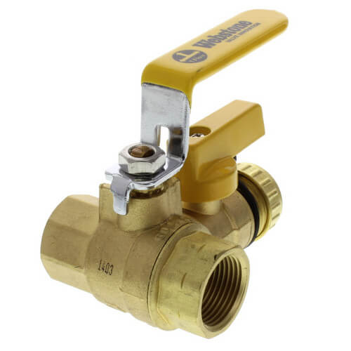

This is a shutoff/isolation valve with drain....mbarnstein said:@NY_Rob he did install valves. all are running fine, no air, just water coming out.
You put one at the beginning of the loop and one at the end of the loop. Makes isolating/draining/filling/purging zones super simple.
https://s3.amazonaws.com/s3.supplyhouse.com/images/products/zoom/40613-3.jpg
Right now you have standard valves that will shut off flow... but that's about it, no way to drain, fill or purge with those valves. There's also no way to see if your zone is frozen with your current valves. With the valve shown above, just unscrew the cap and crack the small lever a bit.. if water gushes out... you're not frozen. Takes 2 seconds with the correct valves.
