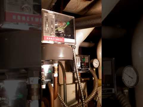

    Steamhead Member Posts: 18,510
    Now that you're able to get rid of the air, you can probably down-fire that boiler to more closely match your radiation. What burner is on it?
    If that's the version that has an air damper operated by a crank-arm setup from the main gas valve actuator, it should be possible to convert it to lo-hi-lo operation. This way, a second Vaporstat would drop the firing rate as pressure starts to build, so the boiler would run at a lower input rather than shutting off and wasting heat during the required purge periods.
    The actuator on yours should have a model number V4055-something. correct?
    Here's a job where we set it up lo-hi-lo when we installed it:

  • Gordo
    Gordo Member Posts: 857
    For your viewing enjoyment, a short video of lo-hi-lo in action.

  • zoom
    zoom Member Posts: 73
    Thanks everyone for the feedback. The burner is operated by a crank-arm configuration that opens something when the burner fires up. If the actuator is the big block looking thing that is inline with the gas connection, and to which the crank-arm is attached, then it is a Honeywell V0455A-1064.
    How involved is the conversion to lo-hi-lo?
    Does it add significant complexity that can later go wrong?
    How much does this alleviate the short cycling on a very over sized boiler?
    I think that this is something to attempt when the heating season comes to a close, and finding a qualified individual in Western MA might be a challenge. But definitely something to explore.
    Not something to do when it's 3 below out, however sunny it may be.
    You need to change the actuator to a V4062A- something. Call PowerFlame tech support, give them the model, serial and invoice numbers off the burner, tell them you want to switch it to lo-hi-lo and they will tell you what to use. That's what we did at Calvert Court.
    Finding a qualified individual in western MA, though, is easy. Try Charles Garrity ( @Charlie from wmass ).
