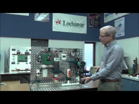

For those who don't understand why pumping away from the expansion tank is important, here is a video showing exactly what the difference is. Thanks to Dave Holdorf of Taco for providing me with the link. Enjoy, and feel free to comment.
https://www.youtube.com/watch?v=tZRuqiQkukE&app=desktop
ME

    What Bill DIDN'T demonstrate, is how the auto air vent acts as a vacuum relief, and actually introduces excess air into the system. He does not that the pressure at the point is sub atmospheric, but doesn't open the vent. "It's just a pressure differential machine, and it doesn't care if it creates positive pressure or negative pressure"

    Microbubble resorber demo...
    https://www.youtube.com/watch?v=W2ZxR7MM3Y0

    Thank you Mark for posting that great demo. I would also like to see a demonstration with primary secondary and how the closely spaced tees also act as a point of no pressure change ? Am I correct in that? Would it act the same way?

    Mark Thanks for posting That was one of the best visual lessons I have seen.

    Icy, the closely spaced tees are not a PONMIPC per se. Their function is to keep two pumps from "seeing" each other and having influence on each other, when you don't want or need it.
    But do know, that ALL pump MUST pump away from the PONMIPC if they are expected to produce positive pressure changes. So if the expansion tank is on the load distribution loop, then the boiler pump MUST pump away from the common connection to that loop in order to produce all positive pressure.

    Great video! Visually it is good to see the proof of what we understand.
    We get a lot of homeowners here who will think they all have to immediately change there expansion tanks from pumping toward to pumping away. is the change better? Yes. should it be done during a boiler change or repiping? Yes
    Does it mean every old installation is wrong or won't work properly? No.
    Depends on the system pressure drop
