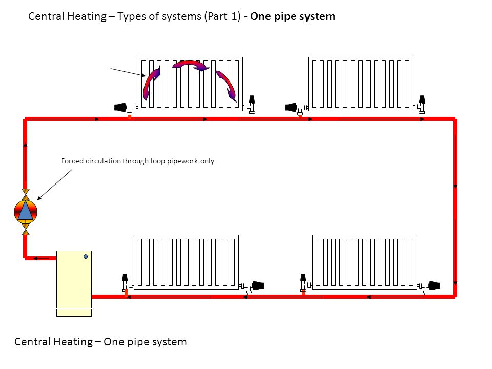

    The system looks like a “1 pipe” system. Not a reverse return 2 pipe. The main line has the break off line for each baseboard which connects back to the same main line after the baseboard. Seems like each room t’s off of the main circuit line.

    Lou, is this how you believe your current system is set up?

    If you do indeed have the system in the above diagram... that's great because as Ed mentioned above... just install Thermostatic Radiator Valves in the bedrooms and you're done! No need to repipe or install zone valves, etc...

    NYRob,Yes, my system does indeed look identical to the diagram, utilizing baseboards though, that diagram is of radiators it seems. I know it doesn’t matter. Also, there is a longer feed line going from the main pipe to the bb. Not that that matters either. But its identical to that.
