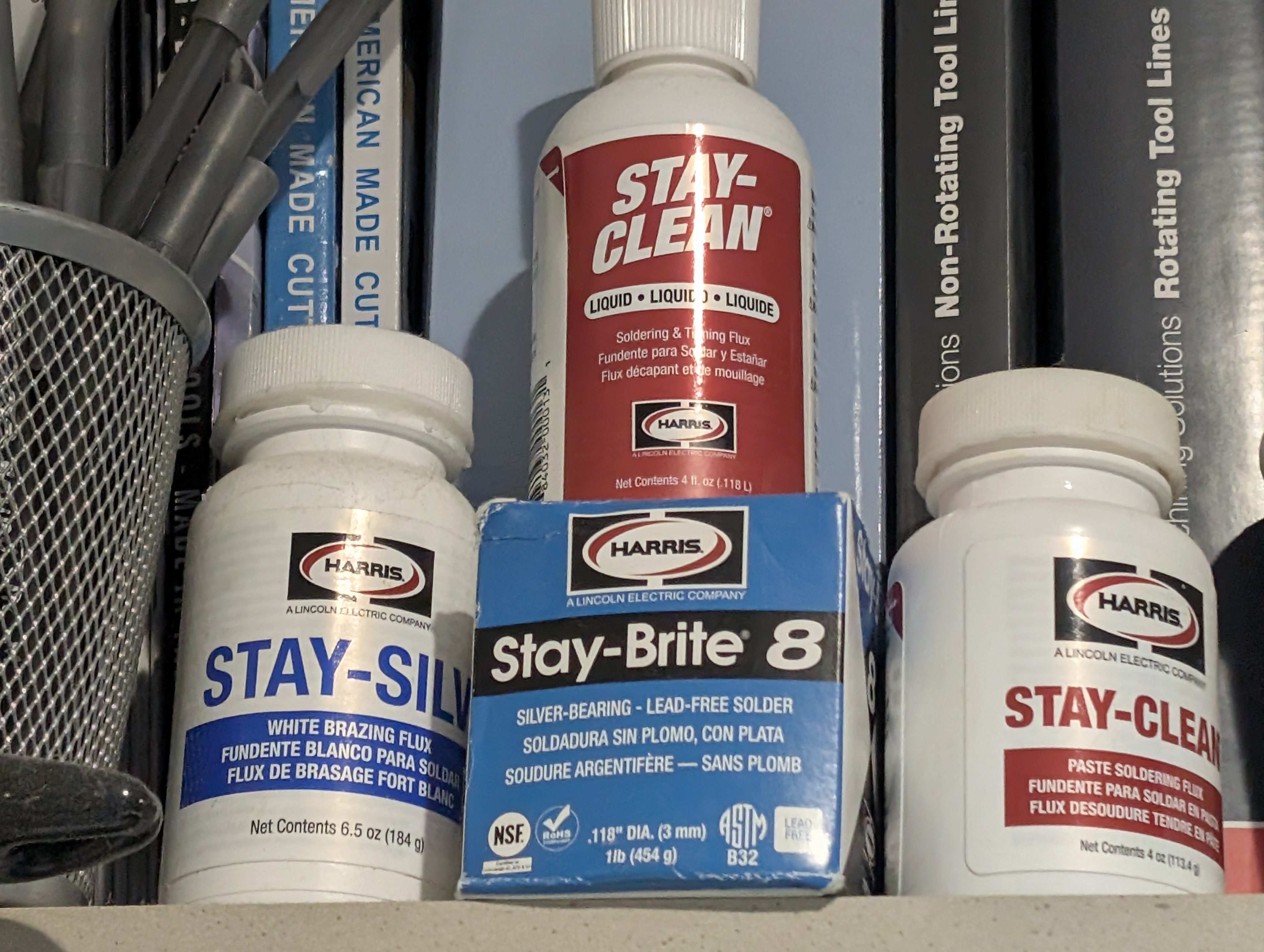

    I was very close to using it, but the flux, and having to clean every connection is what stopped me.
    Dang it @Kaos this thread's a bit old………and stale.

    Been using SB 8 for 40 years. No issues, easy component changes.

    Wow, @pecmsg , I thought I was the only "weirdo" who does SB8 on most ref joints! I am not quite at 40 yrs yet tho! The beauty is you do not have to flow nitrogen and less heat around components. And yes, I do compressors with it too. A Harris rep once said, "If I could only carry one Solder/flux product on a work van it would be SB 8". I do not recall ever having a joint break due to vibration/movement except for one outdoor unit that got slammed with something, and in that case the Brazed joint/fittings may have failed also. SB-8 gives a stronger overall joint because the copper is not softened with high heat.

    I use Stay Brite 8 on my linesets as well. I was taught the same thing as @pecmsg, flux the pole not the hole. I never had any problems with Stay Brite, it's a great product. Quick, easy and much less chance of burning anything.
    I wouldn't use it on a replacement compressor. I have seen a leak develop on the connection to the discharge line once. I believe the condenser fan motor failed and the compressor continued to try to run, the heat of the discharge line and vibration caused the solder joint to fail.

    Do you guys do the same when fluxing water pipe for soft soldering?
    I personally have absolutely no doubt SB8 8s plenty strong.
    The flux was my main concern.
    The next would be cleaning all of the joints and dust getting into things.
    Sitting above my desk as we speak
    pecmsg Member Posts: 7,442
    edited October 2025
    I treat it like soft solder.
    If you flux the hole when you insert the pole it pushes the flux into the pipe itself and away from the joint. By fluxing the pole only all the excess is on the outside of the pipe, easily wiped off if needed.
    and yes, I've used Nokorode flux in emergencies.

    Paste
    Liquid is too messy

    I used to only flux the pipe but I went to fluxing pipe and fitting but with less flux overall than when I only did the pipe. Especially with ACR piping, I basically just wet the pipe & fitting with the paste. To do so you must have it warm enough and NOT have gobs on the brush. When lead free brass plumbing fittings came around I found it difficult, so I tried other fluxes, having used nokorode for years. I finally settled on Nokorode tinning flux which worked much better.
