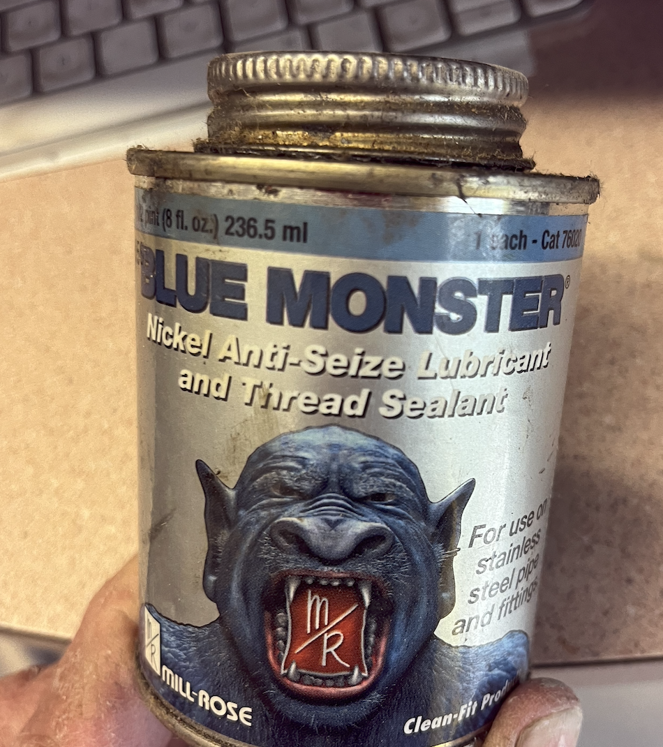

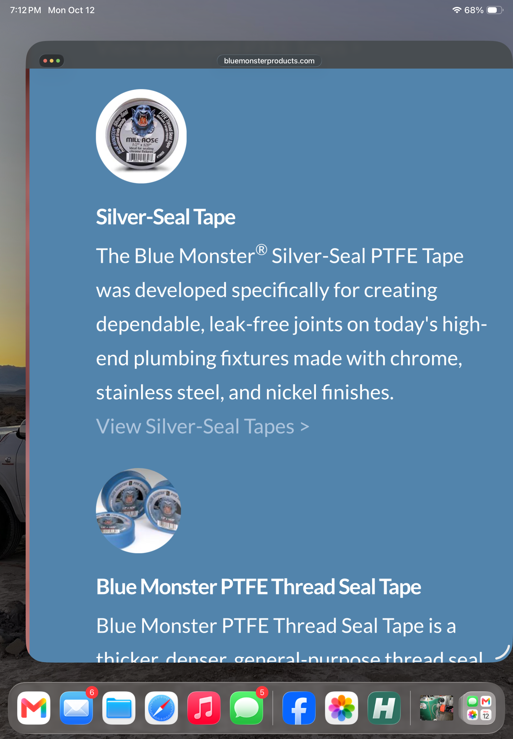

    Blue Monster has a special tape and they had a grey colored pipe dope for stainless.

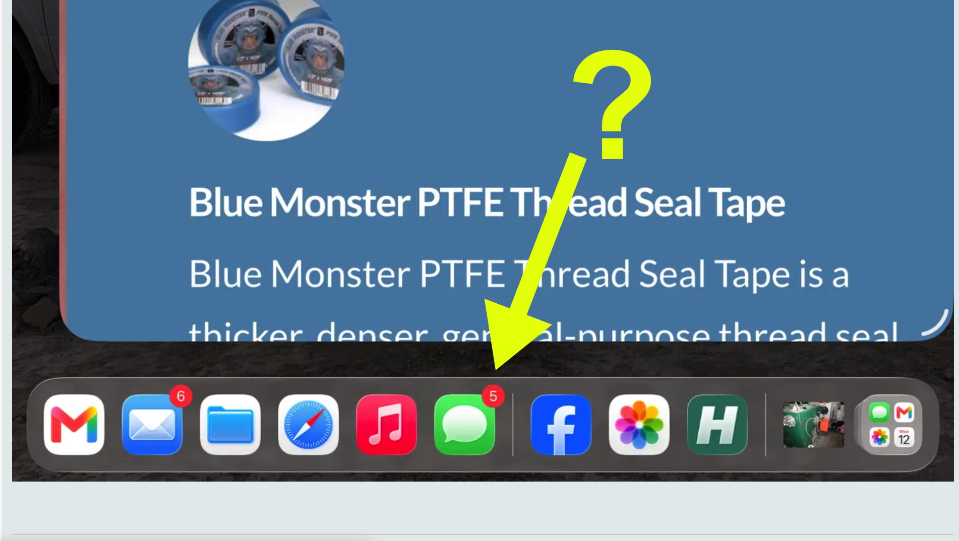

    @hot_rod Is one of those 5 messages the one from me you never answer?

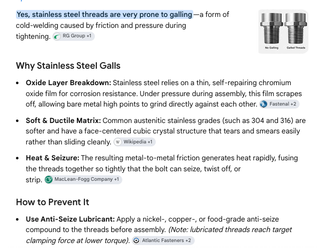

  • stainless will gall quite badly with itself which is why for SS to SS its good to use the special tapes meant for it. It generally behaves better with other metals and galling is less of a concern there.

    Actually the stainless nut and bolts on solar collector mounts do often sieze of gall when you try to remove them. The damage is probably during the tightening process.
    I think all stainless threads are prone to galling. More so if you overtighten them and distort the threads. I would put chap stick on the threads of stainless nuts and bolts on solar mounts. Maybe make it easy on the next guy or gal?

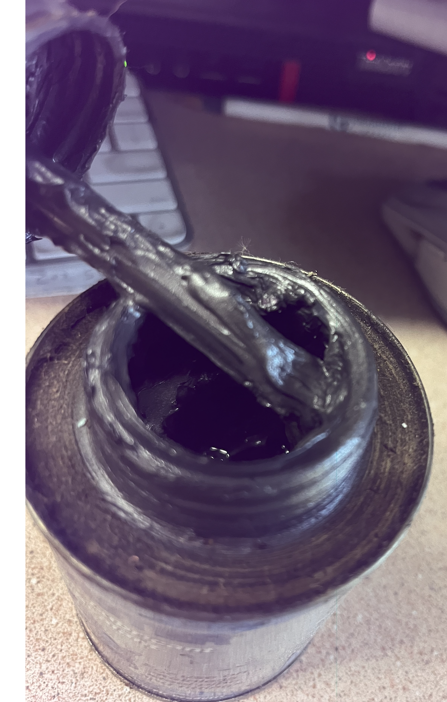

    Here is what I use on stainless pipe threads. Probably work on nuts and bolts, but it is extremely hard to wash off your hands

    Though, I had no idea blue monster made anti seize.
