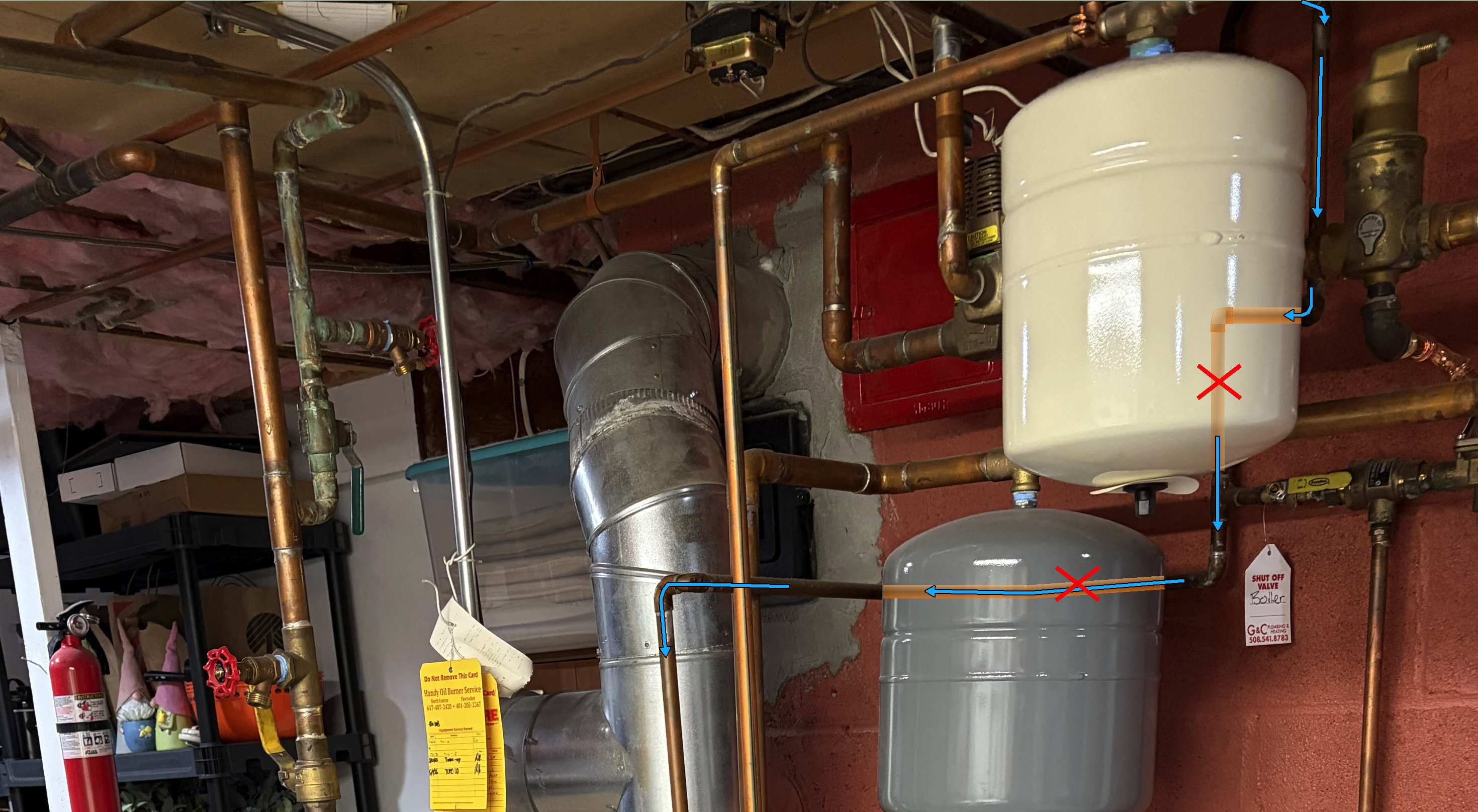

Something happened to my original post - I'm trying to recreate it now…
About 3 months ago, we had the domestic water mixing valve swapped out by a plumber in an effort to obtain more consistent hot water in our 2nd floor shower. This was after I had already changed the local Kohler mixing valve in the shower to little or no affect.
The new valve did make a big difference and I consider that issue solved.
About 6-8 weeks ago, I started noticing water in the left-side mason jar on the floor under the relief valve pipe. This is the first time I've seen water in it in the 5 years I owned the house. When I bought the house in 2021, the mason jars were there, but up until this time, they were bone dry.
Now I'm seeing water in the left-side jar that will fill it roughly every 10-14 days. I don't think it started immediately after the mixing valve swap because I would have connected the two and immediately called the plumber back to look at it. It's definitely some time after that.
I put these facts and pictures through AI which said it is caused by 1) sediment stuck in the automatic relief valve, or 2) A failing expansion tank, or 3) an internal tankless coil leak.
However, I don't trust AI so that's why I'm posting here.
Is this pressure relief issue related to the mixing valve swap, coincidental, or no way to know?
If I call the plumber/heating company back in, what am I expecting them to do?
I'm wary about calling them because they are costly, and they tend to recommend expensive options.
I have a different small(er) business that services the boiler annually that I probably trust more.
I just want it back to the way it was 3 months.
Any advice would be welcome as well as what level of urgency there is in fixing the issue?

    I assume it's the boiler relief thats leaking. I see the gauge is at about 30psi. That's the opening pressure of that relief valve. So it looks like the gauge is doing it's job. Could it still be faulty? Yes. but let assume is ok for now. You can drain some pressure off of the boiler, close the make up water valve and see if the pressure goes back up to 30. If it does you'll want to check the expansion tank.

    There should be a pressure regulating device somewhere. It's not in the picture you posted. If you step back and post another picture with all of the boiler piping someone will liky point out the feed water valve. Could be up near the expansion tank and will be before the pressure regulating device.

    Three reasons for the relief valve to discharge
    1. Defective valve
    2. Boiler presure is at or above relief valve setpoint (valve is working properly)
    3. Debris is lodged in the valve seat and not closing 100% (may be easy to fix or may be defective). You need to pop the handle to see if you can clear the debris.
    Since you pressure gauge is reading close to 30 PSI, I believe your valve is operating as it is supposed to. That being the case you need to find out why the boiler pressure is going to 30 PSI when a normal boiler operating pressure, like your Weil McLain WTGO, would be 12 to 18 PSI.
    There are three reasons your pressure may be going to 30 PSI and the relief valve is discharging.
    1. The automatic feed valve is defective or set at the wrong pressure. this will allow more water pressure from the household water system to increase the boiler pressure above normal
    2. The expansion tank is defective or improperly charged with the wrong amount of air pressure. (That is is covered in the class on expansion tanks that you didn't pay for yet)
    3. The tankless coil has a leak that is allowing household water pressure to leak past the coil into the boiler. that will cause the boiler pressure to increase above the normal operating pressure.
    Class dismissed

    As others have said there are a few things that can cause over pressure. So someone has to troubleshoot this.
    That could be you or your plumber. The plumber has to charge $$$ so the smart thing would be for you to eliminate some of the possibilities to keep the plumbers troubleshooting time down.
    Could be"
    PRV (pressure regulator) feeding boiler is leaking by
    Expansion tank could be bad
    Tankless coil leaking into boiler water
    Bad pressure gauge or relief valve
    As others have mentioned since you gauge reads 30 psi and the relief valve opens at 30 psi that PROBABLY eliminates those items as an issue….note probably.
    1. Eliminate the boiler prv. Close the valve in the feed water line to the boiler. It's on the back wall with a tag labeled boiler on it. Then drain some water from the boiler slowly to get the pressure from 30psi down to 15psi. Then close the drain. Leave the boiler in normal operation. Check the pressure once in a while. The pressure may go up and down as the boiler heats and cools but should stay in a safe range 10-25psi. If it goes back to 30 and starts dripping that means the feed valve PRV is ok and there is another issue. If it doesn't rise to 30 the PRV IS the issue and it needs to be replaced or cleaned.
    2. Eliminate the tankless coil. Let the boiler run as normal. Drain down to 15 psi but keep the boiler feed water valve open. I don't see any valves to isolate the tankless coil so thes may need to be installed to eliminate the coil.
    3. Have them check the expansion tank air side pressure. They have to remove the tank from the system to do this. Probably involves draining the system.
    If I had to guess #3 would be most likely followed by #1 and then #2
    in that order.

    The first test to see if the auto feed valve is passing is to closed the valve that has the tag "SHUT OFF VALVE Boiler" as suggested by @EBEBRATT-Ed
    The second test is to shup off the cold water to the tankless coil and to do that you need to turn off a valve that feeds the hot water coil. as @EBEBRATT-Ed mentioned that valve is not in any of the pictures you have posted but it may be behind one of the expansion tanks as shown in this illustration where the red X is indicating a valve might be located.
    look for a valve that will turn off the cold water inlet indicated by the blue arrows on the cold water pipe to the tankless coil water heater.

    The tridicator gauge is reading 12/13 psi. You guys are looking at altitude.
    And the aquastat is reading 187°, so it doesn't seem pressure related.
    @digger5150 , you could try to pop the lever on the relief valve. It's a crap shoot. It might reseat. It might get worse. If you try, put a bucket under the discharge pipe. A relief valve is what we call a "wear part". It has a limited life expectancy. And maybe swap the mason jar for the bucket. If the relief valve ever does blow on pressure (30 psi), a glass jar for the target isn't a good idea.
    The tridicator could also be giving a false reading. Its best to have a pro check it.

    I would have, and I made that same mistake reading the gauge. OK, so the normal pressure is 12-13 psi, as one would want it to be. The gauge could be faulty, though that seems unlikely.
    I did the manual flush, 3 times for about 2 seconds each time. The first one, it was black as night with a fair bit of sand-like debris. The second time was clear, but still some bits in it. The third time it was clear and no debris.
    It is now dripping consistently - to the point of a full mason jar's volume every 2 hours.
    My oil boiler servicer is coming tomorrow. I was told on the phone it is either the relief valve, the expansion tank or both…matching what you all have said.

    Take a small screwdriver and move the red indicator dial on the tridicator to 15 psi. Tomorrow morning check to see if the pressure dial moved it. If it didn't budge, I'd say it's a bad relief valve only.

    Thanks everyone for all of your input and guidance! In the end, it was both the relief valve and the expansion tank. When the tech first arrived, he thought it was only the relief valve because the expansion tank sounded hollow. But, that turned out to be a false positive.
