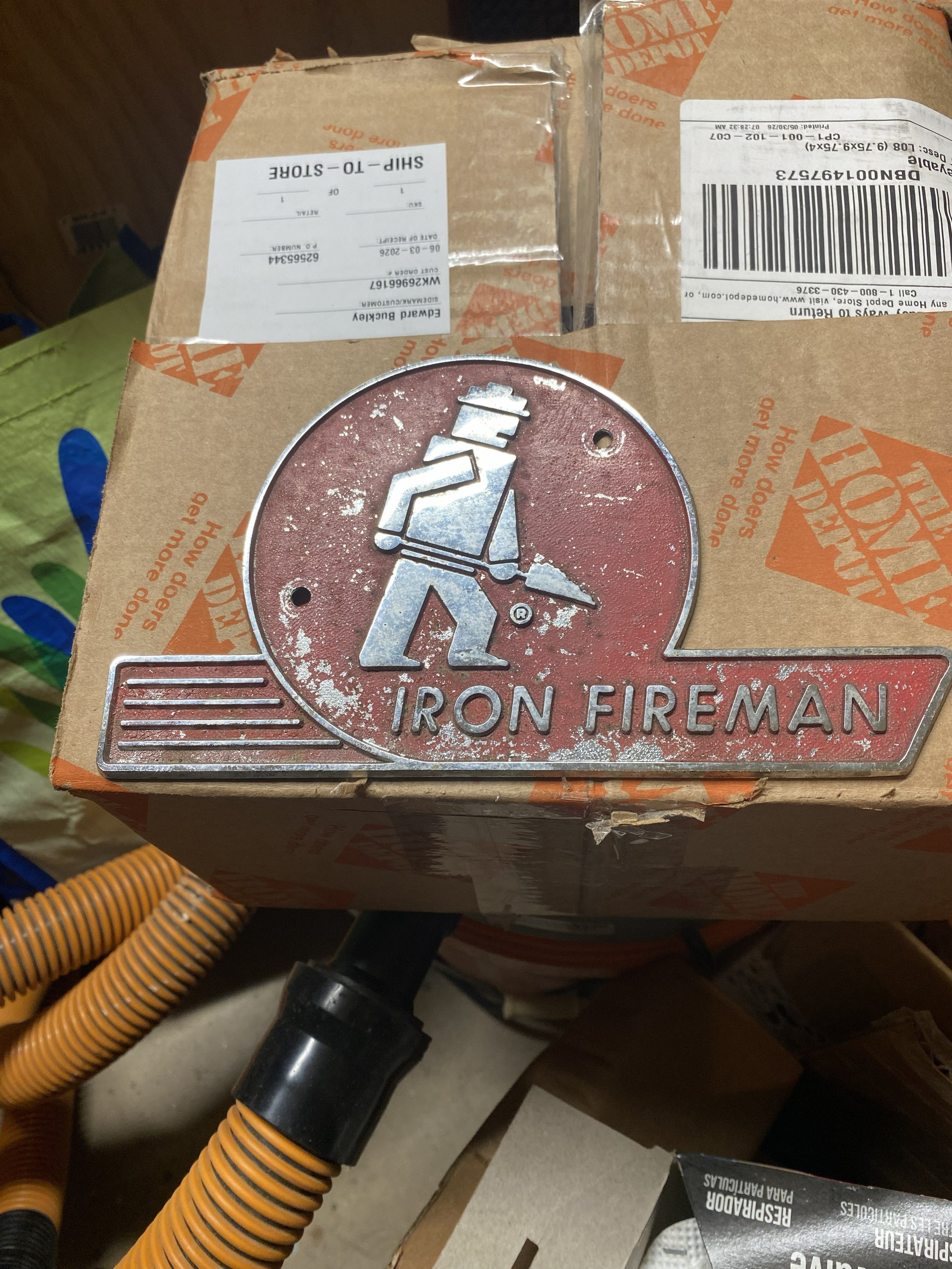

    I have had this since my Iron Fireman burner days. Stripped it off a burner that was going to the scrap. Now it is screwed to some shelves in my truck.
    First factory burner school I went to (and I think my first ever airplane ride !!!!) Allegheny Airlines from Hartford to Staunton, VA then a puddle jumper from Staunton to Harrisonburg.
    Those were the days!!
    Can't believe it's been 52 years
