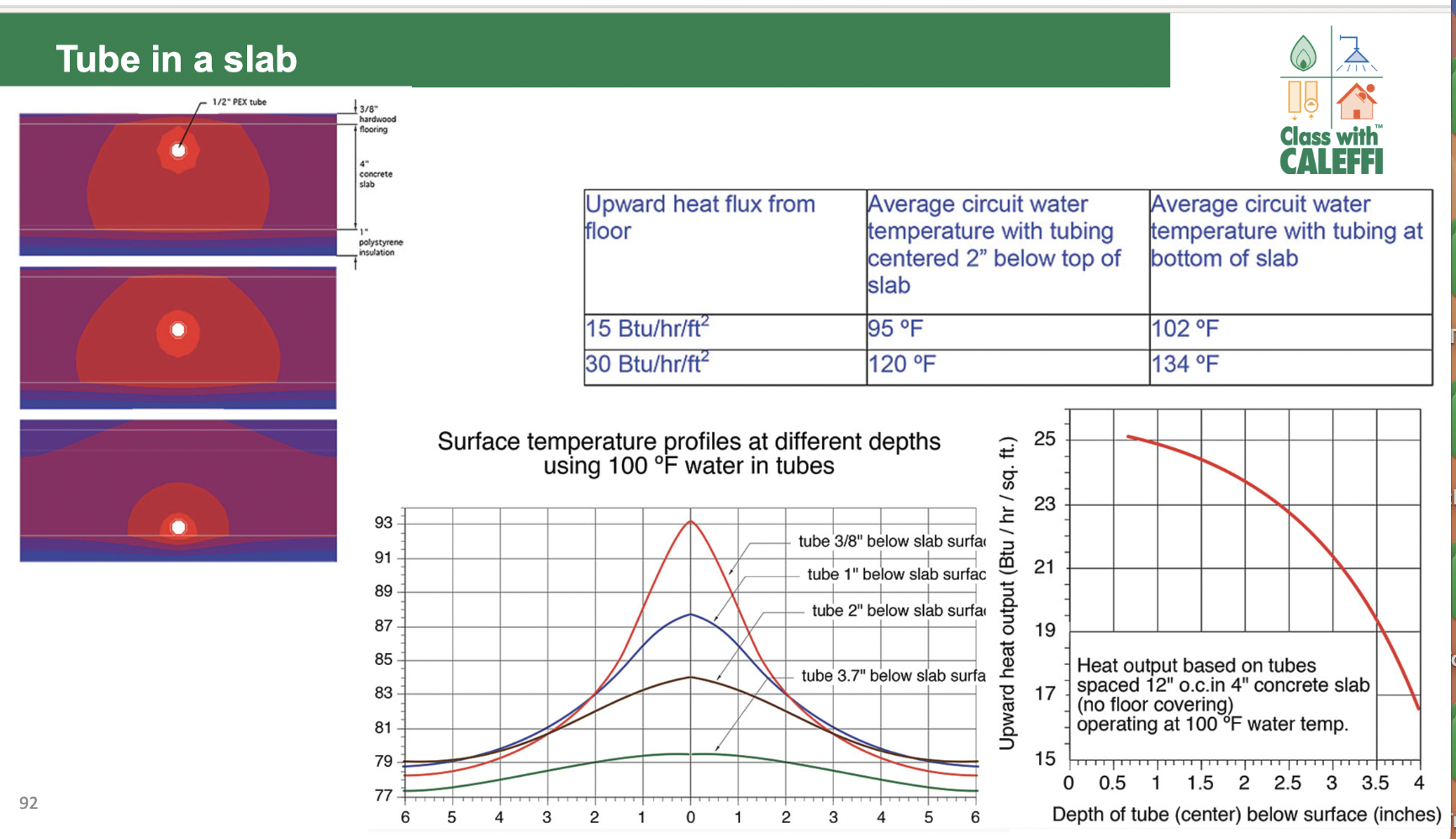

    hot_rod Member Posts: 27,855
    This was modeled for a 4" slab, 12" on center. Snowmelt should be 8-9" with 5/8 min, better yet 3/4 tube.
    The lower the tube in the slab the higher the downward loss and slower the response on start up.
    The sand and paver would need to be added to this model also.
    Sand is not a great conductor of heat, pavers are, they are denser than concrete as they are formed under pressure.
    I would look at the SIM design manuals from Uponor, Rehau, Viega, atc. They should all be online. Get up to speed on a proper design before you start the project or get bids.
    Use a regular concrete mix, the stone (aggregate) is what gives comcrete its strength. A sand mix would not be ideal for a driveway.
    Usually concrete is mixed with a 5/8- 3/4 aggregate over the tube, so with 3/4 you usually see 2-2.25" of concrete required over the tube.
    Holding the tube up into the pour is easier said than done. Without "chairs every 18" the mesh or rebar will droop down during the pour.
