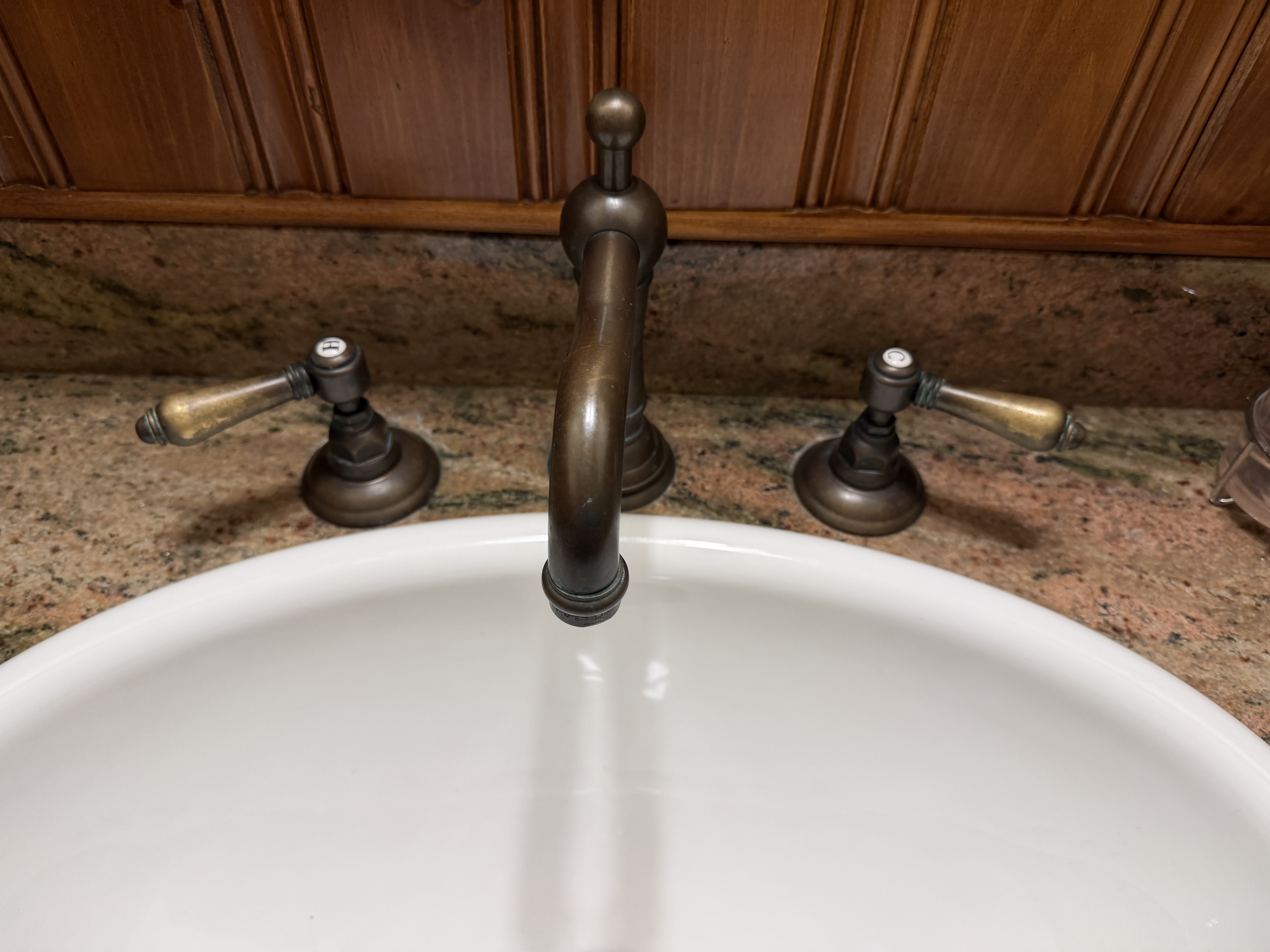

Greetings,
Any of the plumbers here know who the manufacturer/model of this bathroom faucet might be?
I’d like to find a parts diagram for it.
Thanks.

sound like it was the home depot special.
the cartridge will tell you who made it or who they knocked off.
in the small engine world there is a whole universe of chinese clones of honda engines, many of which use interchangeable parts, some of which have some proprietary parts to that particular manufacturer that may not have distribution in the us.

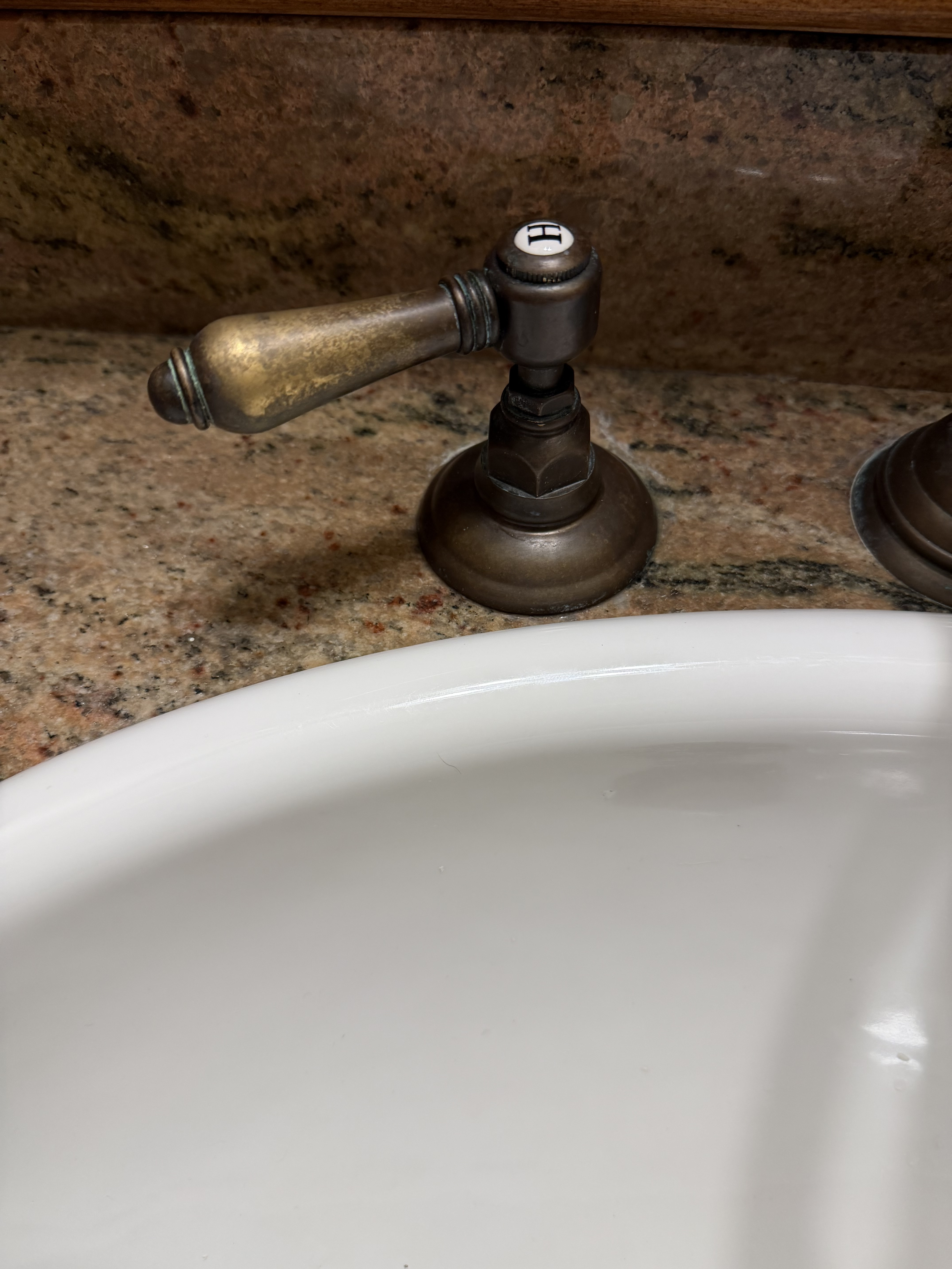

is the faucet in question washerless or compression? it kind of looks like it is compression.
pulling the cartridge may help you match it up.
pulling the handle and looking at the pattern of the broach is likely to pinpoint the manufacturer
virtually all major manufacturers will put their name on the spout somewhere unless it wore off.

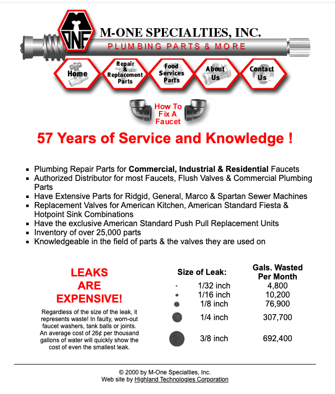

This is a company I worked with. Rarely would they not be able to identify any faucet if you had the stem or a picture. Many "designer" brands used the internals from well know brands like Price Pfister, etc.
There are little repair parts shops like this in many areas.

unless it is something that was designed after this catalog was written this catalog will get you there

Maybe Phylrich.
The cartridge will tell you.
Years ago, faucets were easily identified because the manufacturer would put their name on it somewhere, so it could be identified. This is no longer the case. However, the stem or cartridge inside the faucet might have a name. So, take it apart. Hopefully, it will show a name or a number there.

they used seats and springs for the better part of a century. in the 2 handles the seat rode on a stainless plate, in the single handle it could be a stainless, brass, or plastic ball depending on the model. the balls are interchangeable so you can put in the stainess ball if you have the plastic one and don't like it.
@Alan (California Radiant) Forbes I took one apart yesterday. It said "Nicolazzi" on the stem cartridges. They are out of business and were bought out by "Rohl?" If I'm not mistaken.
T&S Brass has their model numbers on their parts and, in many cases, its brand name too.

@Karl Reynolds Thanks for the help. I think you are correct.
Thanks to all for the many suggestions.
The handles and letters look like something I recently purchased from Kingston Brass in California. I purchased chrome but they have many finishes.
