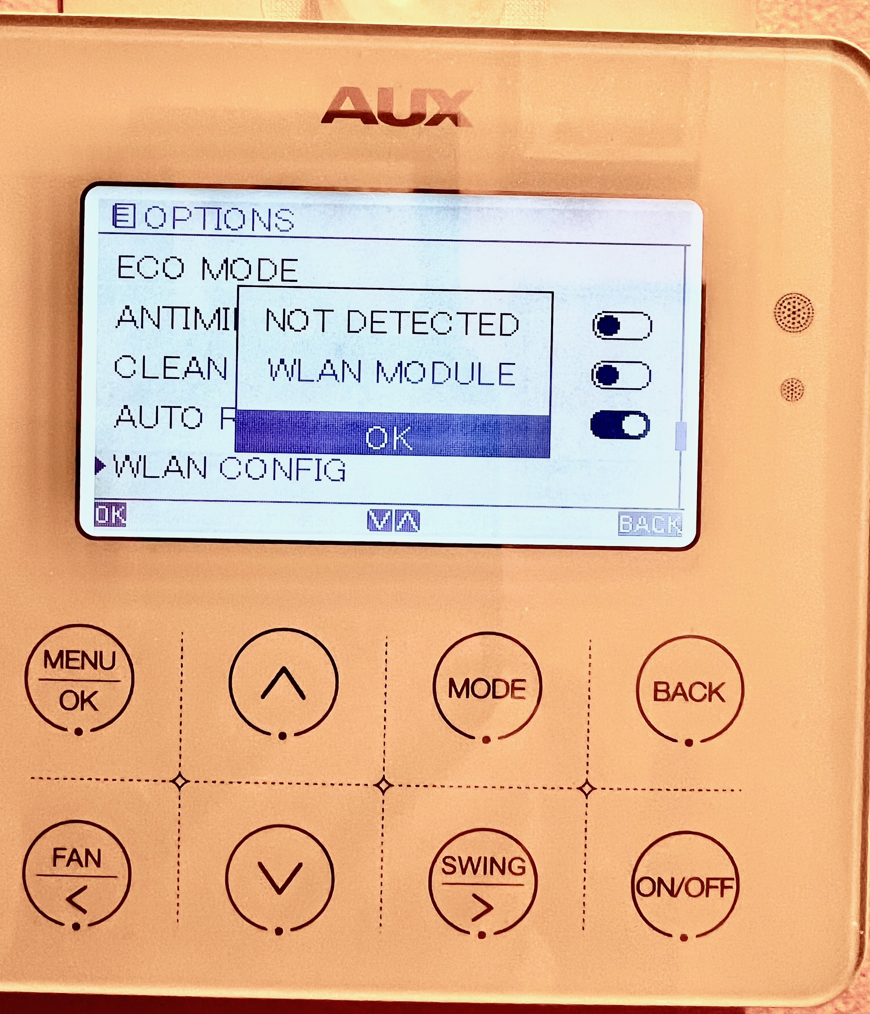

Anyone have experience with the AUX R32 AC / Heat Pump system? Although I'm not sure I prefer the heat pump over the old baseboard heat, it seems to work properly. When the thermostat detects the ambient temperature reaches the desired target the system and fan both turn off as expected when thermostat has fan set to AUTO mode. However, this is not the case when in cooling mode, the fan remains on all the time even though the compressor does stop (the air is noticeably less cold). The HVAC company insists the thermostat is the problem and they say they will replace it. They already agreed to replaceme since the unit was supposed to support WiFi but it does not. The user interface on the unit is awful and I was hoping the app, which requires WiFi, would be easier to use. Should I expect the thermostat to fix the fan issue or is there some other issue with the setup?
    System and thermostat are all AUX. Top image is from the 'manual'.
    How the system behaves . . .
    MODE : HEAT, FAN : AUTO - Fan is on when heat is needed and stops within a minute when not needed.
    MODE : COOL, FAN : AUTO - Fan is on when cooling is needed and NEVER stops when not needed, it is on as long as the system is on.
    Was not thrilled about a system from China but the price was significantly lower. Not sure what a rating plate is.

    So, the HVAC guy came and swapped the AUX thermostat w/o WiFi for an AUX thermostat with WiFi. I can now control it from my phone. However, it appears that the fan still remains in cooling (or humidify) mode. It turns out this is done by AUX on purpose (he contacted them). They feel that the air should circulate all the time (unless you are heating). I don't understand this but the HVAC guy offered to replace it with a Honeywell (T10?) thermostat which will behave more like the previous when cooling, plus support the heat pump.
