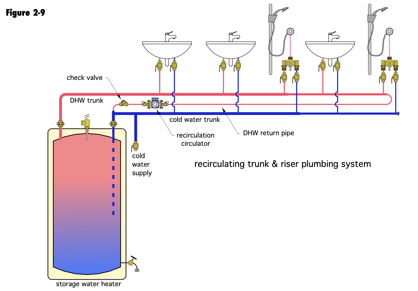

    Dedicated recirc line needs a check valve in it otherwise you can have cold water from the bottom of the tank flow backwards through the recirc line to the hot water of the fixture. Since your pump doesn't have one, you need to install an in-line one like that Sharkbite I sent earlier.

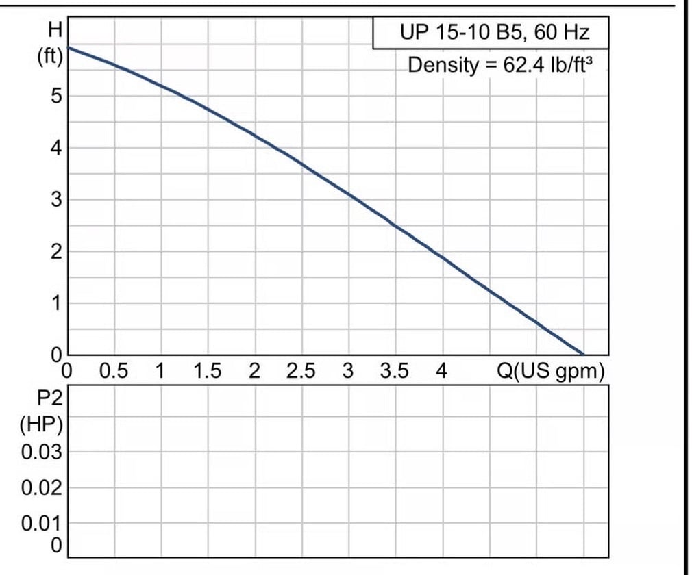

    The pump doesn't know or care that it has a bypass valve in the system or not. It just circulates the water and needs to be sized to the pressure drop and flow of the piping. That pump, based on your piping description should be fine. It just needs to flow a small amount to overcome the heat loss in the piping.

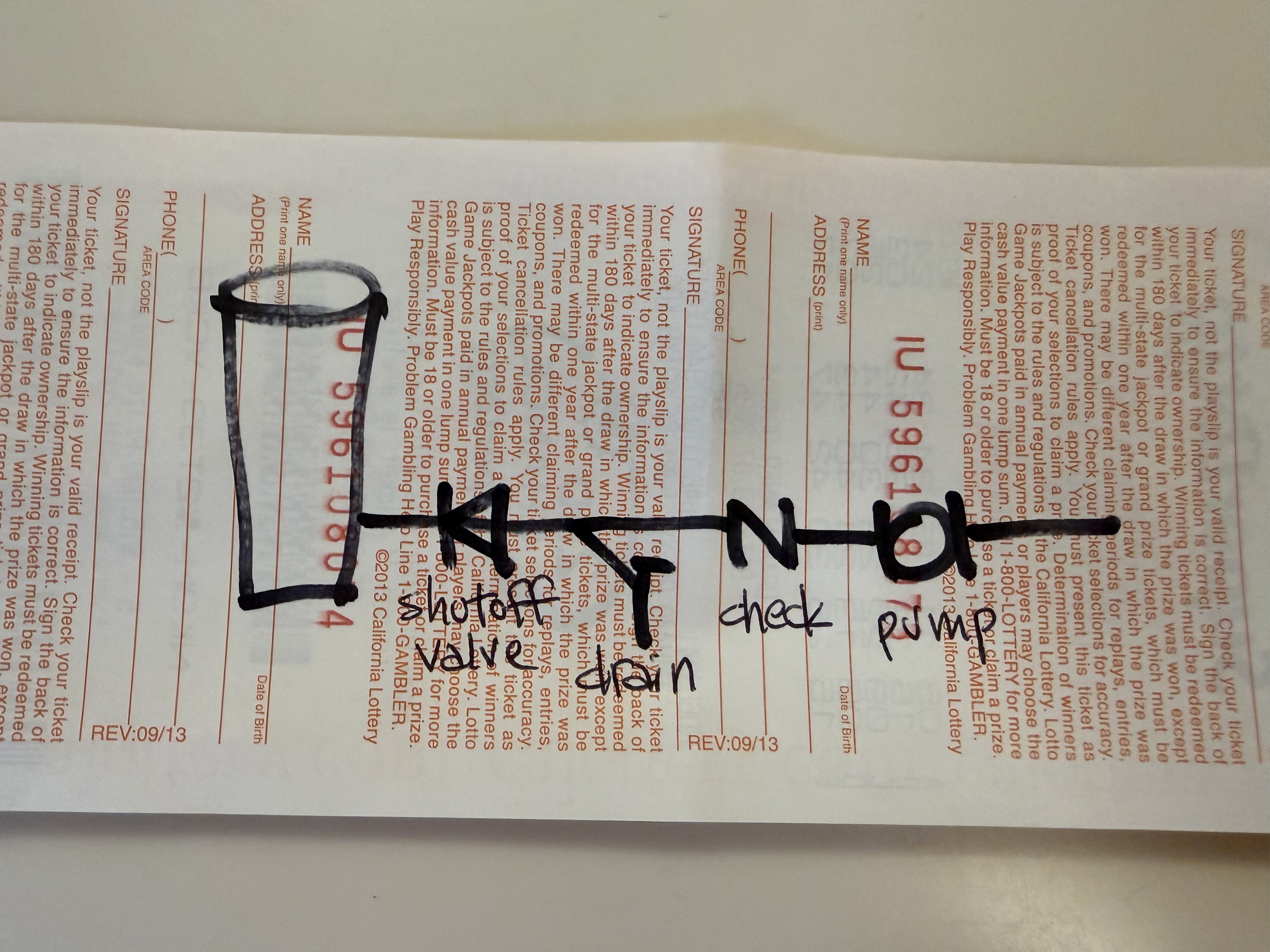

    Maybe even add another shutoff valve before the pump in case the pump needs to be serviced.

    Hi, I'm not seeing a drain at the bottom of the tank, just a drop ear 90. 🤔 You really want a drain there. It would be even better to have a shut off at the tank first as this would allow you to flush air from the recirc line.
