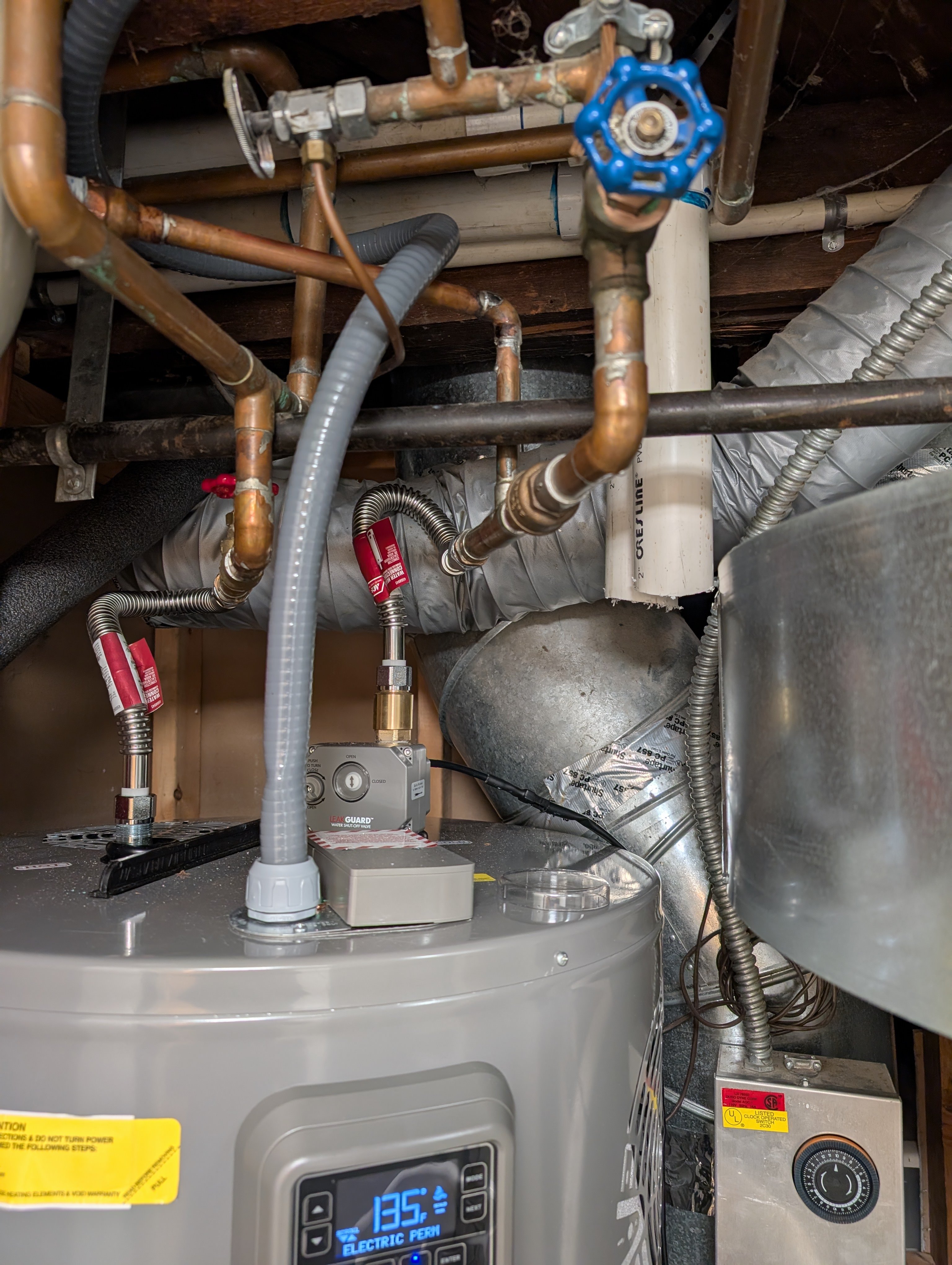

    Hi, A few thoughts come to mind. You're using the new pump without the bypass, right? Just using the dedicated return? Is there a spring check valve in that return line? A test you can do is to close the water supply to your hot system and open a hot tap. Does water flow? If so, there's a crossover from cold to hot and this is part of the problem. Can you take a photo of how the pipes/pump are hooked up to your tank? Ultimately, it is more likely a plumbing issue than a pump issue. I think you're on the right track wanting a check valve to prevent water draws from pulling cold water from the bottom of the tank backwards through the recirc line.

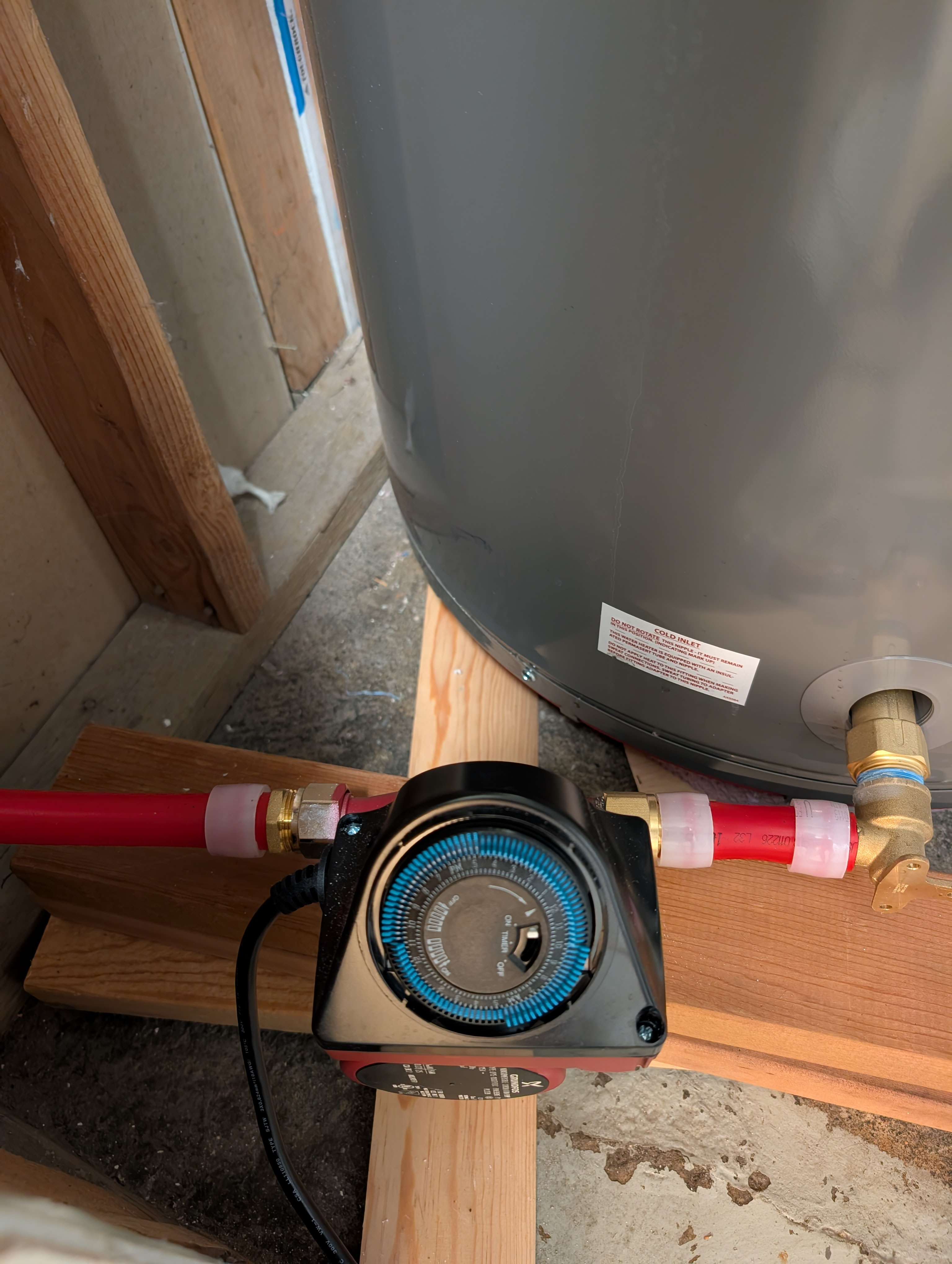

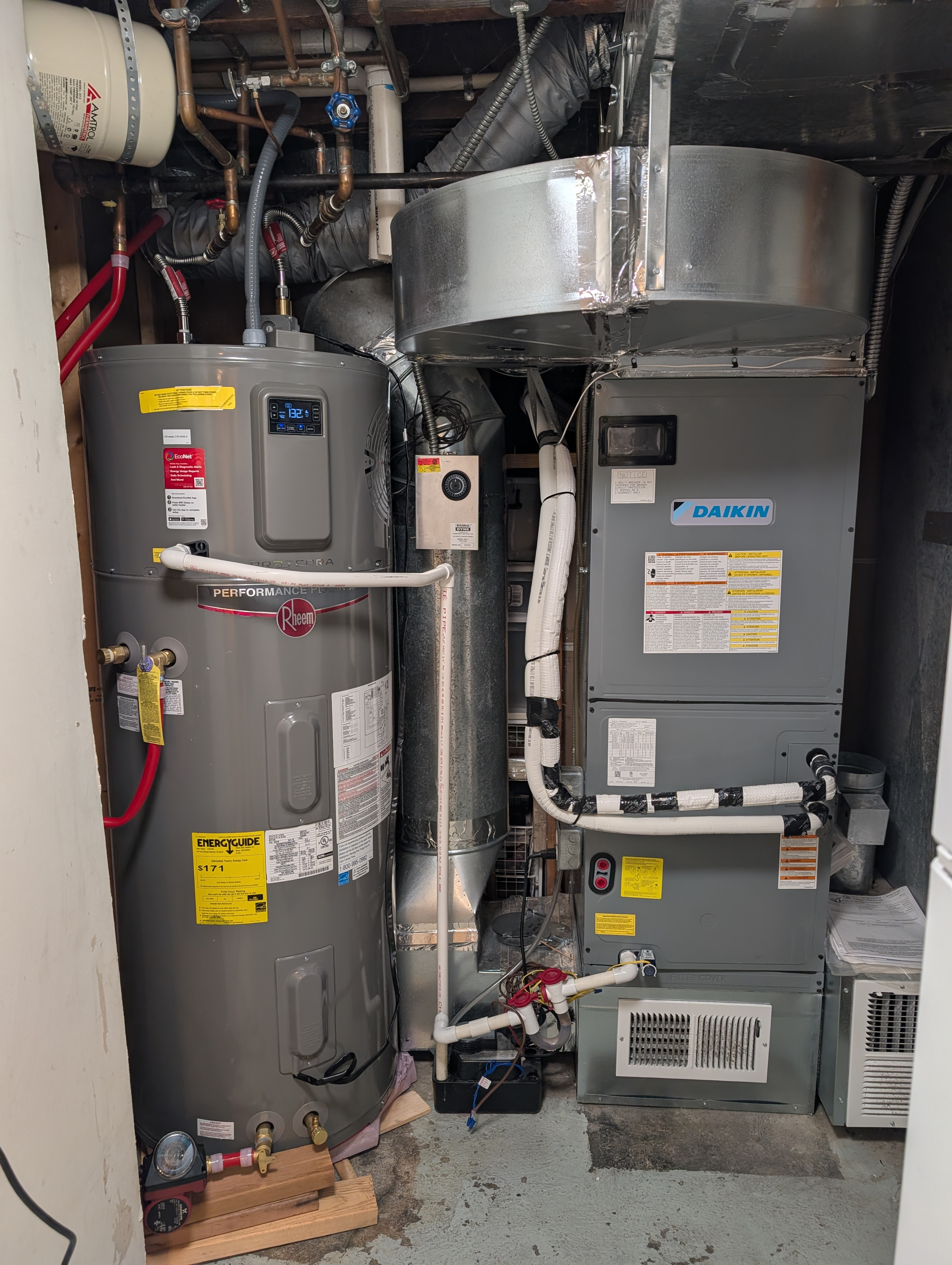

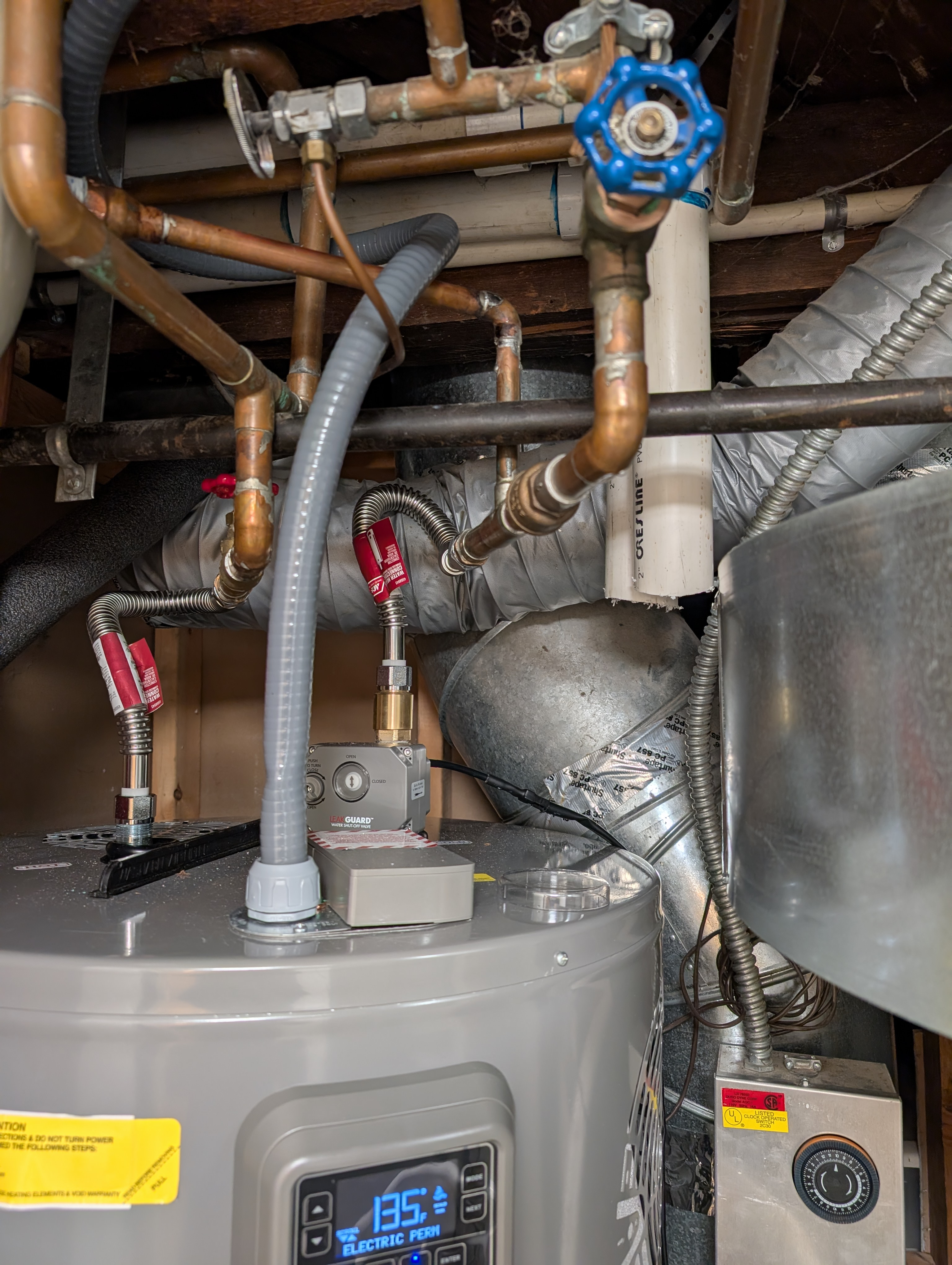

    Thanks Larry. The crossover test was positive. With the hot water supply valve off, water does flow through a hot water tap. So I guess that's a part of my problem?
    Here are pics of the whole tank and then close ups of the supply lines on
    top and the dedicated return line with the recirc pump at the bottom.
    Would a check valve between the pump and the tank do the trick or are there other concerns?

    Dedicated recirc line needs a check valve in it otherwise you can have cold water from the bottom of the tank flow backwards through the recirc line to the hot water of the fixture. Since your pump doesn't have one, you need to install an in-line one like that Sharkbite I sent earlier.

  • Did you purge the return line of air? Add a hose bibb and ball valve.
  • Just a couple of ideas. From your first description, I thought the pump might have been installed backwards , but looking at it in the photos , I believe it is correct with the arrow towards the tank. What type of control system did you have on the old pump? Was it installed to run continuously, If It was that could be why it worked without the check valve.

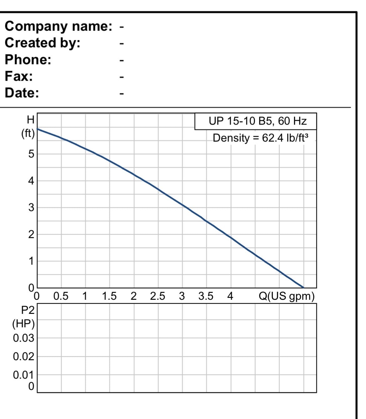

    The pump doesn't know or care that it has a bypass valve in the system or not. It just circulates the water and needs to be sized to the pressure drop and flow of the piping. That pump, based on your piping description should be fine. It just needs to flow a small amount to overcome the heat loss in the piping.
    Insulate as much of the piping as possible as the water heater runs to keep the piping warm.
    The pump can tie into the top cold, as it has a dip tube to the bottom, or at the drain port.
    A valve helps purge air and flush the tank at the bottom, if you connect there.

    Hi, I'm not seeing a drain at the bottom of the tank, just a drop ear 90. 🤔 You really want a drain there. It would be even better to have a shut off at the tank first as this would allow you to flush air from the recirc line.

    That looks like an awfully small space for a HPWH. Looks like there is a register on the air handler, so maybe that can provide enough heat. I would still watch that you are not overcooling the space during large draws and run into condensation issues on the air handler.
    You have to be careful with recirc and HPWH. Most manufacturers don't allow continuous recirc as it will significantly increase compressor runtime. The best is demand type recirc controls, next best thing is timer with temperature cutoff. I use a cheap plug in programmable thermostat with remote sensor mounted on the return line set to 95F, this halved my standby losses over simple timer.
