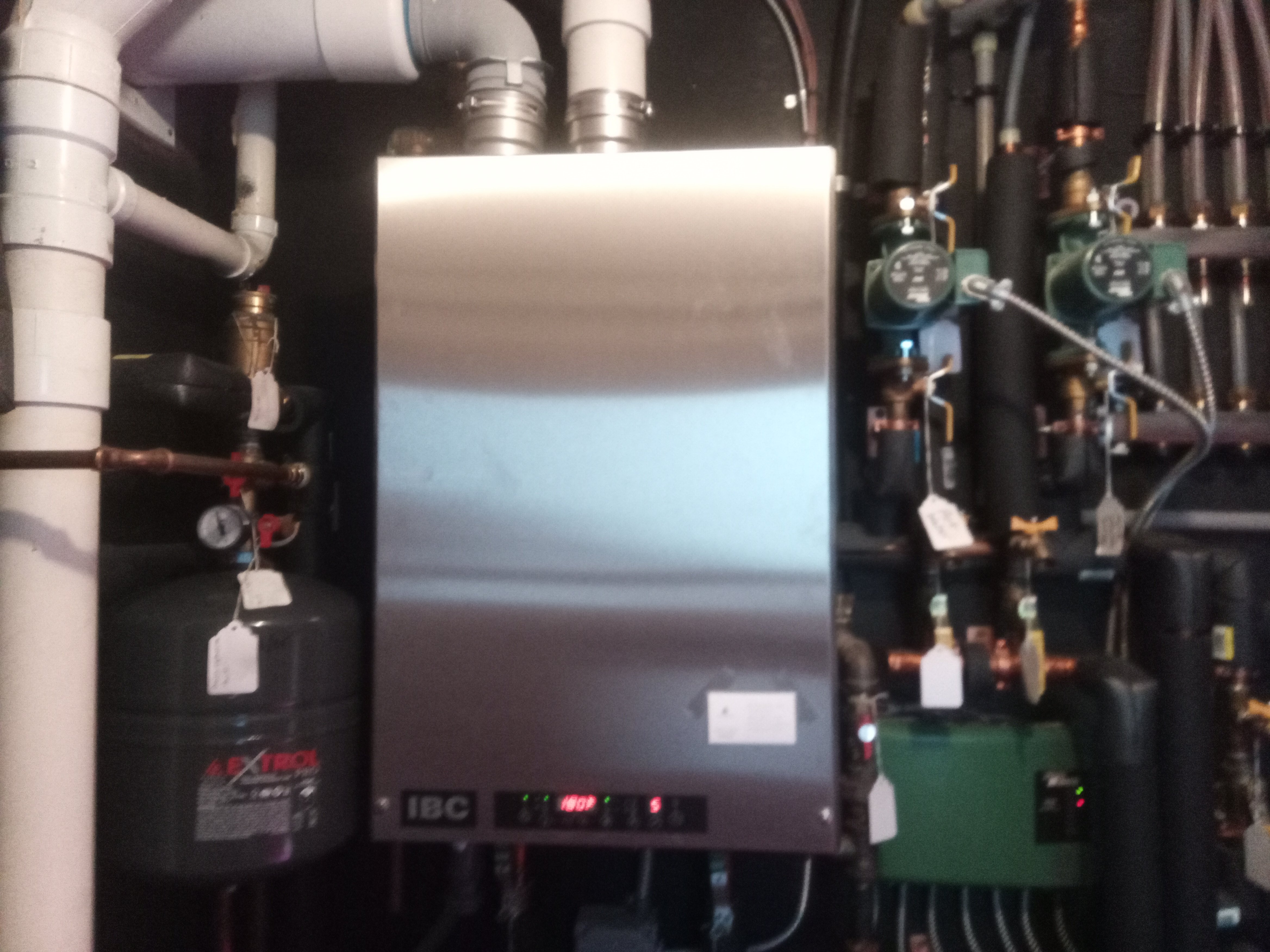

Why does my boiler's expansion tank make these noises?:
I have radiant floors. The tank is 5 months old. My previous tank was making these noises a lot. The service man said the old tank was waterlogged and replaced it.
This new tank makes the noises irregularly. For a while, it was every day in the early morning. One afternoon, I heard it twice in a row, ten minutes apart.
After I set up the camera, the tank was quiet for a week (or at least I didn't notice any noises). Then it made the noise again.
Thank you.

    Are you sure it is the expansion tank? What is the boiler/circulator doing at this time?
    Is that a pressure gauge at expansion tank, can you set up camera to watch pressure gauge during noise episode?

    I’m pretty sure that noise is not coming from the expansion tank. That might be what we call kettling. That is water boiling when it should not be.
    I would suspect this is happening inside the gas boiler’s heat exchanger, near the surface where the flame makes the water the hottest, and there is insufficient water flow through the boiler to move that heated water away from the hot spot fast enough to keep it from boiling.
    I would like to see what the near boiler piping looks like. Can you post a photo of the boiler from farther back so we can see all the pipes and pumps under and around the boiler? Something far enough away to see like this:

    I was in the room once when it made the noise, so I could put my head between the tank and the boiler. The sound is definitely coming from the tank or the pipes near the tank.
    No lights change on the boiler during the noise, so I assume the boiler isn't doing anything.
    That's a good thought about watching the pressure gauge. It's somewhat visible in my video, and it's not making any big movements. But maybe there are small movements that I could set up a camera to see.

    That Ex-tank appears to me to be a #15 and not a Extrol Pro #30. Maybe too small. Get a automotive stethoscope at a auto parts store or Harbor Freight and see if you can pin point the source of the noise.

    The circulator pump is to the right of the boiler and not visible in the video. But when my head is between the tank and the boiler, the noise is definitely coming from the left.

    I’m over 90% certain that the expansion tank is not the source of that noise. There really isn’t anything inside that tank that can make that kind of sound. The only moving part is a flexible membrane that separates air from water, and it simply moves slightly as the pressure in the system changes—it doesn’t create noise like what you’re hearing.
    A more likely cause is something called cavitation in the circulator pump. This can create a rattling or rumbling noise. Cavitation happens when the pressure in the system is too low. At lower pressure, water can actually start to boil at a lower temperature than normal. So even though the water isn’t extremely hot, it can briefly turn into tiny steam bubbles inside the pump.
    As the water moves through the pump, the pressure increases again, and those bubbles quickly collapse back into water. That rapid forming and collapsing of bubbles can create the noise you’re hearing. In simple terms: the pump may be causing tiny bursts of boiling and collapsing bubbles because the pressure is too low—and that makes the noise.

    Hi, Something is preventing pressure at the inlet of the pump from remaining at system pressure, so running the pump lowers inlet pressure. Might be the way the plumbing is configured or could be a check valve. Pictures showing more of the plumbing would be helpful. I do think @EdTheHeaterMan is onto something. 😺

    Here's a picture.
  • Kaos
    Kaos Posts: 990
    The sound could be from the air separator. You could have some gunk in there that is occasionally restricting flow when it makes it to the air sep.

    I would have to agree its not a sound an XP tank could not make. The tank pressure when ambient upon install should be within a pound of the boiler system cold pressure.
    The fact the camera was close to the circulators leads me to believe they are the target of the noise. The circs look like Taco with (IFC) Internal Flow Check markings. They have isolation valves making them easily removable and should be looked at.
    Is this model a combi boiler or just a boiler?

    It's just a boiler. I have a separate water heater tank.
    Based on what some people have been saying here, I took another look around. There's a Watts AS-MB air separator right above the expansion tank. I guess the noise would be coming from there?
    There's a red knob and a black knob on top of it.
