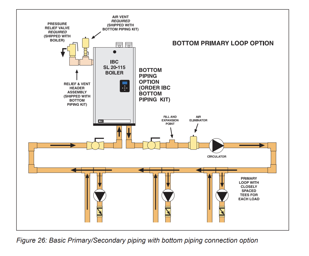

    I would like to see what the near boiler piping looks like. Can you post a photo of the boiler from farther back so we can see all the pipes and pumps under and around the boiler? Something far enough away to see like this:
    Your boiler model number would be helpful too. and your actual piping may be different

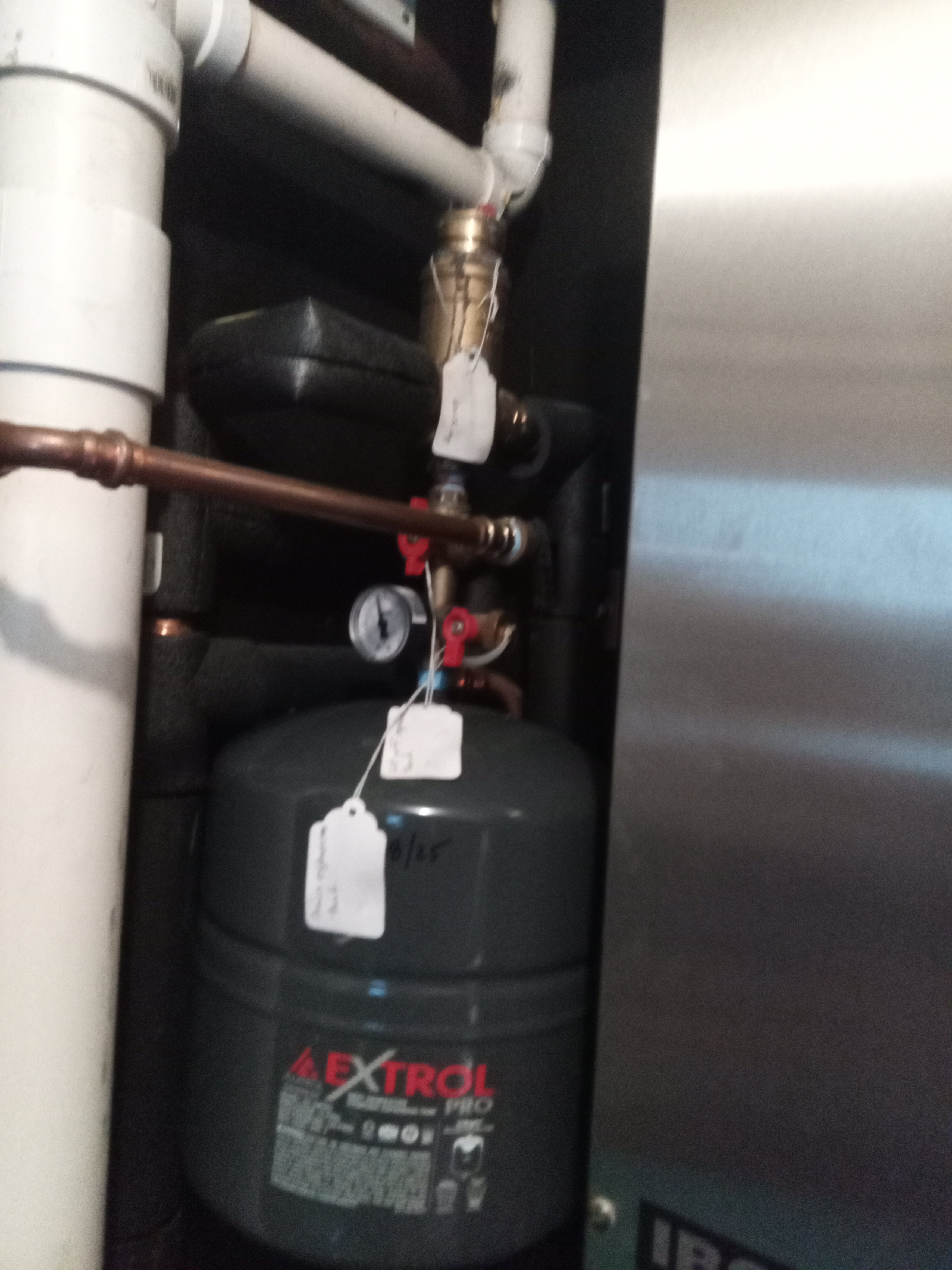

  • rea5245
    rea5245 Posts: 7
    Here's a picture.

    The sound could be from the air separator. You could have some gunk in there that is occasionally restricting flow when it makes it to the air sep.
    EdTheHeaterManbjohnhy

    Based on what some people have been saying here, I took another look around. There's a Watts AS-MB air separator right above the expansion tank. I guess the noise would be coming from there?
    There's a red knob and a black knob on top of it.
