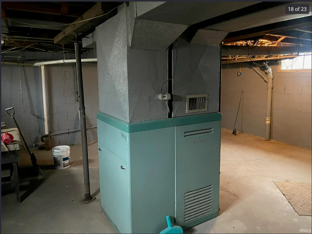

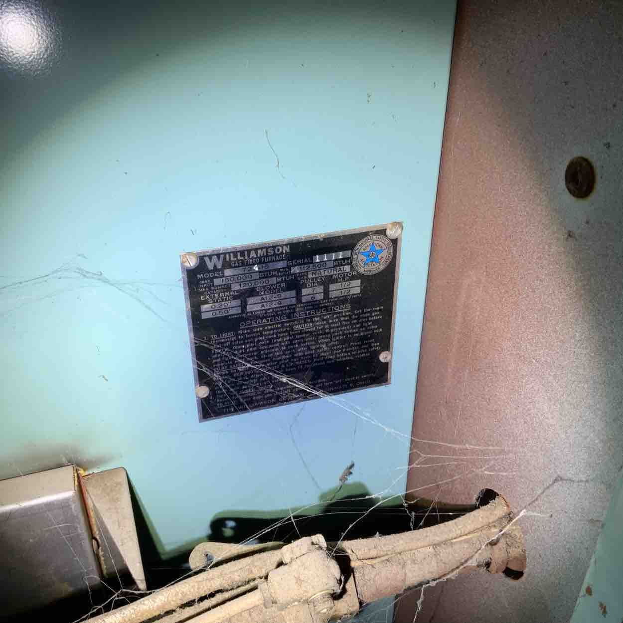

My wife and I are under contract to buy a house with the Williamson furnace pictured below. As best I can figure, this beast was manufactured no later than the early 1970s. It still runs well, from what I can tell. I am just trying to get a feel for what we are buying into here. My understanding is that furnaces this old were "overbuilt" but simple in design and easy to maintain.
Model #: 72415.
Serial #: 171 (not a typo, lol)

    mattmia2 Member Posts: 16,825
    edited March 28
    that's probably 50's. 20's or 30's would be very old.

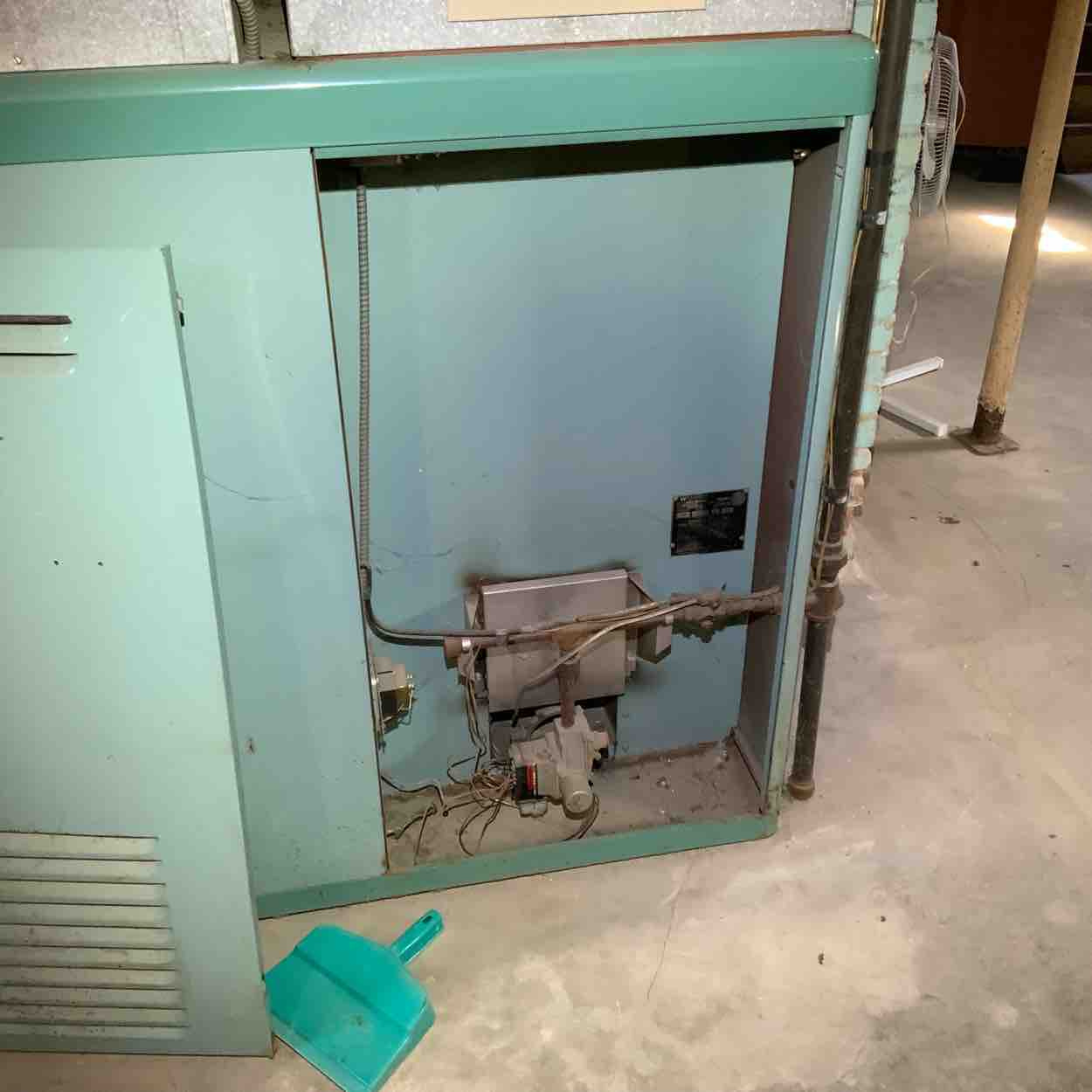

    it is good until the heat exchanger rusts out. sometimes they have asbestos paper or corrugated asbestos paper insulation inside the jacket so that is something to look out for.
    that register on the plenum that close to the burner isn't allowed but closing that off isn't a big deal.
    i can't tell what sort of gas valve it has, if it has an integrated pilot or not. i see something connected to the pilot tap on the manual valve but that might just be a pilot lighter.
    in general if the heat exchanger is in good shape it could last 6 months or 40 years.
    what you don't want to do is change the burner. if you change the pattern that heats the heat exchanger from what it has been used to for the past 70 years it will crack.

    If you buying a house get some budget figure quotes from a couple of contractors and have them knock some $$$ off the price. Just give them the furnace BTUs and the house square footage. If you have a decent home inspector he should be telling you that.
    That furnace may be 100% ok but nothing lasts forever.
    Warm air furnace usually last 20 years.
    I agree with @mattmia2 maybe mid 50s-mid 60s.
    How old is the house?
    Doesn't look like the ductwork/plenums have ever been changed. I would bet that is the original furnace.

    i would take the opposite view, i would get a good low level co monitor and inspect and clean it yearly and keep the blower oiled and run it until it dies, which may be the lifetime of several new furnaces. as long as it isn't flaking off pieces of asbestos from inside the jacket. it wasn't super common but it is something to check.
    unless you want ac, then replace it.

    Just for your information, a lot of the older Williamson "low boy furnaces" that yours is came with cast iron heat exchangers that lasted almost forever. I can't say that the furnace you show has a cast iron heat exchanger but many of them did. You would need a furnace tech to se if that one does have a cast iron heat x
    HVACNUT Member Posts: 7,454
    If I was looking at that house to be my home and that furnace was there, it would be a bargaining chip, or be put on top of the "replace" list. Lack of safeties, obsolete gas valve, belt drive shaded pole blower motor. Its going to the scrap yard.
    Is the heated space about 5,000 sq ft? Because thats what the furnace is sized for.
