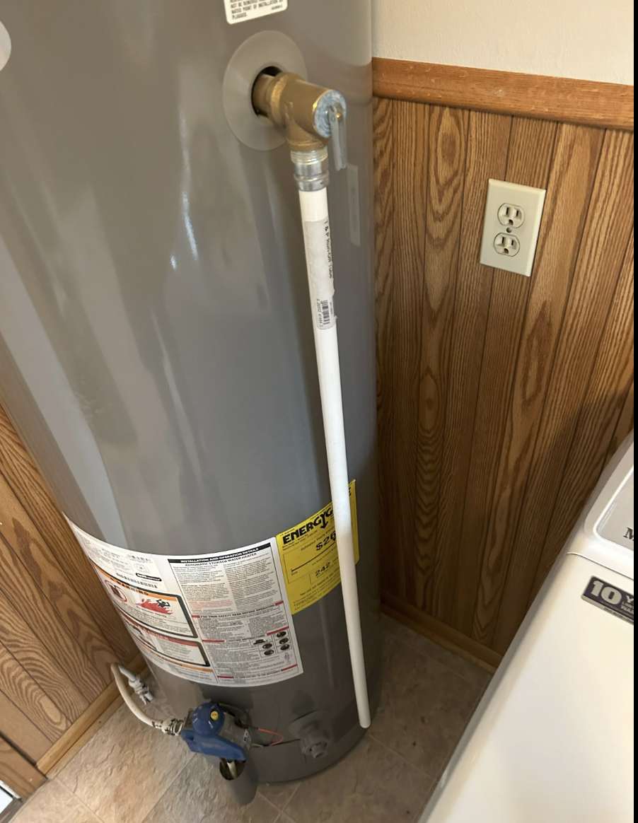

hello, my water heater heater broke, i use gas heating. Water is leaking from the pipe on the side that goes up towards the top. Do I need to shut off the gas, or can I leave it on until tomorrow? The valve is almost impossible to turn by hand. See photo for the valve that i can’t turn to shut off gas

@Frank12345 if the gas cock is the traditional metal type, it is made to be turned with a wrench. A crescent/adjustable wrench will do. It is 1/4 turn between open (handle parallel to pipe) and closed (handle across pipe).
Do not wait to turn off the gas. If you cannot, at least turn the heater control to "off".

You made mention of the pipe that goes up the side of the water heater, is the place that is leaking. I wonder if it is connected to the relief valve. When that happens many folks replace the relief valve But if you replace the entire water heater, don't use the same relief valve because if that relief valve is leaking that leak will follow to the new water heater.
If you do get a new water heater, make sure that it comes with a new relief valve.
This photo of a water heater has a white pipe connected to the relief valve, but you might have a copper pipe or a steel pipe in that same place.
