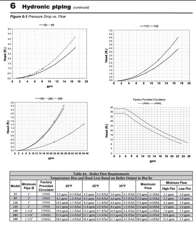

    You might find this article on circulator sizing by @Steamhead useful. He says to size assuming 3-1/2 feet of head for gravity conversion systems. By back-calculating based on delta T across our boilers, it looks like both our gravity conversion systems have about 4 feet of head, based on the pump curve for the Taco 007, which is very close to the recommended design point of 3-1/2 feet of head.
    https://www.heatinghelp.com/systems-help-center/sizing-circulators-for-old-gravity-hot-water-heating-systems/
    We have about 500 sq ft EDR per system, which according to the chart in the above link should have about 12 gpm, but as I mentioned, I've experimented down to 10 gpm with no apparent problems.
    The chart recommends higher gpms based on our boiler BTU rating. Depending on whether I used the 168 MBH input rate or the 138 MBH output rate (at 82% efficiency), the chart recommends 20-25 gpm, which is overkill, as I've found that 10-17 gpm works fine for us.

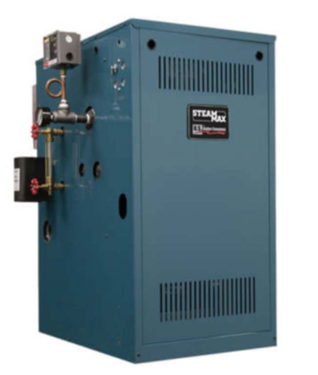

    Let's see how that might work out using published wholesale prices from the internet.
    • 1. Burnham STMX100 ………………………..~ $ 4,000.00
    • 2. Operating limit control L4080A………..~ $ 90.00
    • 3. High Limit L4006H …………………………..~ $ 290.00
    • 4. 30 PSI Relief valve …………………………….~ $ 50.00
    • 5. 2" copper pipe and fittings ………………~ $ 2,500.00
    • 6. Labor to remove pressure controls
    • 7, Labor to remove sight glass
    • 8. Labor to remove steam pressure gauge
    • 9. Labor to remove the plugged openings needed for gravity hot water
    • 10. Labor to install the limit controls
    • at least 2 extra hours for items 5 thru 10
    • This boiler is rated at 82% AFUE
    The total for the labor is not able to be posted because that is against the ruled for this forum. But lets just say that there are about 2 extra hours of additional labor to do that work that must be added to the cost of the job.
    After the rest of the regular piping and wiring that is included in the standard package boiler using smaller diameter copper pipes. You can imagine the markup and labor costs for your particular area.

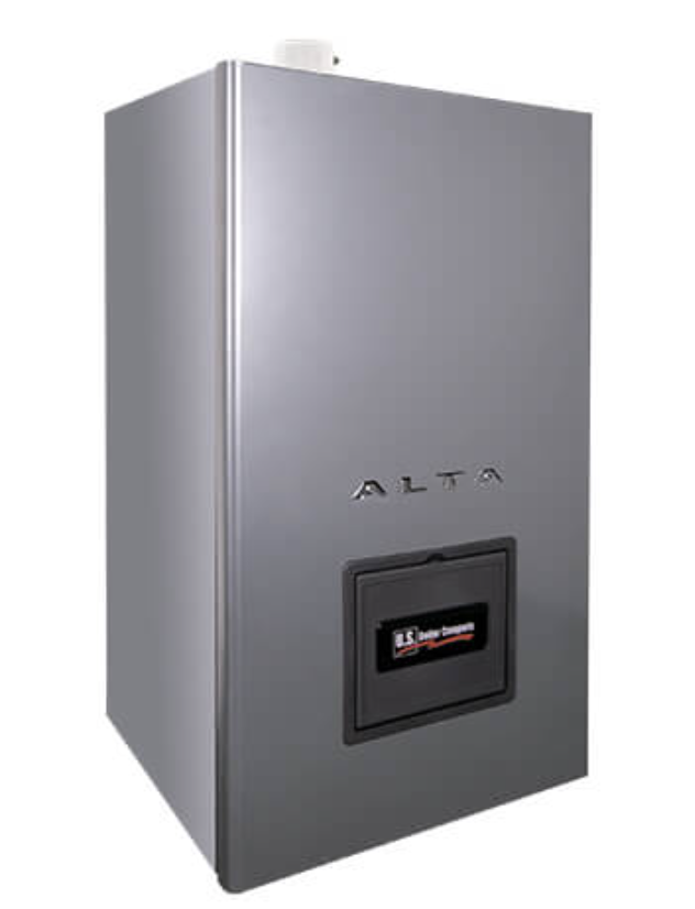

    • 1. Burnham Boiler 95% AFUE ALTA120 ………………….~$2,556.00
    • 2. Circulator UPS26-99 …………………………………………..~ $400.00
    • 3. Circulator Star-S-21F ……………………………………………~ $150.00
    • 4. 1-1/4" copper pipe and fittings ………………………..….~$1,200.00
    • 5. No extra labor to take stuff off of a steam boiler
    • 6. Limit controls are already included
    • 7. Correct relief valve is already included
    • This boiler is rated at 95% AFUE
    So after looking at this simple comparison of a modulating Condensing 95% efficient boiler and comparing it to the 82% efficient cast iron boiler, I believe that the average homeowner will probably select the more efficient boiler with 2 circulator pumps that will heat his home comfortably, even of both system cost the same total installation price. But in this comparison since the labor for a Mod Con boiler is more involved with primary secondary piping, there may be more labor hours.

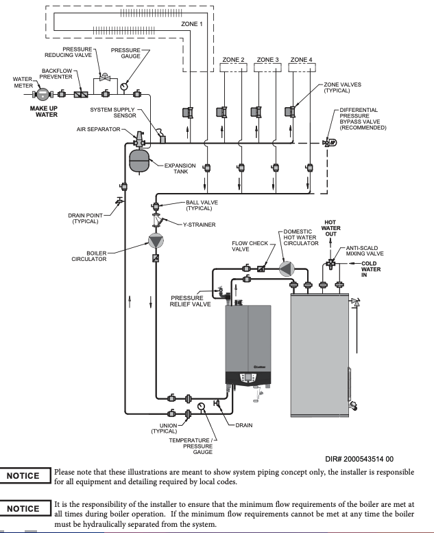

    I think most of the fire tube mod cons could work with one circulator. Their manuals tell you how much pump capacity it takes.
    The Lochinvar Knight comes with a variable speed ECM, so it would match pump gpm to load or boiler modulation.
