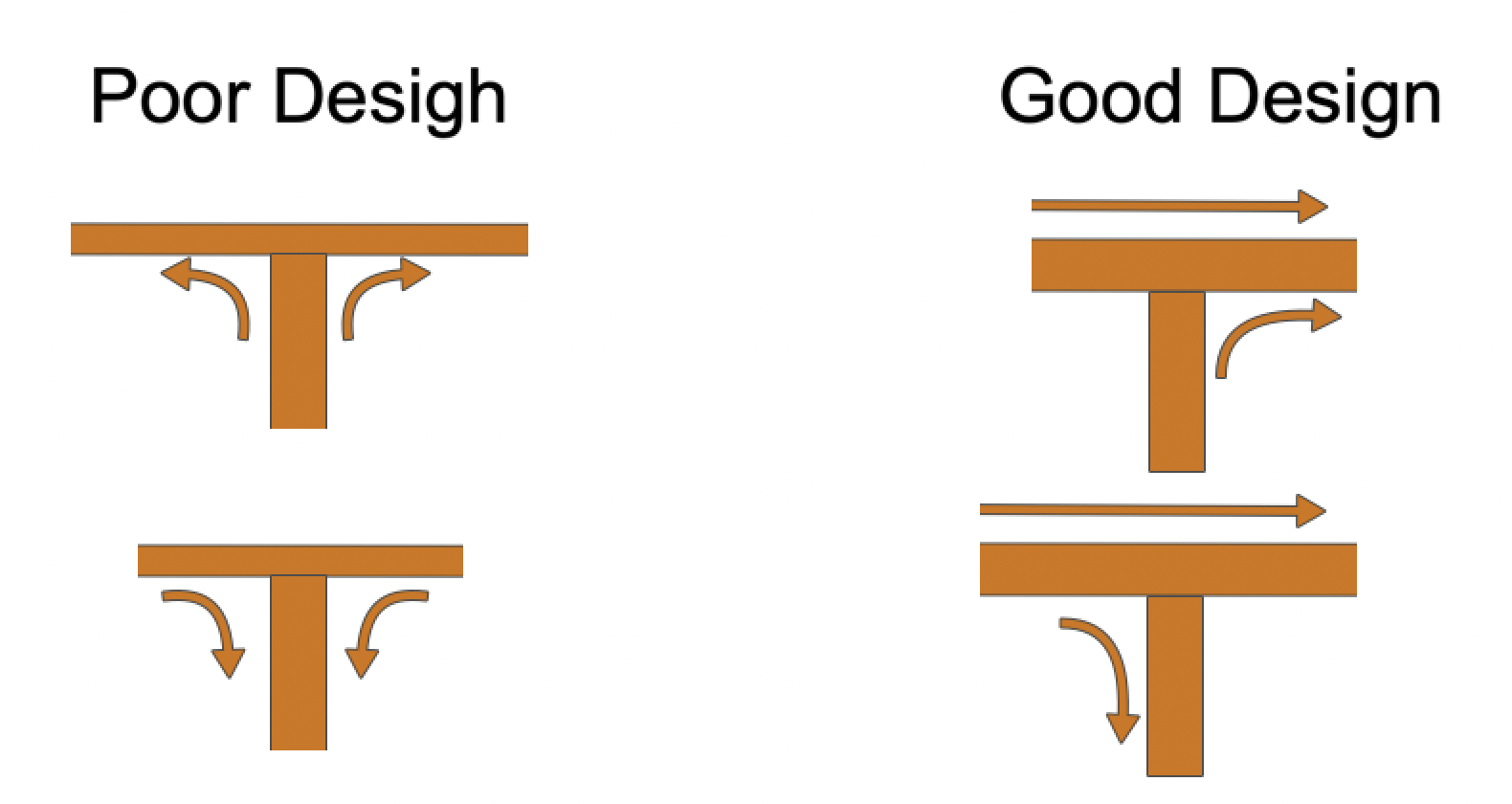

    Condensation of flue gas would be my biggest concern. You can try several different piping designs, but I find this one to be bulletproof when you need to add a small water-content boiler to a large water-volume system. Primary/secondary with a bypass for adding heat to the return to get it up to 140° quickly.
    Don't put the water flow into the tee at the run in opposite directions and exit at the branch, or put the water into the branch and exit thru the run in opposite directions

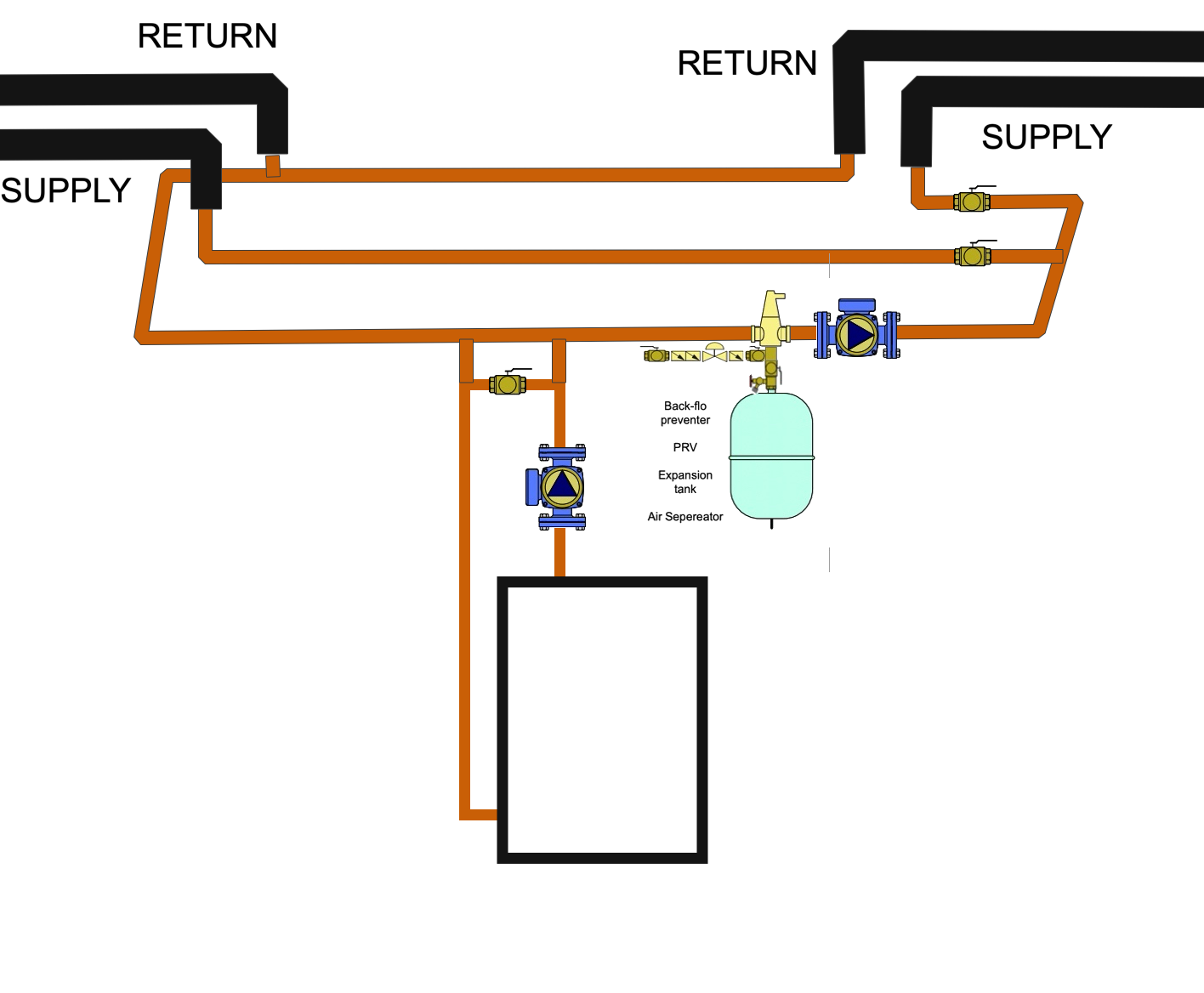

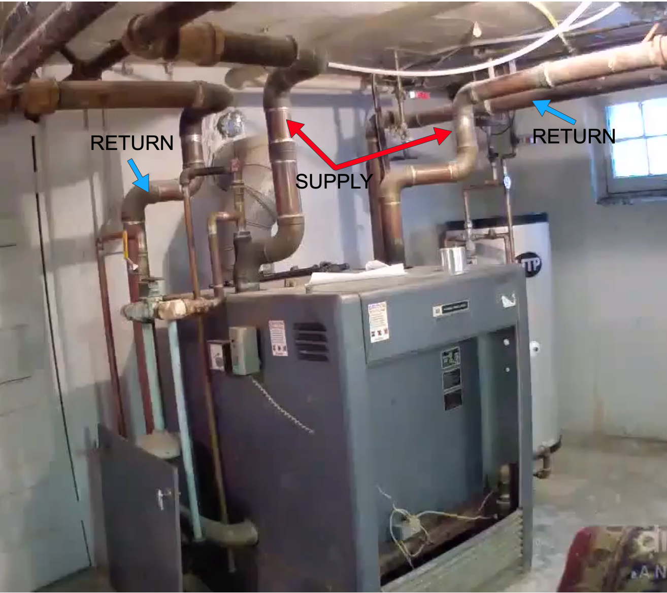

    Here is a job similar to your question:
    Old boiler with two supply and two return not circulator

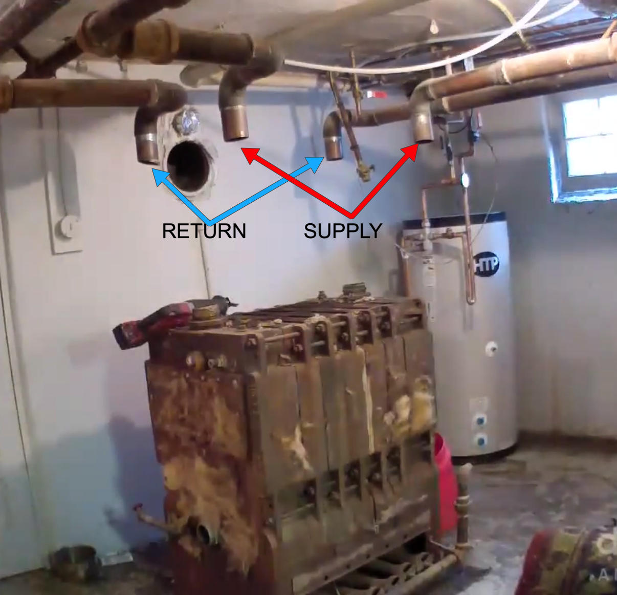

    Remove old boiler and start from this point

    This is the primary/secondary piping with the bypass just like the first diagram.
