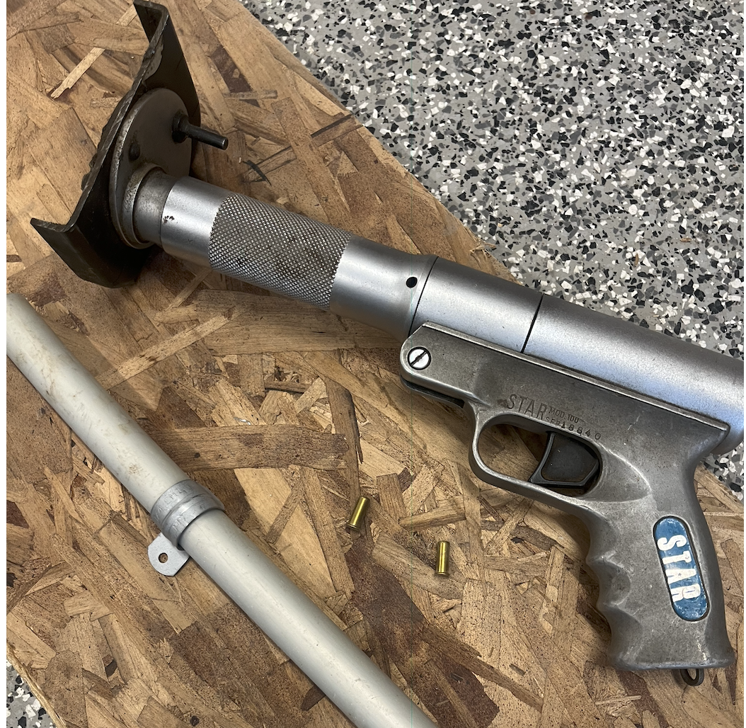

    I did a span deck radiant retrofit once. Shot anchors into the decking to clip the tube against the metal deck. Really no need to add additional metal transfer plates, you already have a massive transfer plate! Spray foam over the tube, ands decking to slow down transfer..

    hot_rod Member Posts: 27,308

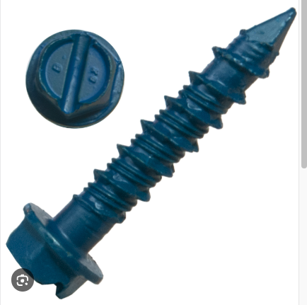

    Tapcon is one brand of concrete screw, drill the small pilot hole with included drill, a small hammer drill to drive them in.

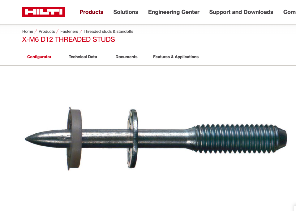

    Or Hilti and others have threaded studs that you shoot into concrete, even steel i-beams.
    Then a one hole conduit strap.

    Shouldn't short self tapping metal screws be enough?
  • PC7060
    PC7060 Member Posts: 1,786
    edited February 28
    Through the metal into the concrete? It will eat the screw thread unless you pre drill and use tapcon. The Hilti will be much faster (10x) and more deterministic.
    You could try. I think they would break when they hit the concrete before the strap tightens.
