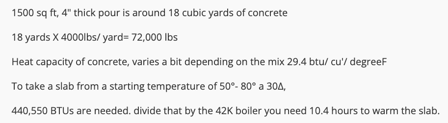

    I did a span deck radiant retrofit once. Shot anchors into the decking to clip the tube against the metal deck. Really no need to add additional metal transfer plates, you already have a massive transfer plate! Spray foam over the tube, ands decking to slow down transfer..
    Edge loss may be high unless you can insulate around the pour? Sounds like it is too later for that?
    What size is this slab?
    Assume 20X 30 X 6" deep
    about 324 cubic feet
    29. 4 btu/ cubic'/ degree difference
    so 9,525 btu to raise the slab 1°
    If you want to raise the slab from say 55- 80° it will take 238,125 btu.
    Basically you have a massive concrete flywheel that will take hours to warm, hours to slow back down. It is not an ideal slab to setback or change quickly.
    The lower the tube in a slab, the higher the required supply water temperature, and slower the response..
    I doubt that Sanden HP will put a dent in a load like this. With solar thermal, start warming the slab in August :)
    The below example shows how many hours to warm a 1500sq ft slab with a 42,000 boiler input
