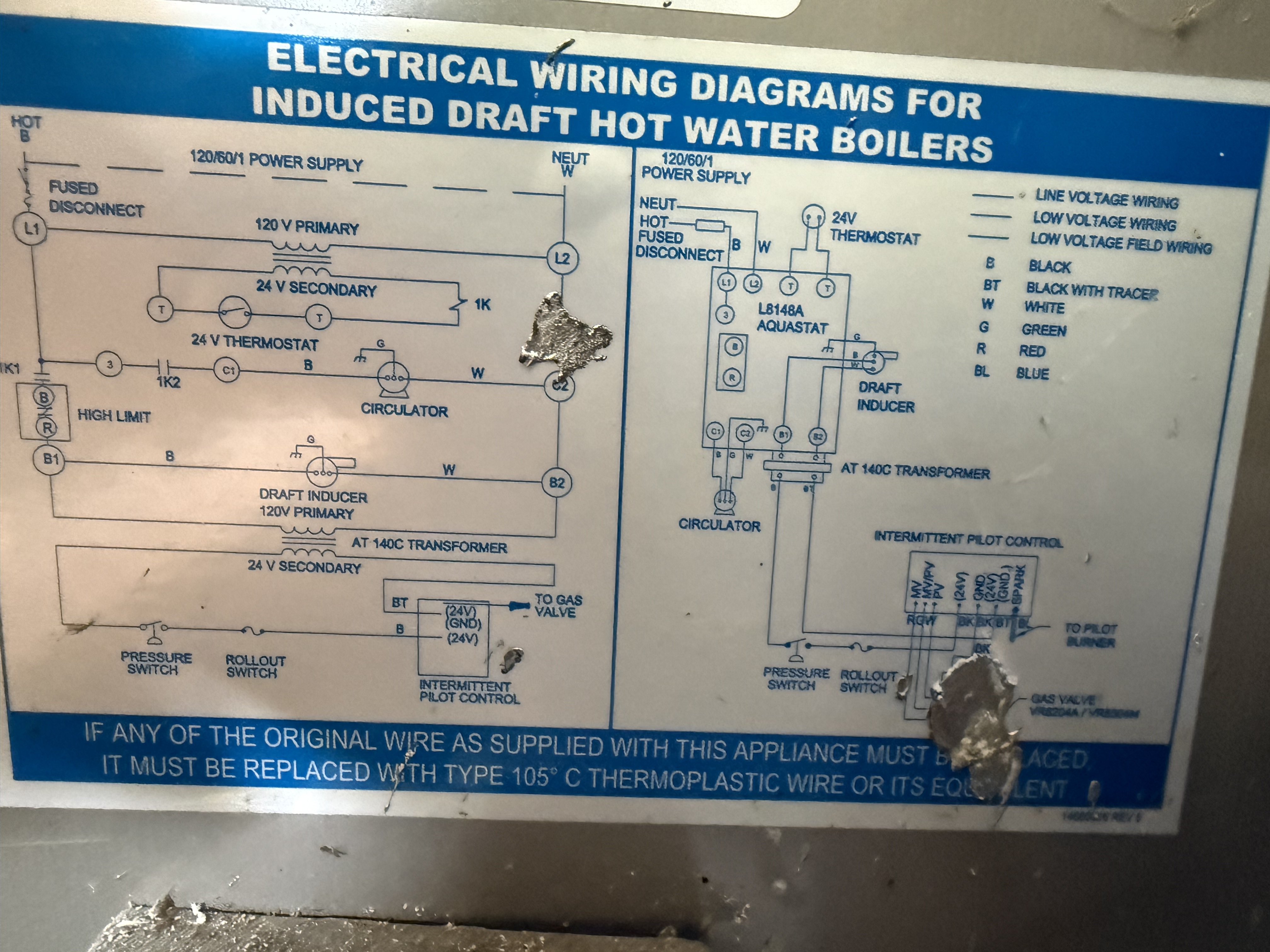

Brand new aquastat relay. Setpoint is 150F and water temperature continues to climb past 200F.
I've seen these stuck open, not closed.

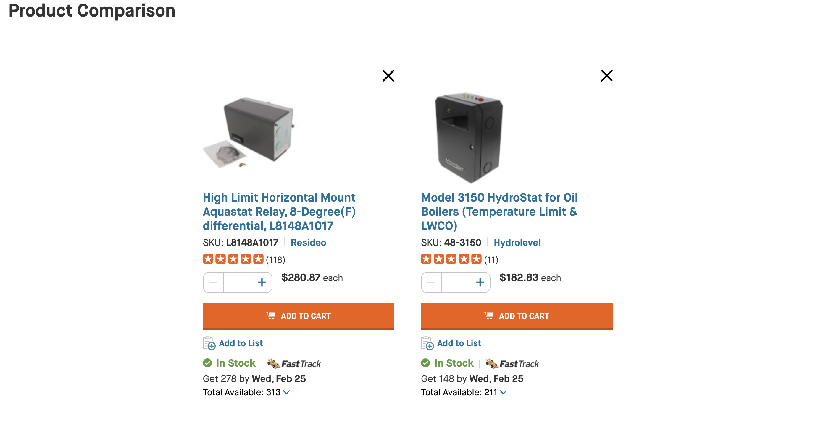

    mattmia2PC7060
    A agree with @HydronicMike and @Steamhead with the reason for a new out of the box L8148A?!?!?🤷‍♂️
    You can save $100.00 and end up with a better control

    Why? That 3150 does everything the L8148 does and it has all the same wire terminals. If you want ODR and you want to turn this into a make work project then you also need the matching well adaptor for the LWCO feature. Even so, the 3250+ is still a lower cost if you install it just to replace the L8148A wire for wire, and not use any other feature.

    it's not just ODR. The AquaSmart and HydroStat both have non-ODR economizing features. Why not take advantage of this?

    More information: This is a gas-fired boiler. We have no oil out here, other than offshore.
    The owner had a heat pump water heater installed next to the boiler and the installer - not me - moved the aquastat relay to a better location for service.
    I don’t particularly like how it was done, but I checked the well and it extends all the way down into the tee.

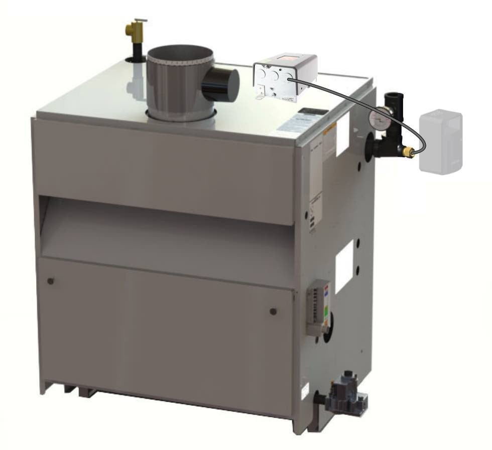

    OK, is this a side-outlet boiler with a tee installed just outside the boiler, the supply line to the system piped into the bull of the tee, and the control well in the other end of the run?

  • Two come to mind:
    • Too far away from the heat source
    • Should be horizontal
    That control works in the current orientation position, but not in the current temperature location. I have installed that contol on a buderus boiler in that orientation.
    There is a control that will work for you. Resideo L7224U 1002 with this long wire temperature probe Resideo 50001464-005 probe to be placed back in the original well adaptor on the supply tee fitting. I hope the water heater installed left it there!

    The existing aquastat relay has an adjustable operating limit starting at 150F; too hot for radiant, but appropriate for boiler protection. The one you suggest starts at 110F and a thermal bypass can be added.
    HVACNUT Member Posts: 7,613
    It should be in the boiler. The sensing bulb isn't in the flow. And instead of getting the correct control, they powered a transformer with B1,B2 for the burner circuit. Are those Shark Bite ball valves?
    Steamhead Member Posts: 18,805
    The AquaSmart and HydroStat can use extension cables too. Just have to order them.

  • Good call. The schematic shows the external transformer and it looks like the pressure switch controls the burner. Seems odd, but creative.
  • Big Ed_4
    Big Ed_4 Member Posts: 3,561
    Yeah that not going to work . :)
    edited February 22
    Wow this is an oil burner control that is used to power a 120 VAC burner control. The manufacturer has installed a second 120 to 24 VAC transformer on B1 a nd B2 to power the 24 V gas controls. I suggested that to someone before and was told here by a "Wallie" that it is not an accepted practice. I should not have left that as a perminent fix for a customer.
    I guess the manufacture of your boiler didn't get that memo!
    Using a L8124 or s L8148 to operate a 24 VAC gas system ?!? there is already a control set up for that. The Hydrolevel 3200 Plus has a 24 V. burner circuit
    Diagram to follow. Order the 48" probe cable for the Hydrostat 3200
    Oops. that was wrong… don't order the 3200 plus
    you need the 120 V burner circuit to power the inducer fan motor. I realized that when I went to draw the wiring diagram. The Resideo L7224U 1002 is the correct control for your setup.

    Looks like 3/4" run , instead of the tee replace it with a 1" cross . It will put the sensor in the stream ..

    Putting a control on a tee is questionable. Should be in the boiler.
