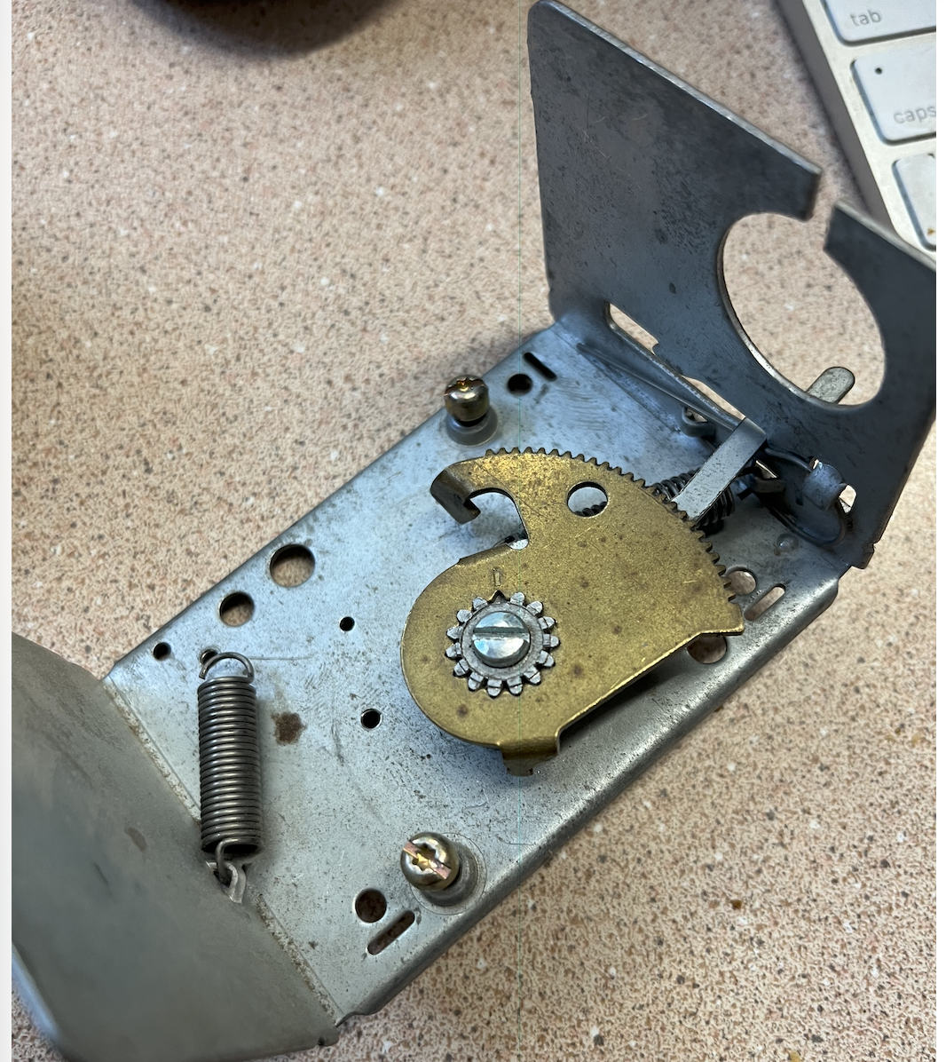

Also check to see if one spring have been disconnected, this is a common hack on HW if they experience water hammer noise. But it lowers the shut off pressure, so they may leak through.

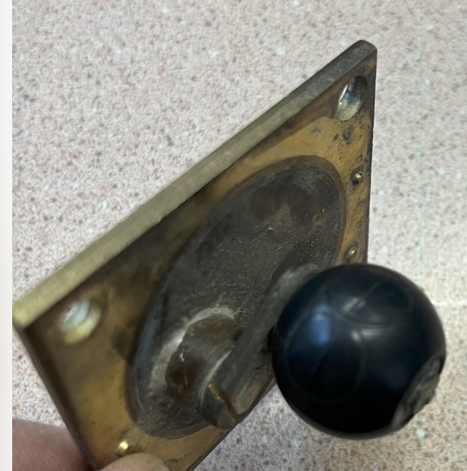

The ball on the shaft rotates, so it closes off in a different location every time. Over a period of time you get a lot of criss cross imprints and can get small leakage. Same thing with the higher head circs allowing some flow to leak through.

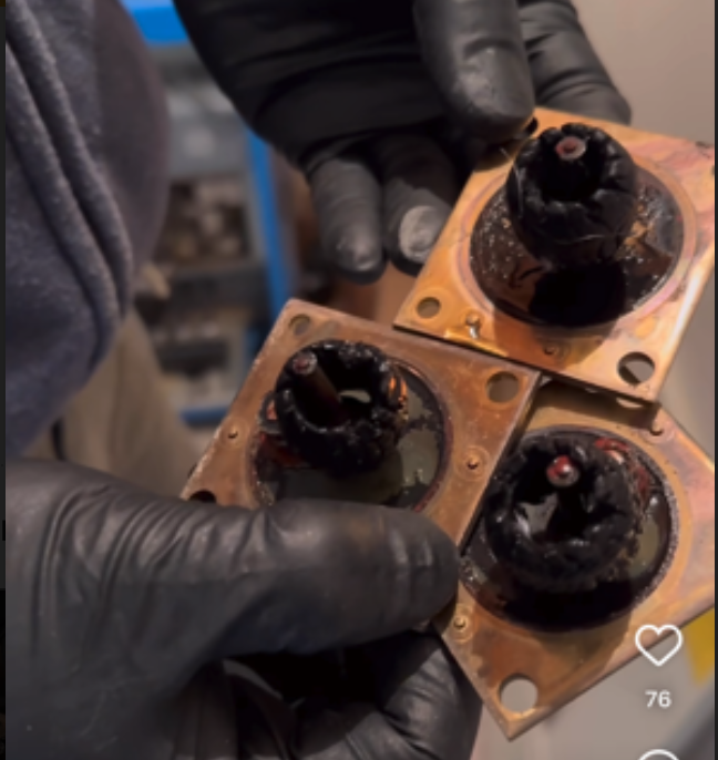

Aggressive fluid can cause the ball to deteriorate also. Allegedly these valves were two years old! Perhaps an agressive acid cleaner was put into the system??

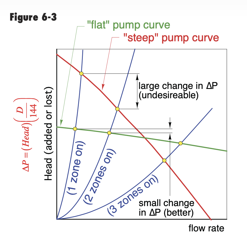

Best practice is to use a pressure bypass valve if you have 3 or more zone valves on a fixed speed circ. You want a flat curve circ on zone valve systems. As the valves close you run up the pump curve. Or better yet a delta P circulator
Fig 6-3 shows the difference between steep and flat curve circs and the ∆P difference as valves close off. On the vertical axis these two circs are about the same gpm, but the head is quite different.

I might suggest that you drain the boiler or zone and install a mixing valve. While the system has no water pressure in it, open the zone valve and inspect the ball inside the valve to see if there is a problem?
If you have a section of pipe at 180° with a valve on either end, (Check on one side and zone valve on the other) and there is no expansion tank within the two valves, when the water cools off and the water pressure turns to a vacuum, that can be enough pressure differential in the system to destroy the rubber ball on the zone valve. Remove the check valve while you are making the other repairs.

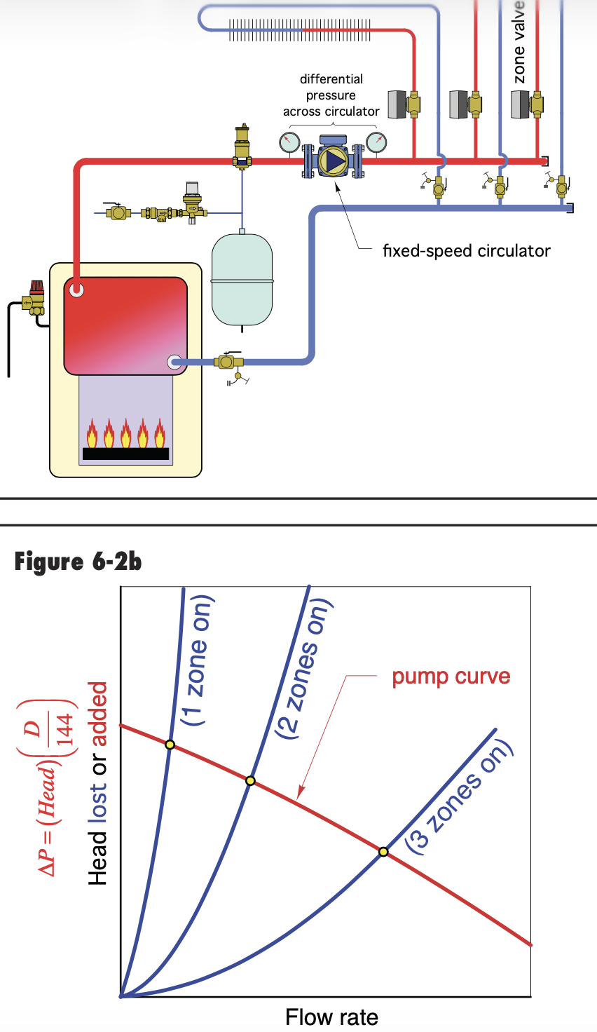

Thanks for all of the responses. Sorry I haven't gotten back to this sooner, but the customer has been out of town.
So now I've gotta schedule a time to go back to the house and determine how to control temperature to the in-floor radiant zone. The current system has a single circulator and 3 honeywell zone valves all on the supply side. (pic attached)
What is the best way to control water temperature to the in-floor radiant zone? Is there a way to do it without adding another circulator?
pretty sure it will need its own circulator to drive flow through the mixing valve.
