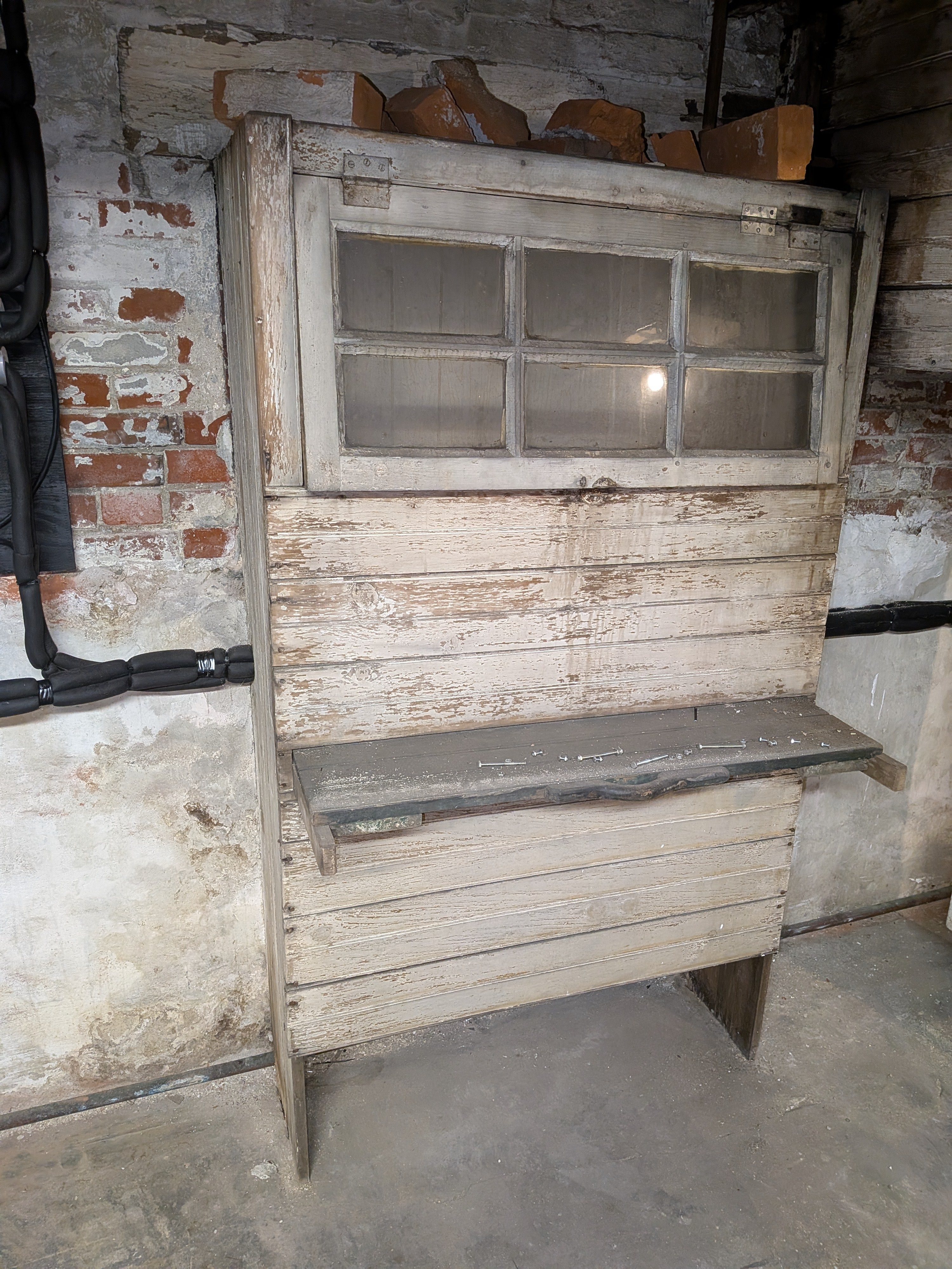

    Good to know. It's an old 3-wythe brick house, and because the ACCA doesn't have this exact construction type in their guides, I went to the trouble of manually calculating heat loss via via Manual J 7th Ed. which was the most recent version I could find in public domain. I more closely researched R-values for any construction materials that didn't exactly match, and manually put them into my calculations, arriving very closely with what I derived from Coolcalc, around 87k. It was probably all waaaay overkill, but was a great exercise to get me truly understanding all the variables involved in HVAC. Once I get a new boiler in place I need to work on improving tightness of the building. Stick-on plastic window insulation and some cellular blinds seemed to handily improve comfort during this winter's much more colder weather vs last year's milder winter. I'll need to also engineer some sort of air return for the ducted indirect heat.
    It took me a while to figure it out, but this appears to be the original outdoor air intake for the system. The area behind the window is boarded up now, but it would have been a window back in the day. I'm told there was no "exhaust" at the top of the house, because it was just assumed the heat would leak out via windows, attic, etc. Obviously, it's much less efficient to heat colder outdoor air and just let it leak out. I'm thinking maybe adding a louvered section to my basement door may be enough to get the return needed?
  • jesmed1
    jesmed1 Member Posts: 1,501
    It sounds like you lived in this house through last winter? If you have a year's worth of heating fuel cost, you can calculate your actual heat loss accurately by this method:
    https://www.greenbuildingadvisor.com/article/replacing-a-furnace-or-boiler
    @oldiron
    One reason they heated the colder outside air was it was denser which improved circulation.
