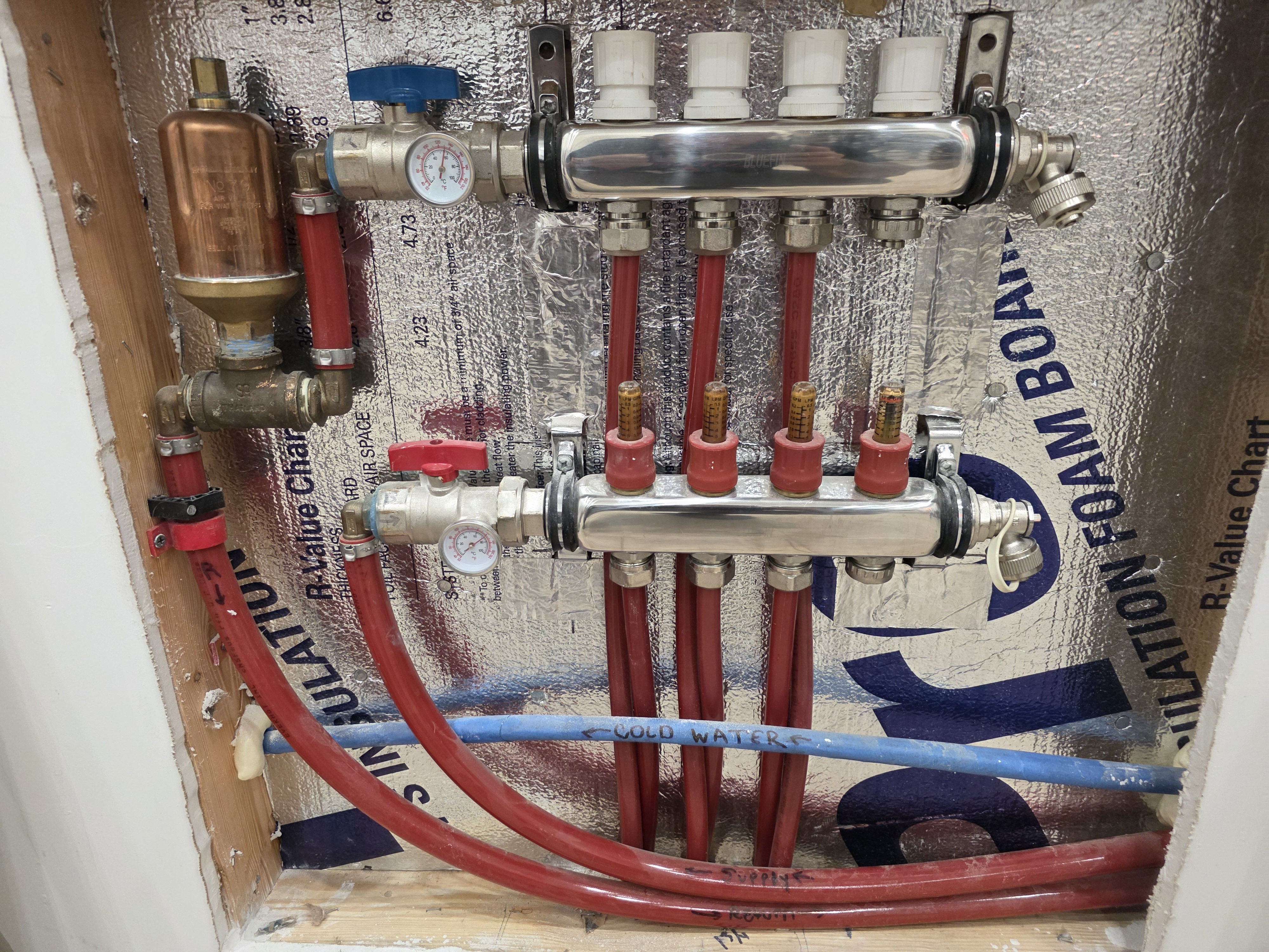

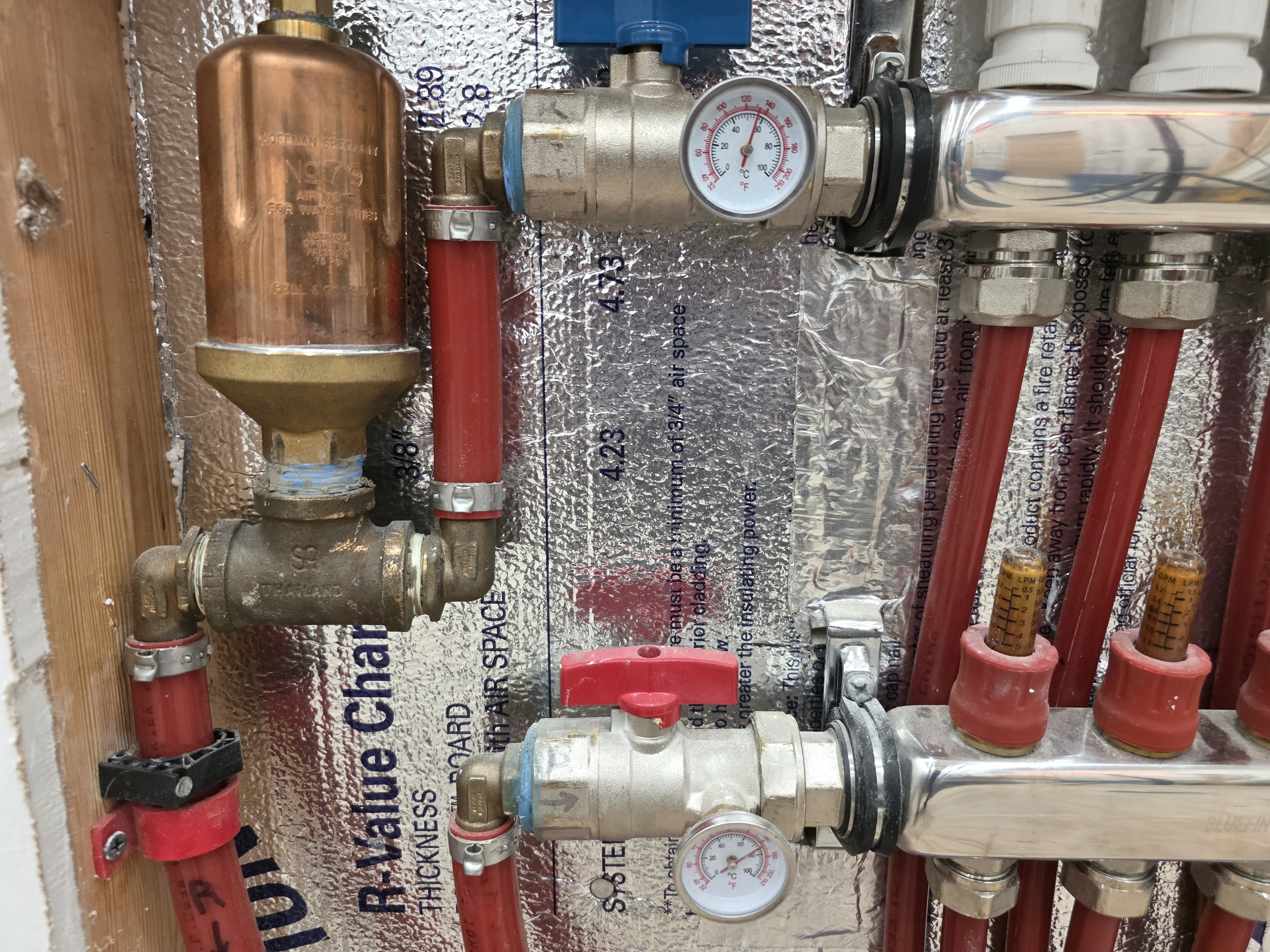

    Hey Bob, no strainers in the washers. They were the black rubber type. Here's a picture
  • CarlosMarrero
    CarlosMarrero Member Posts: 14
    Here is a picture of the manifold, following the removal of the mixing valve. The water temperature is now considerably higher. The water actually reached 180 degrees Fahrenheit on the supply, with approximately 150 degrees Fahrenheit on the return. However, I have not yet observed a significant increase in the floor temperature. I have ordered a thermal imaging camera and am awaiting its arrival so I can obtain some readings of the floor temperature.
