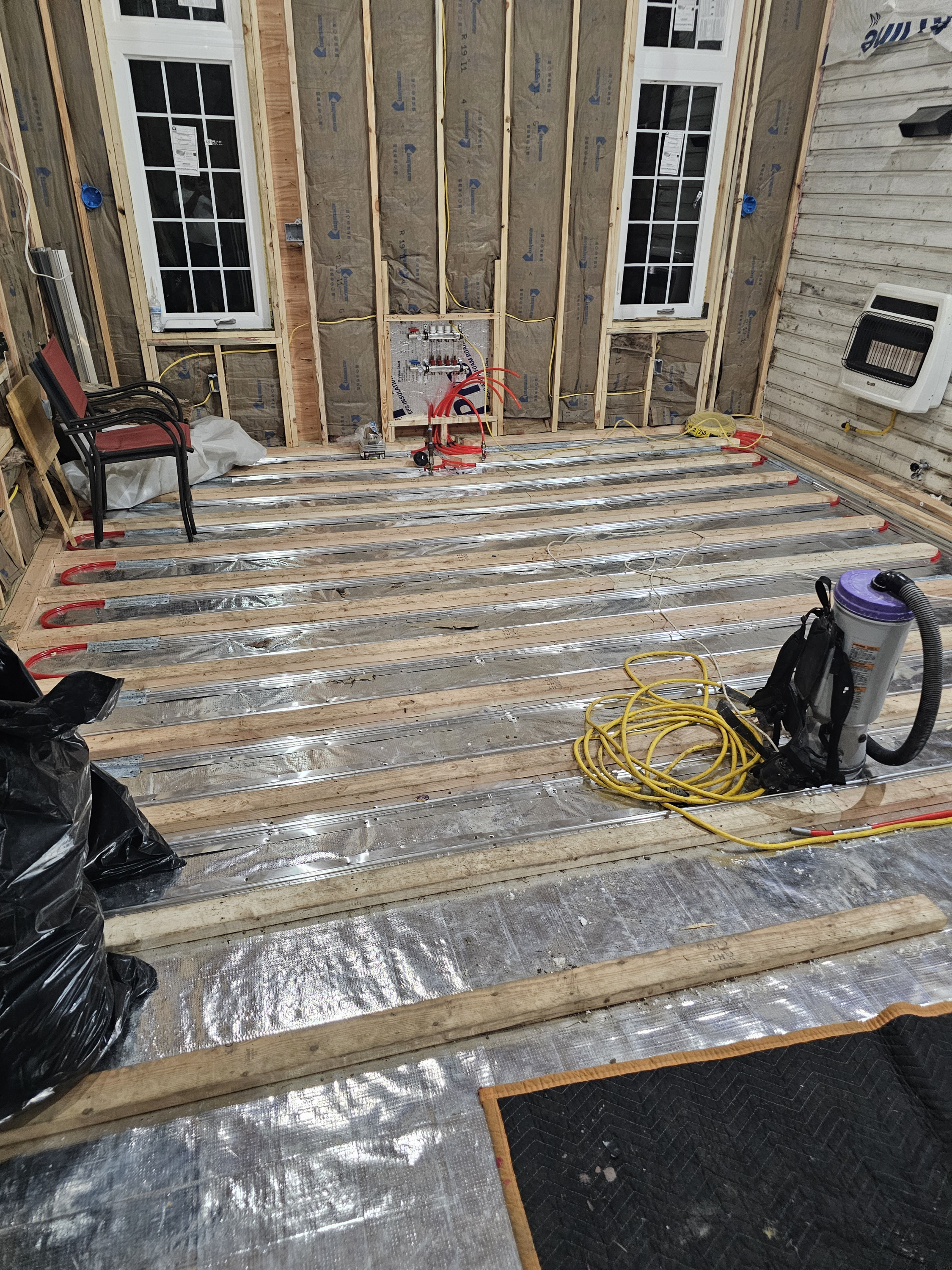

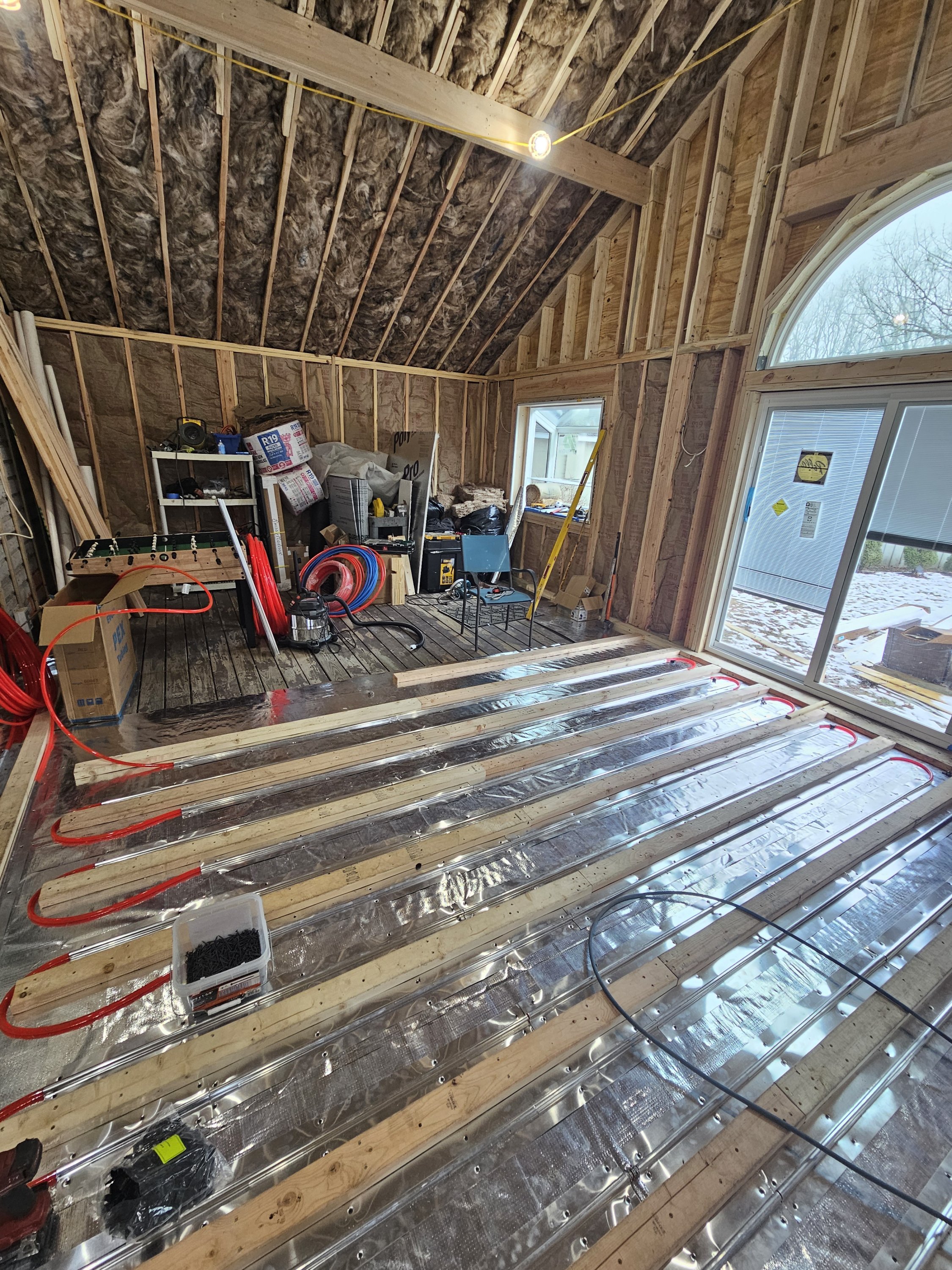

We have enclosed our deck and completed an extension to our home. The lattice around the base of the deck was removed, and we framed, sheathed, and stuccoed the area to create a foundation-like appearance. For insulation, R30 was placed between the floor joists, and then 1-inch foam board was nailed to the underside of the joists. The existing pressure-treated decking was retained. An aluminum vapor barrier was installed over the decking, and 2x4s were placed 16 inches on center on top of the decking. This provided the necessary height to align with the level of our home's entrance. The extension measures 16 feet by 32 feet. We utilized aluminum heat transfer plates securely fastened to the decking. There are three loops in total, each constructed with 1/2" PEX tubing, and no single loop exceeds 300 feet in length. A manifold is situated within the wall of the extension, with 3/4" PEX main trunk lines (for supply and return) feeding from the boiler into this manifold. This zone is equipped with a Taco 5004 mixing valve and a three-speed circulator pump. We installed 3/4" plywood over the 2x4 framing. While the room's thermostat indicates that the heat is functioning and the temperature does increase when activated, the floor itself does not feel warm to the touch. I have observed other radiant heating installations where the floor temperature registered between 70 and 80 degrees and felt noticeably warm. Currently, my mixing valve is set to approximately 140 degrees, and the return piping registers around 110 degrees, resulting in a delta T of 30 degrees. I am considering whether increasing the water temperature or even removing the mixing valve might help the floor feel warmer.
Any suggestions or assistance would be greatly appreciated. Thank you.

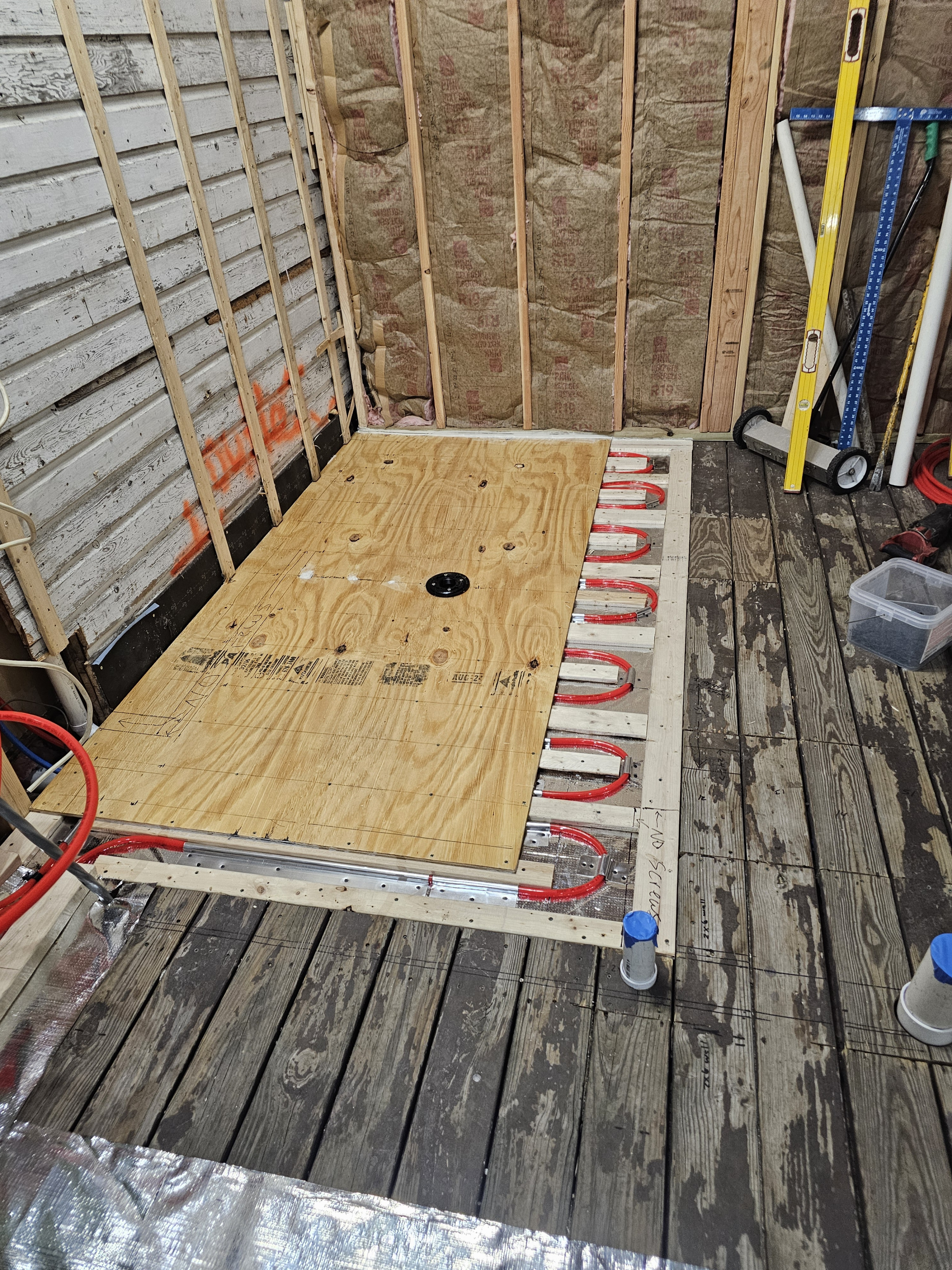

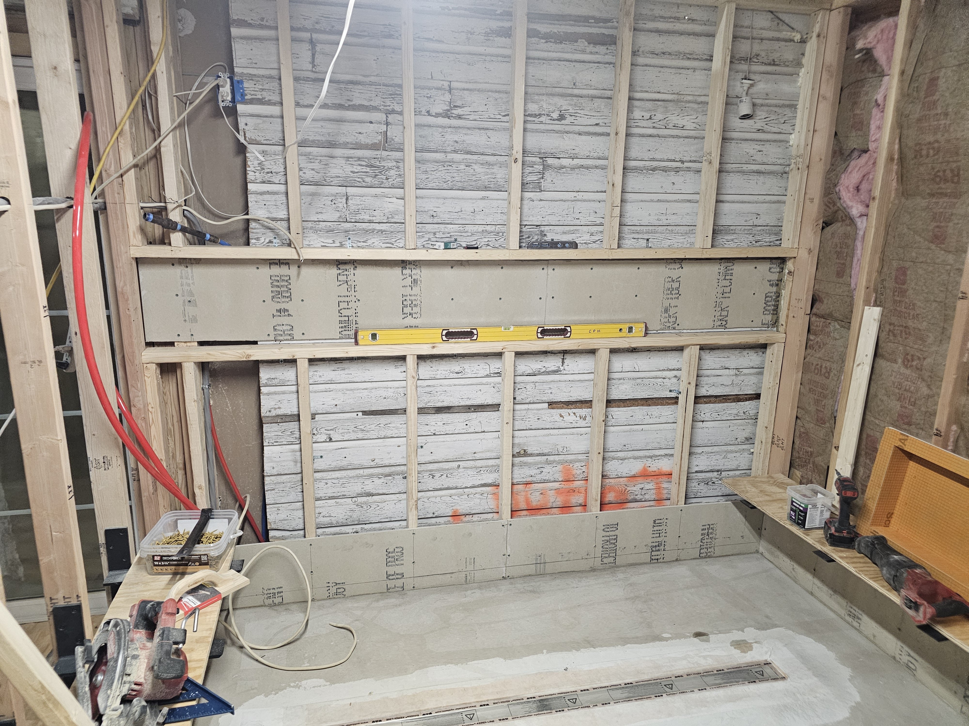

  • The drywall and plywood sheathing are all done. The whole area is about 550 square feet and is being turned into a bedroom and a master bathroom. We're using marble tile in the bathroom, but I'm not sure what kind of flooring to go with in the bedroom. Any recommendations, looking for something that work best transfering the heat? Hoping to be able to get the floor temperature up to at least 70 to 80 degrees

  • looks to me the plates are installed upside down. You’re relying more on reflective heating rather than radiant, especially with the airspace.
    How much insulation is under the tubing and is there any insulation around the edges, especially at the slider?

    I agree. Looks like there is no actual conduction/ contact w/ the subfloor. Its going to be hard for that heat well.

    the tube and plates will heat those channels and transfer heat upward. It may take a high temperature supply like suspended tube methods.
    How you get the surface to 80 degrees does matter as much as if you can get the floor that warm. Lots of glass on the one end is the biggest load.

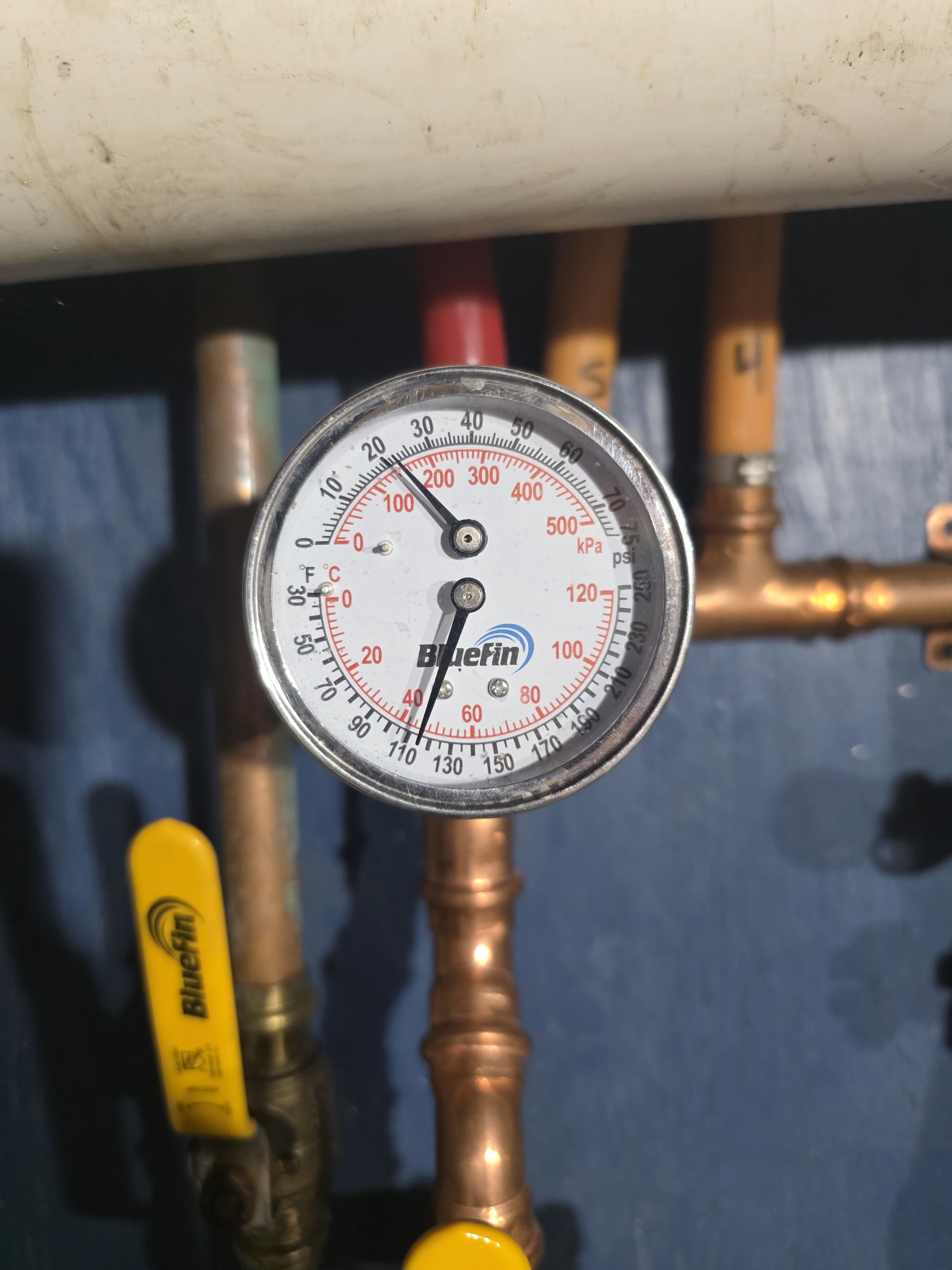

    I'd drill a small hole in the plywood and measure the air temperature on the underside with a probe thermometer. The floor assembly is probably about R1.75, to get a surface temperature of 80F with the room at 70F the air under the plywood has to be at 105F.
    The water temperature is dropping a lot — 130F to 110F — so either a lot of heat is being delivered, or the water flow is very low. Measuring at both ends of the loop might give an idea. If you have good heat at the hot end of the tubing it might just be you need to increase the flow.

    What you have is a little like a joist bay heating application. The flooring doesn't actually contact the tubing in this install so what you are relying on is to heat the air space between the tube and the floor, and that hot air is what will heat the floor. It will work but is more a medium or high temp application than a low temp radiant floor. With a 30 degree delta T that does show us you heating something, if that heat doesn't end up in the room I might look at where it is going. The good news is that you can definitely make it work, it will just be a slightly higher temperature supply that you need.

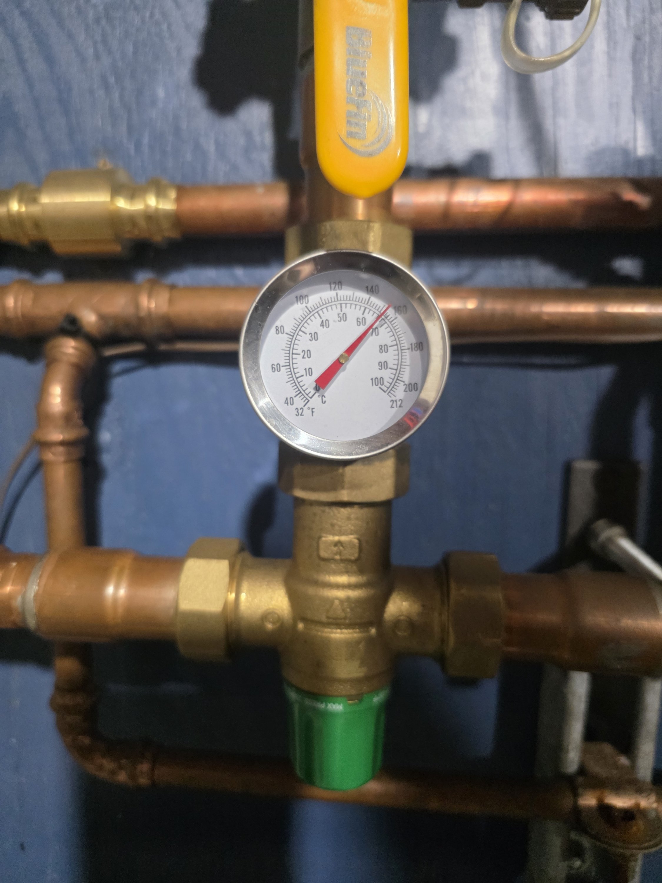

  • Hey, thanks for getting back to me so quickly. I actually cranked the mixing valve temp to max. I've got the Taco 5120 union and temp gauge on the mixing valve, but I'm not seeing the water hit that 175 degrees. It only gets up to about 150, I'll have to check it again this weekend when I'm back by the system. And yes, the mixing valve is a 2.3 cv valve.

  • The water temp on the H port of the mixing valve is set to 180 degrees. I don't think there's a strainer in the mixing valve, but I'll open it up to check, I think there might be a check valve inside. I also know the circulator pump has a check valve. I'll be back by the boiler this weekend to double check everything. Again, thanks for your help ☺️
    hot_rod Posts: 28,705
    remove the checks. Usually if there are checks, there are also strainers. The strainers may be built into the union washers.
    Measure the temperature at the H port, it needs to be a bit higher than the mix outlet you are trying to get. You cannot get to 175 if the hot is only 180. It varies from valve to valve, usually the hot needs to be at least 10 degrees hotter than the mix that you want
    But I’m not convinced you need to go to 180. Ultrafin, suspended tube (joist bay heating) those can run 140- 160 temperatures
    if in fact you do need over 160, get rid of the mix valve. You get higher temperatures and much higher flow potential

    I have installed several types of radiant systems; one like yours with soft aluminum pans but stapled-under-floor using 7/8 PEX with R-19 below in the joist space, foil up. That house has 1/2 subfloor, 5/8 underlayment and commercial vinyl tile. Has worked well since 1991.
    Another very recent house has Uponor extruded aluminum double channel pans per bay with 1/2" PEX screwed up under the floor. R-19 below, no foil. I'm struggling to get this house to temperature but think it's more of an infiltration problem (old house). In this house I'm seeing mid to high 130's feed temps and 90-100F return temps. I've been shooting the floor surface with a hand-held IR gun and getting 72-80F surface temps. The 80F surface temp is probably too high from what I've read (feet sweat) but like you, I am trying everything to get the room temp up.
    I thought these numbers might help you but we have different problems. I don't like your air space and I know you don't want to hear this but I would have filled that space with gypcrete or something that would take the heat from your pans and transfer it to the floor surface. Your insulation under the system is great. Buy or borrow an IR gun and shoot around to see your surface temps. C.

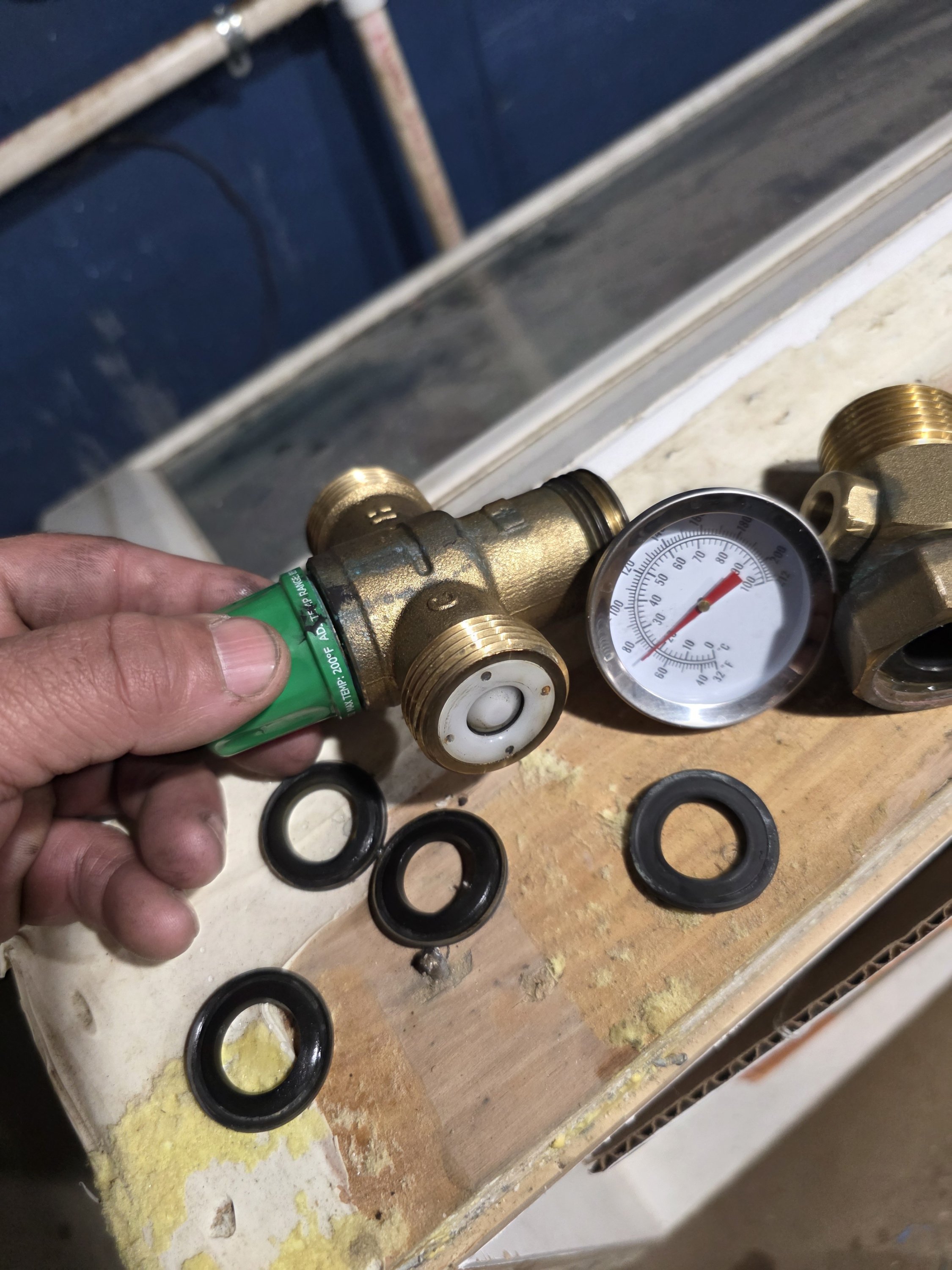

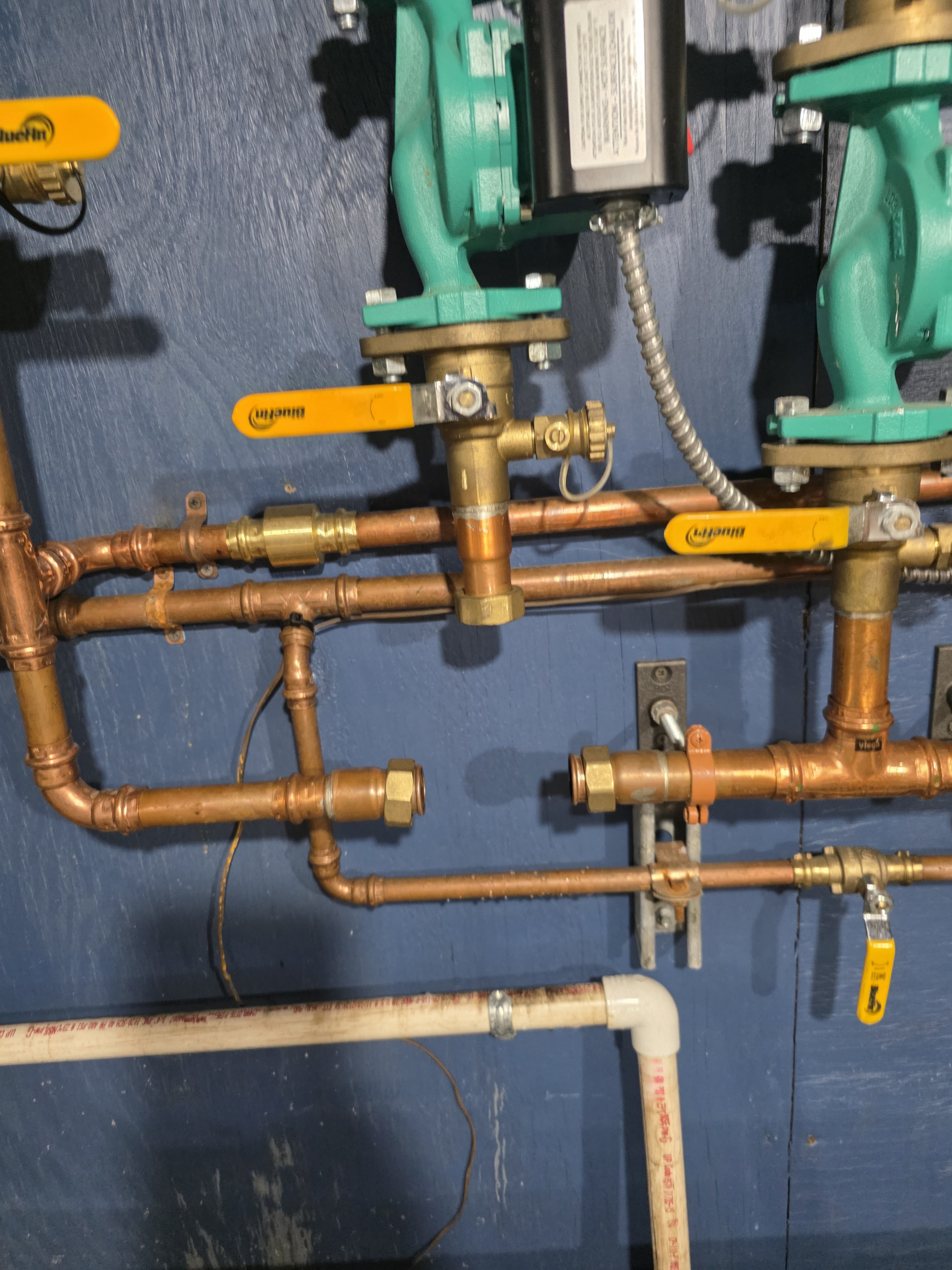

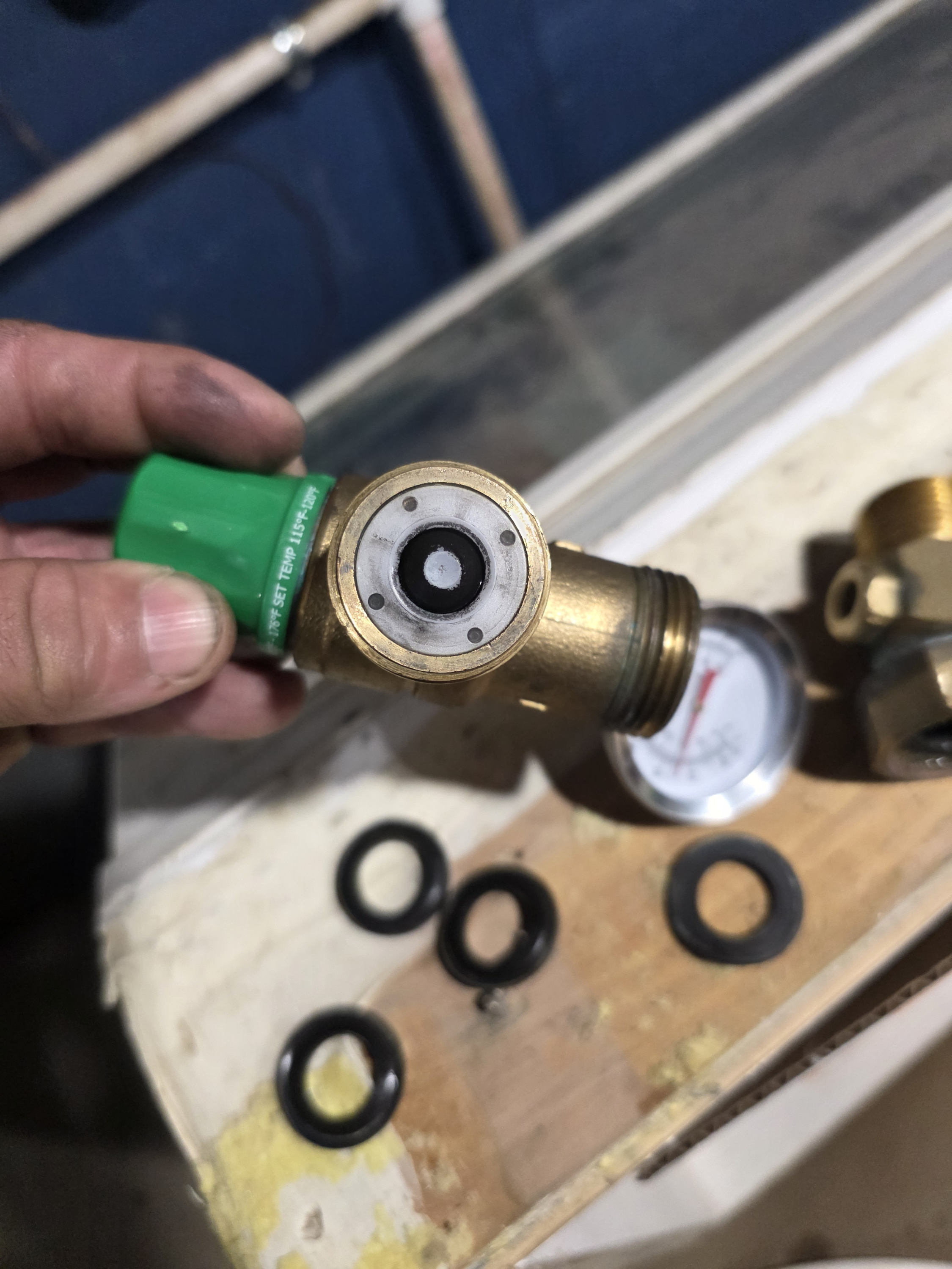

    Hey, quick update. I took out the mixing valve. It didn't have a strainer, but it does have built-in check valves on the C & H ports. Should I try taking out the check valves?
    Also, the mixed water going to the zone temperature hit about 152°, and the return temperature was around 115°.

    I would leave the checks out, no need for them in a hydronic loop.
    You need to let a hydronic system run for a while to get an accurate operating delta. It typically starts wide when the distribution system is cold.
    The higher the mass or under heavy heat load, the longer it will take to stabilize.
    when the supply and return temperature stabilize, stop moving, then your are at hydraulic equilibrium. That will be actual operating delta. It will always move some as the load on the room changes.
    Residential radiant designs are in the 10-15 delta window. The tighter the delta the more consistent the floor temperature will be.
    You are sure the washers didn't have strainers in them? Are they black rubber or a hard fiber type?

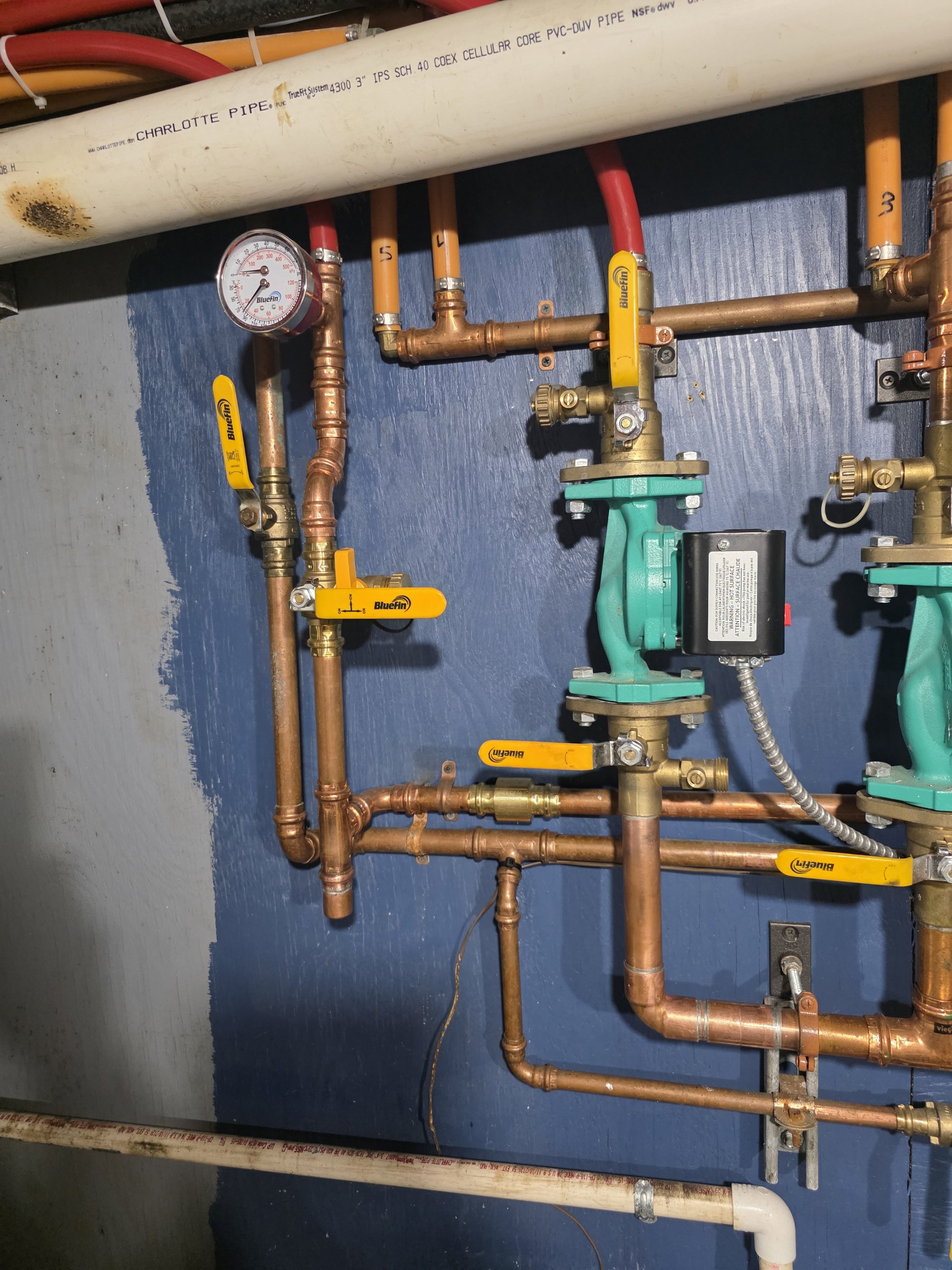

    Without the mixing valve your flow through that zone will likely pick up substantially. Instead of having a Delta 37F (152 to 115), i suspect your delta will be closer to 25-30 (180 to 150).

  • Hey Bob, no strainers in the washers. They were the black rubber type. Here's a picture

    Here is a picture of the manifold, following the removal of the mixing valve. The water temperature is now considerably higher. The water actually reached 180 degrees Fahrenheit on the supply, with approximately 150 degrees Fahrenheit on the return. However, I have not yet observed a significant increase in the floor temperature. I have ordered a thermal imaging camera and am awaiting its arrival so I can obtain some readings of the floor temperature.

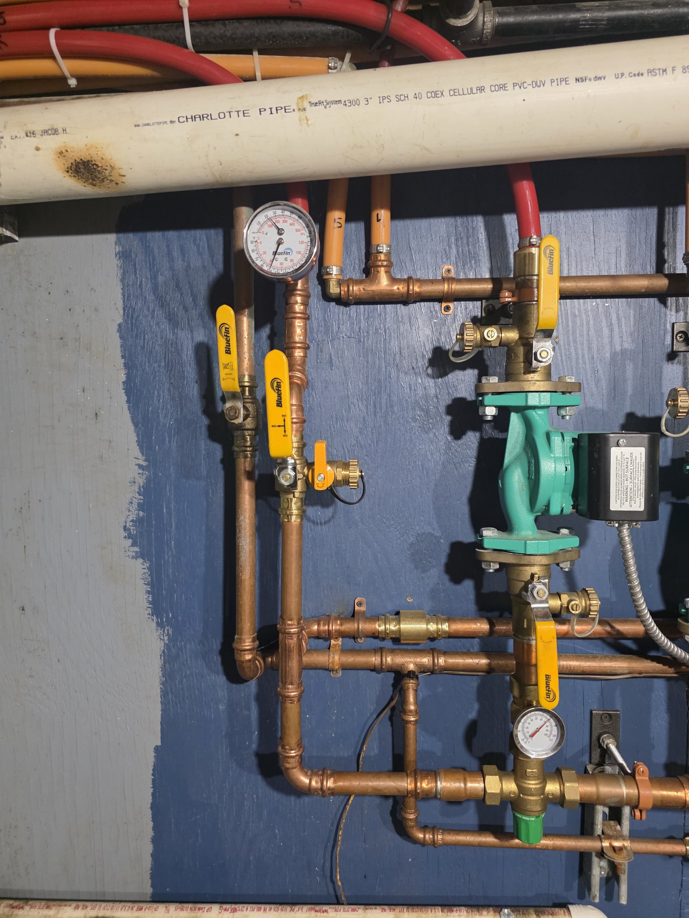

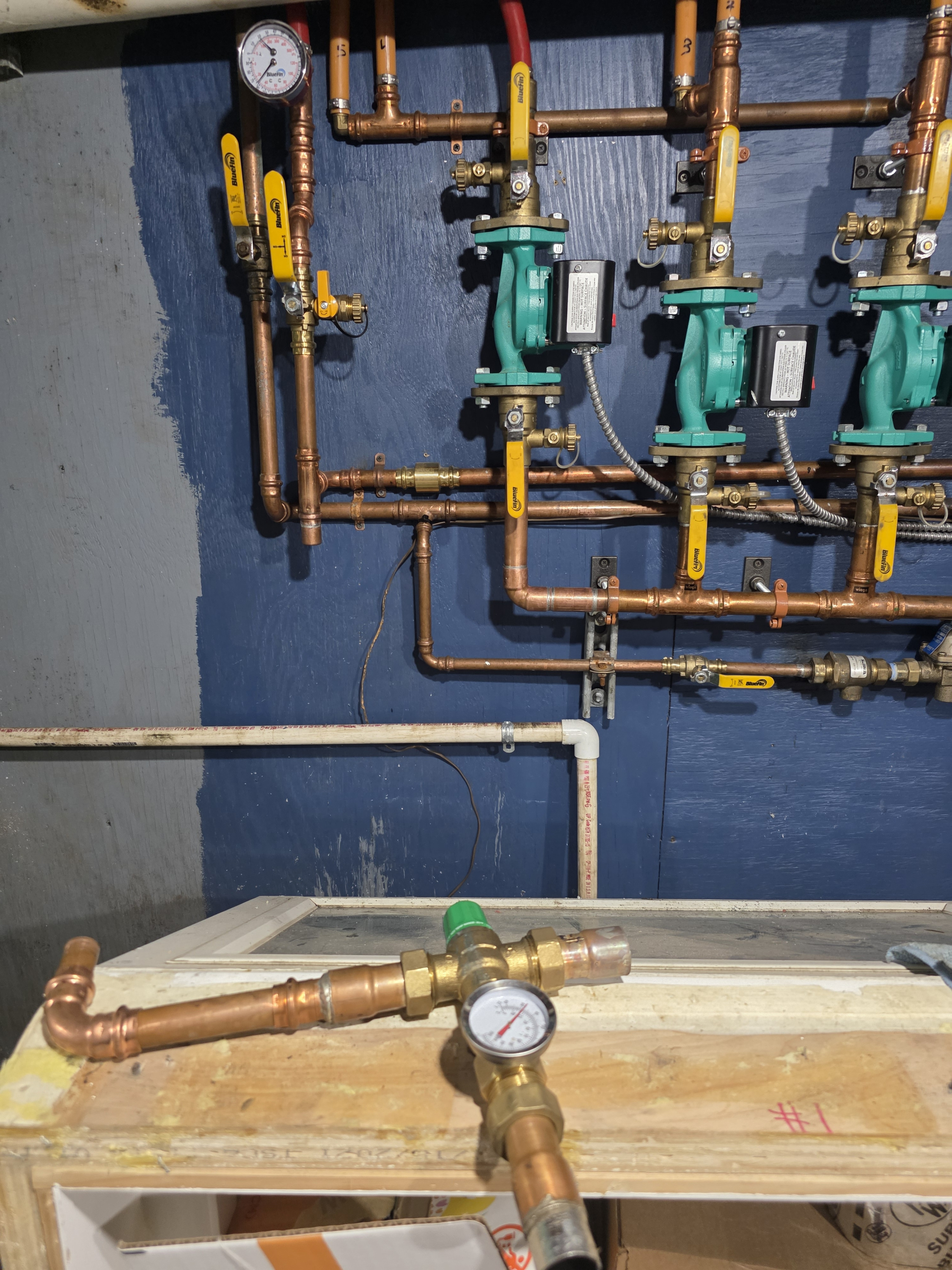

  • I understand. Do you believe a larger circulator pump might be necessary due to the head pressure? I have approximately 900 linear feet of piping in total. Is it possible that the pump is undersized, which could be contributing to the significant difference in Delta-T?
    The circulator pump I am currently utilizing for this radiant loop is a Wilo Star 21. My boiler is a Navien model NCB-250/150H.
    I have been conducting some research and have gained some understanding regarding GPM and head pressure. I am considering whether it would be more beneficial to keep the mixing valve and operate the system at a lower temperature. I'm guessing a good pump size will give me the right Delta-T. I suppose I'll just have to deal with the system as it is, instead of having warm floors.
    What size loops and how long are they. How many loops?
    Typically around 1/2 gpm per 1/2" loop 250 -300' max length.
    So the number of loops X 1/2 gpm = the total gpm the radiant needs.
    Lets assume 10 loops, so a 5 gpm total gpm
    With a 2.3 Cv valve flowing 5 gpm, the pressure drop is around 11' head. That is about the high side of flow through that mixer
    Here is the Star 21 pump curve. Enter the bottom at 5 gpm, run up to see about 17' head. So you should have plenty of pump for 5 gpm or so. If there is more restriction in the piping, that drives head up, gpm down.
