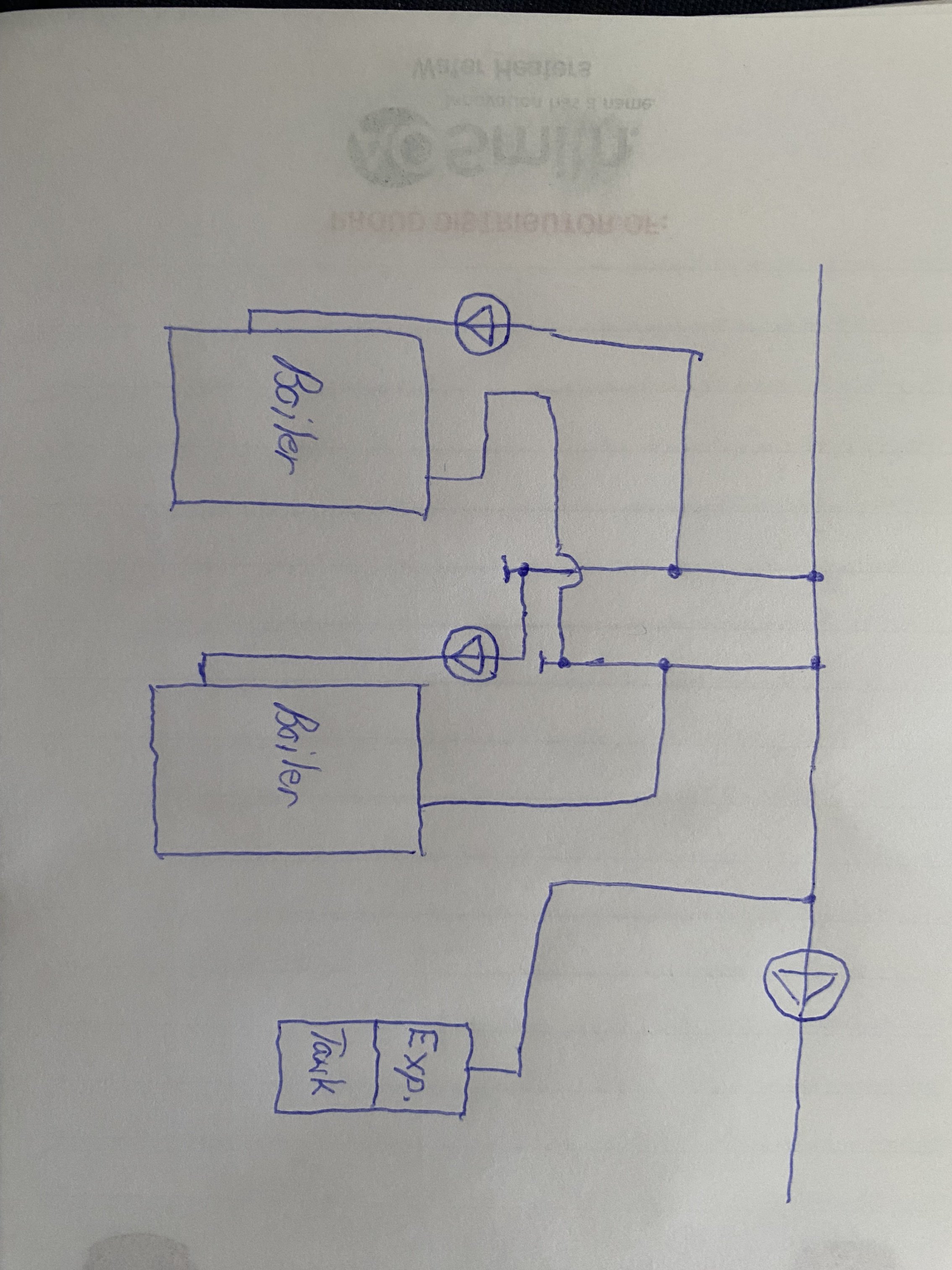

When this heating season ends in a few months I'm going to try to implement @EdTheHeaterMan 's good suggestion to repipe our 4-unit condo building's two WGO-5 hot water boilers as primary/secondary. The existing setup has one boiler heating the #7 side of the building, and the other heating the #11 side. Both boilers are massively oversized, and either one could heat the entire building by itself. On a design day, the entire building could be heated with an input of 0.7 gph, and they both now run at 1.2 gph each.
Repiping as primary/secondary would allow us to run just one boiler and leave the other idle. We could switch over annually to alternate the boilers and thereby extend their lives. They're already 30+ years old but still could have another 10 years in them. Then if one boiler fails, the other boiler is available as backup. Eventually one or both boilers would be replaced, and the primary/secondary piping would already be in place.

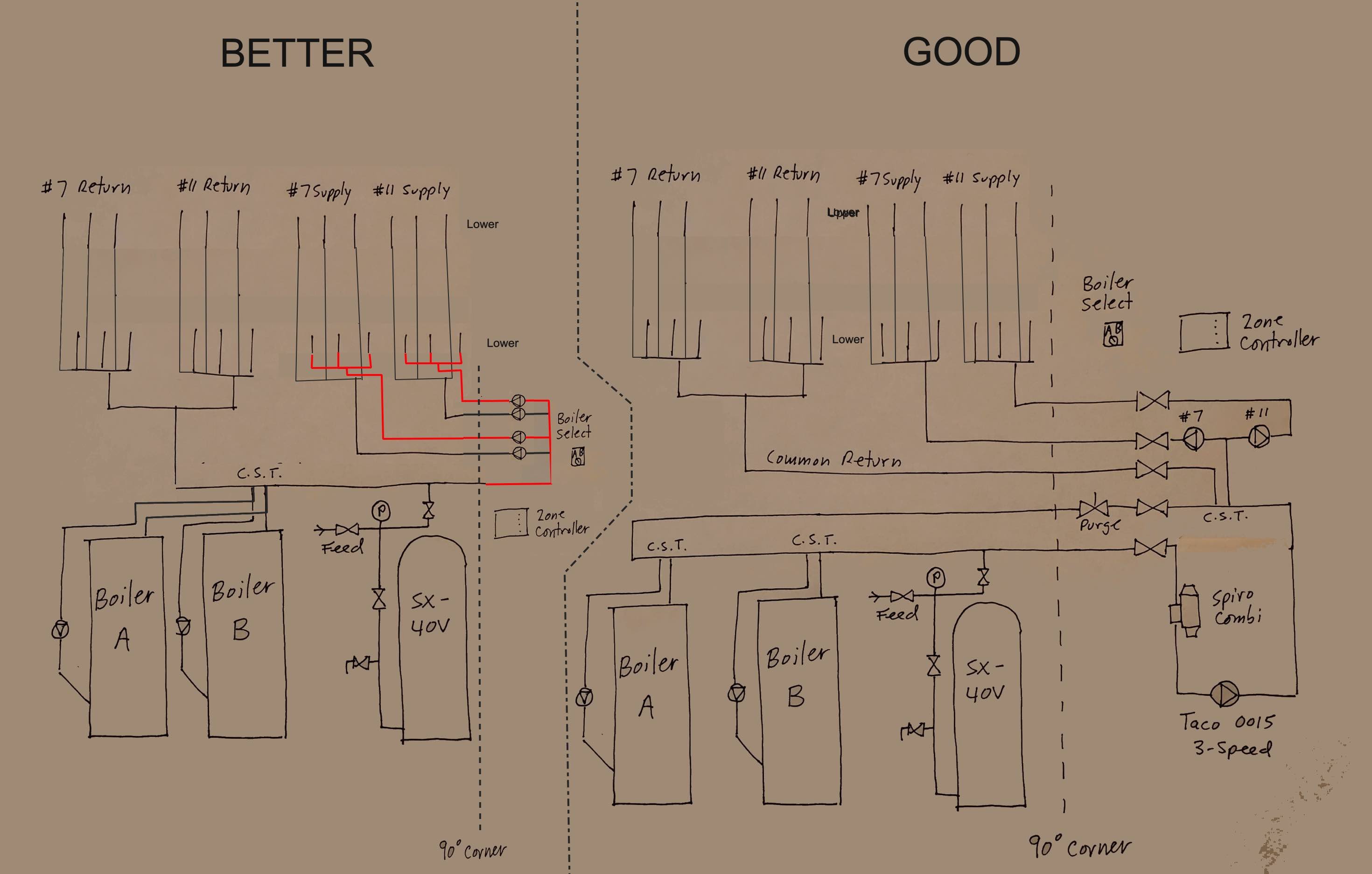

Following is a proposed diagram based on what Ed drew for me a few years ago. There's not enough room above the boilers to fit all the primary/secondary piping, so I would run the primary loop around a 90 degree corner beside the boilers and put a plywood mounting panel there with more room for all the pumps, etc.
If this looks reasonable, I will start planning and trying to convince the other owners to spend the $$ to implement. I already tried once and they balked, but I'm going to try harder this time and sell the benefits of not having to replace a boiler when one conks out because we'll have a spare capable of heating the entire building.
The zone controller would run the primary and secondary circulators. The boiler aquastats would run the boiler circs, as is the case now. A selector switch would direct the zone control output to the desired boiler, and the following year we'd switch to the other boiler.

    Ironman Member Posts: 7,898
    Not like that. That puts the boilers in series.
    Like this:

    Thanks, @Ironman. The logic of the series arrangement is that the boilers will never be run simultaneously. The selector switch allows only one boiler to be run at a time, either A or B but not both. In which case, the series piping shouldn't matter?
  • Ironman
    In that scenario it wouldn’t matter, but what about down the road when they could be cascaded with two properly sized boilers?
    There’s really not much different in what’s involved to do them p/s parallel .
    Bob Boan
  • jesmed1
    jesmed1 Member Posts: 1,418
    @Ironman OK thanks, we can do that. Is everything else OK?
    EdTheHeaterMan Member Posts: 11,911
    I thought of that also @109A_5, However in the future, you may want to replace a failed boiler with one that can handle only 60% to 70% of the load.  Then you can save even more on 85% of the winter months.   Only when the “new smaller boiler” can't handle the load will the original boiler be turned on, and the new one turned off.   Eventually you will have two boilers that can only do 60% of the job when the second original WGO fails, and you have two smaller boilers that only need to operate together for 15% of the heating season. Now that will be a more cost saving system that you can plan for.  And the P/S piping for two boilers operating at the same time will already be in place.
    Try to plan ahead with options. And you don't lose anything in the process.   You are doing the same thing on the system side of the loops. Why not on the source side?
    Eventually you may get the other 3 unit owners to seporate the first from the sedond floors so each owner hat their own thermostat. That can be done easily when you do the repipe this summer as part of the boiler repipe job.
  • jesmed1
    @EdTheHeaterMan OK thanks. So I see the logic of piping the boilers together as @Ironman showed. We can do that.
    I also understand your proposed repiping to separate all 4 units, but that's not going to happen because all the large-diameter gravity piping has takeoffs for both upper and lower units all around the basement. We'd need to rip out and repipe all the large diameter piping, and that would cost mucho dinero. With ecobee thermostats in the lower units and remote wireless sensors in the upper units, our temperature control is surprisingly good and everyone is happy with their units temps.
    So I think the plan going forward will be to repipe the existing boilers P/S as planned with Bob's improvement, and then that gives us the flexibility to run either or both boilers in future.

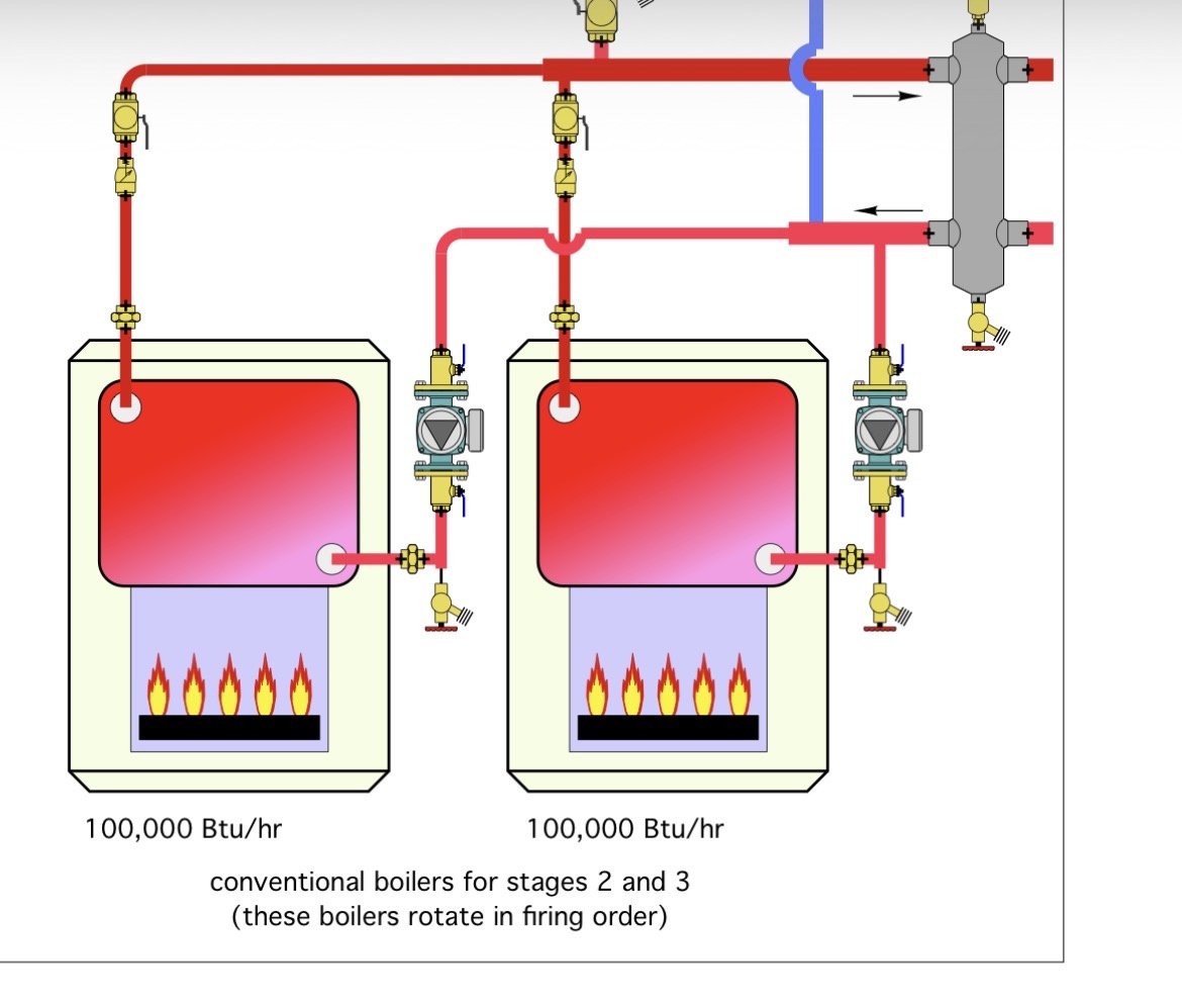

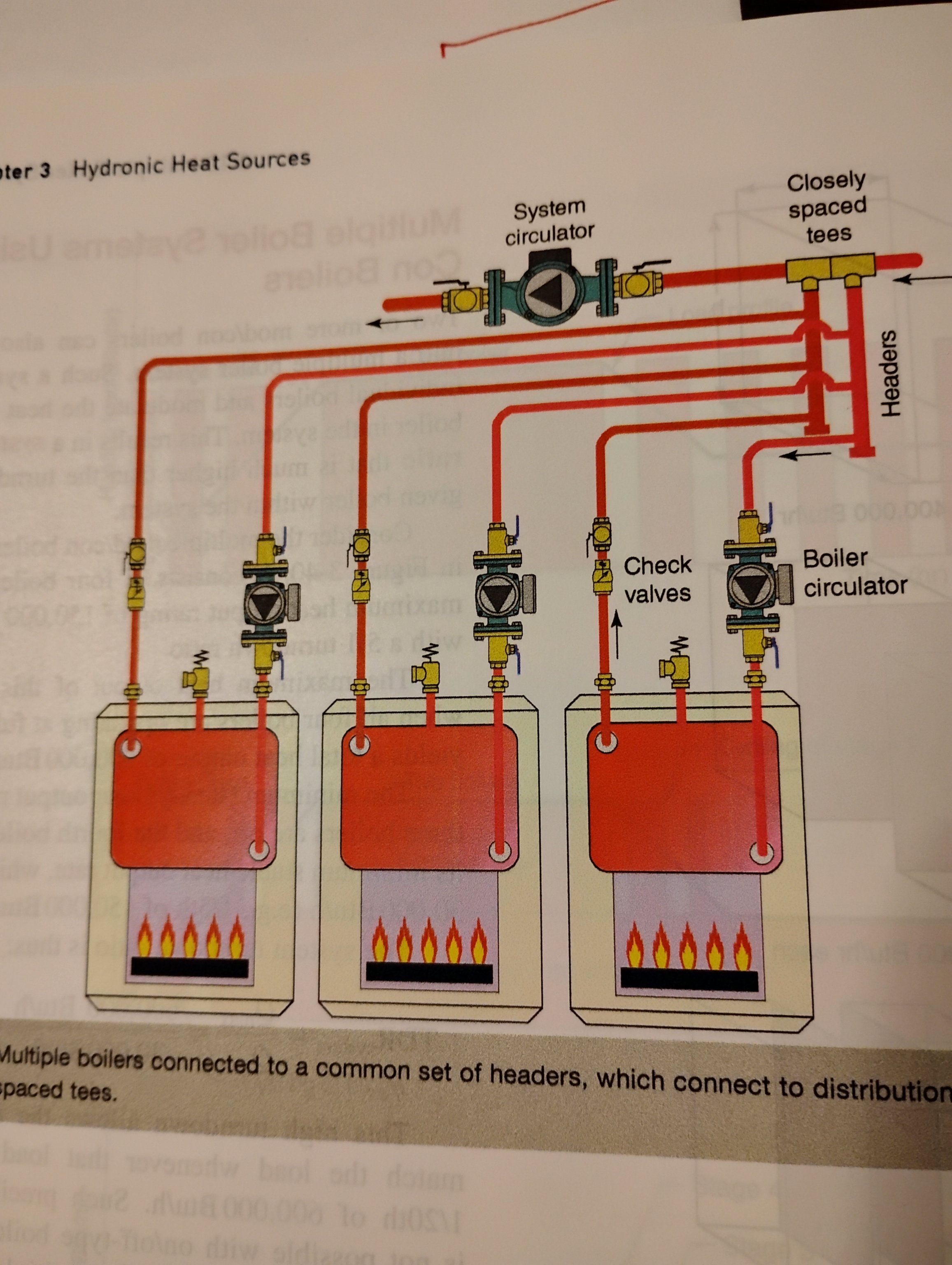

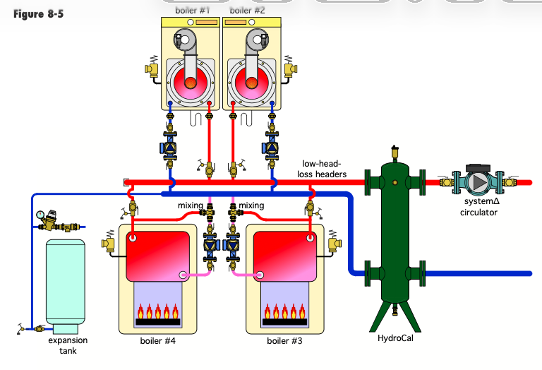

    hot_rod Member Posts: 27,205
    Two high temperature boilers for a zoned system?
    Here are other options. Really no need to P/S as you will get temperature blending at the closely spaced. So you will be blending down the 180 boiler temperature to the zones depending on the various and changing flow rates.
    Parallel boilers, the first drawing, is a common option for two like boilers. Very simple piping. You could add a boiler stage control and chose lead/ lag, equal run, or alternating functions, and ODR.
    If you want p/s, a hydraulic sep, fig 8-5 makes a lot of sense for air, dirt, magnetic and hydraulic separation in one device. But you still get temperature blending in the sep.
    Separators are ideal with different types of boiler, hybrid piping, with different or variable flow rates. Or if you need multiple temperatures.
    The example in 8-5 shows a variable speed circ for the distribution. It modulates based on zones calling, keeping flow rates consistent with the loads. That would provide the best distribution efficiency, never over=pumping the system side.
    Screenshot 2026-02-16 at 10.32.06 AM.png Screenshot 2026-02-16 at 10.30.58 AM.png
    @jesmed1 said:  We'd need to rip out and repipe all the large diameter piping, and that would cost mucho dinero.
    and that is not necessarily true.  If you look closely at the diagram, you will see the red piping is all that needs to be changed to zone the first from the second floor.
    You leave ALL the old pipes from the return and All the pipes from the supply.  All you need to do is to disconnect the first floor radiator supply pipes from the large supply main.  Plug those openings.  Run a 1” copper supply from the 90° corner to the radiators that you disconnected. Connect those radiators with ¾” PEX to that copper main.
    How many radiators are we talking about?  5 or so from each side?  Not such a big piping job at all.
    That is a lot less piping than the project you are talking about.

    @hot_rod Thanks you for those other options. The first would be easiest. Would we then use zone valves?
    Also, these are cold start boilers with low temps, rarely exceeding 140-150 SWT. I am wondering what happens when one zone satisfies, then the other zone that's been cooling off for 3 hours calls, and 100+ gal of cold (65-70 F) water hits the boiler that just ran 45 minutes and finished at 140? Does that then require a bypass with a mixing valve?

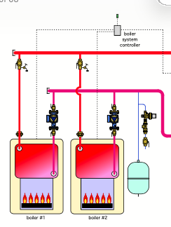

    This is Siegenthaler's version of @Ironman 's piping. Ironman has the boiler connections to the short headers alternating. Siegenthaler has them not alternating. What's the advantage to having them alternating?

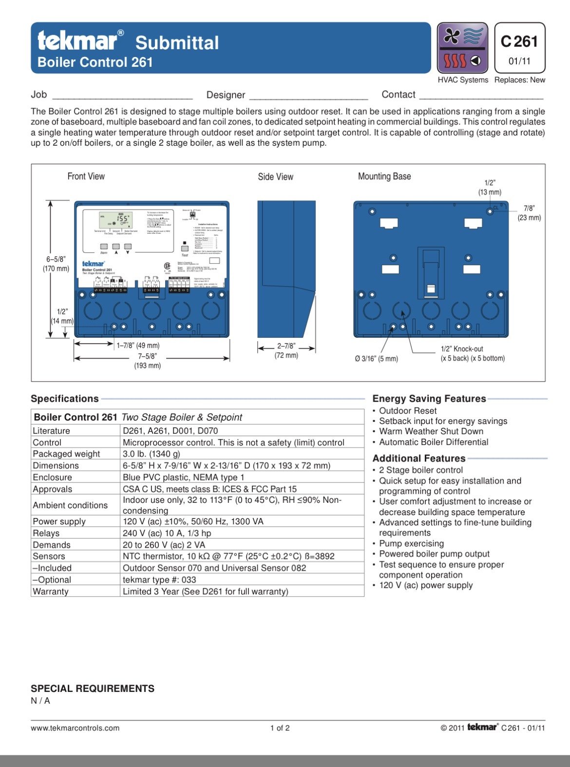

    A stage control like this would manage rotation and ODR
