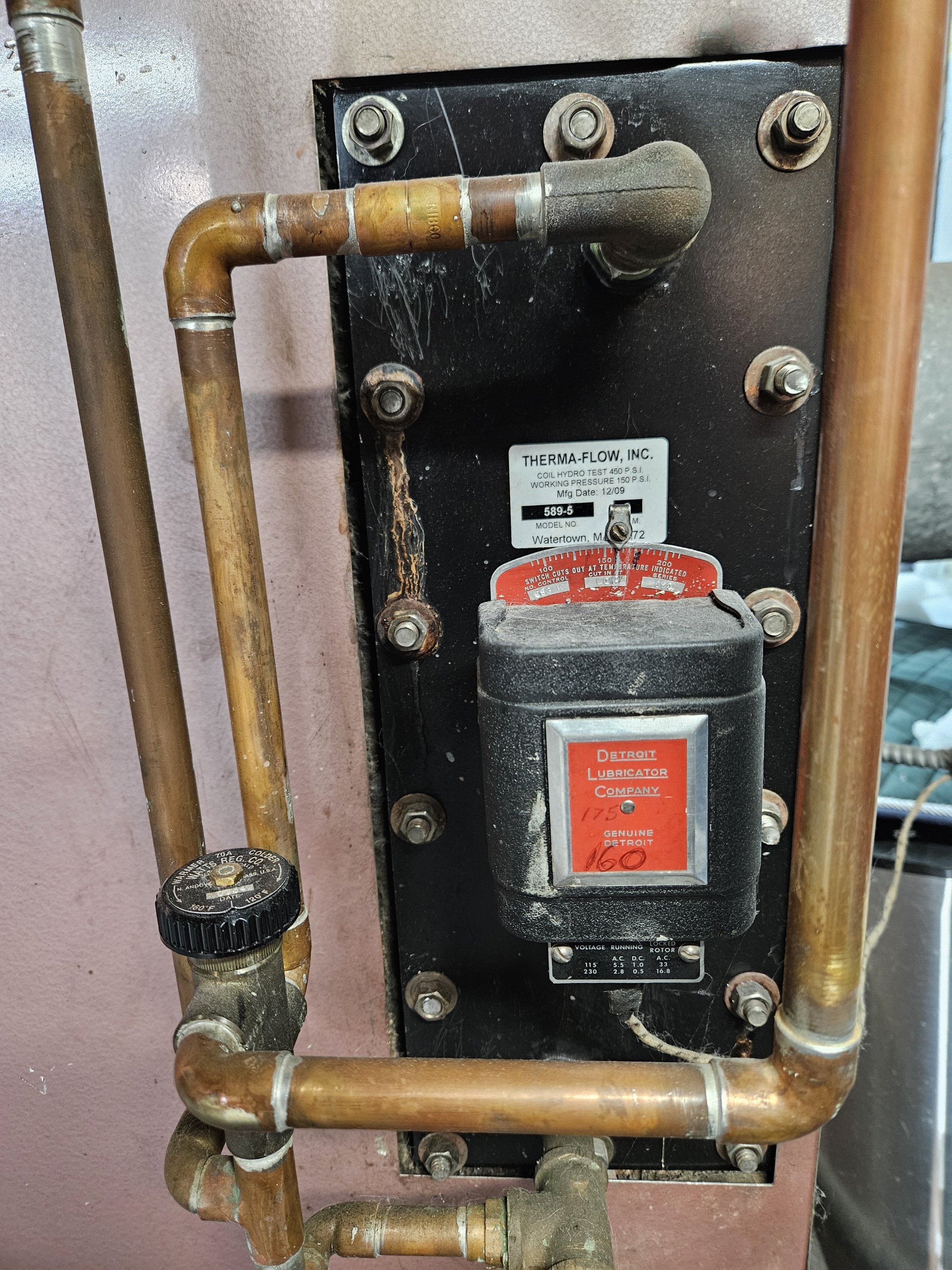

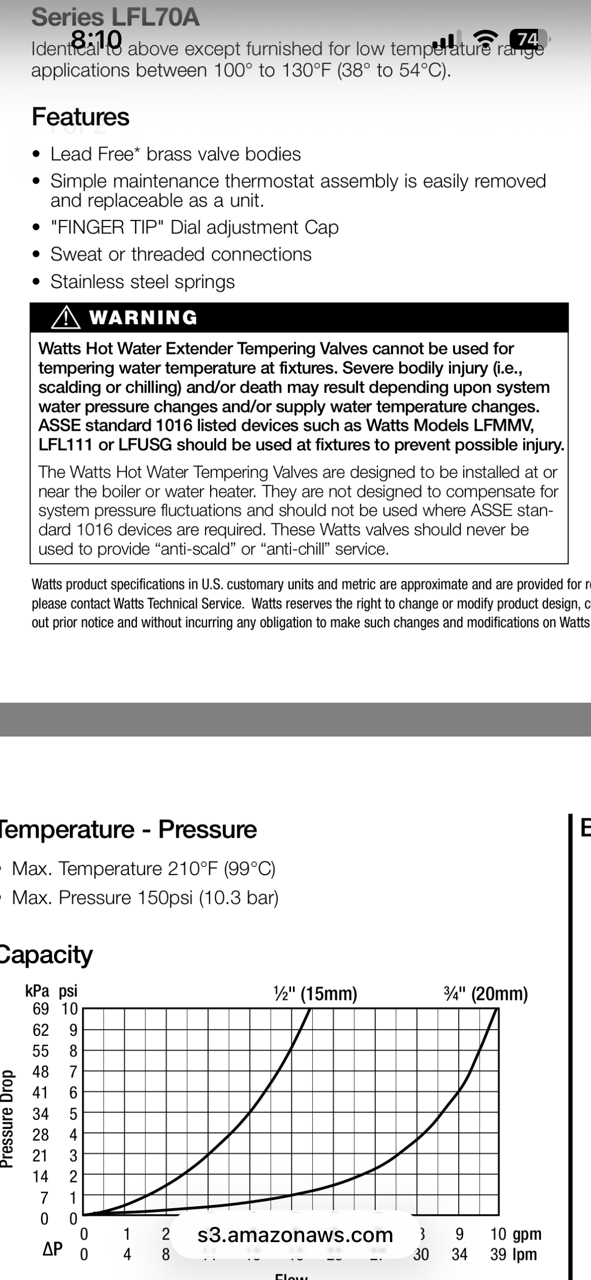

    Thanks For the info guys. The thermostatic mixing valve - if thats the black knob on the bottom left, then yes, not turning. Im afraid of breaking it. It wont budge.
    <Edit> - yes that's the Thermostatic valve according to Google. Any suggestions on unsticking it? My first thought is heat but given the solder, I dont know, and don't think that'll work for scale build up <end edit>
    Any good way to test the aquastat? When I was talking to our oil guy, he said they made a line at black line and the current used mark. He said one was set for hot weather and one for cold?
    The potable water side coil cleaning. Whats the process? Like flushing a heater core/radiator with cleaning solution in one and out the other, or unbolting those7 bolts and taking out the unit?

    Another control is attached to the coil flange plate
    1. Operator control is installed in the coil flange plast as you have pictured may not be inside the boiler jacket

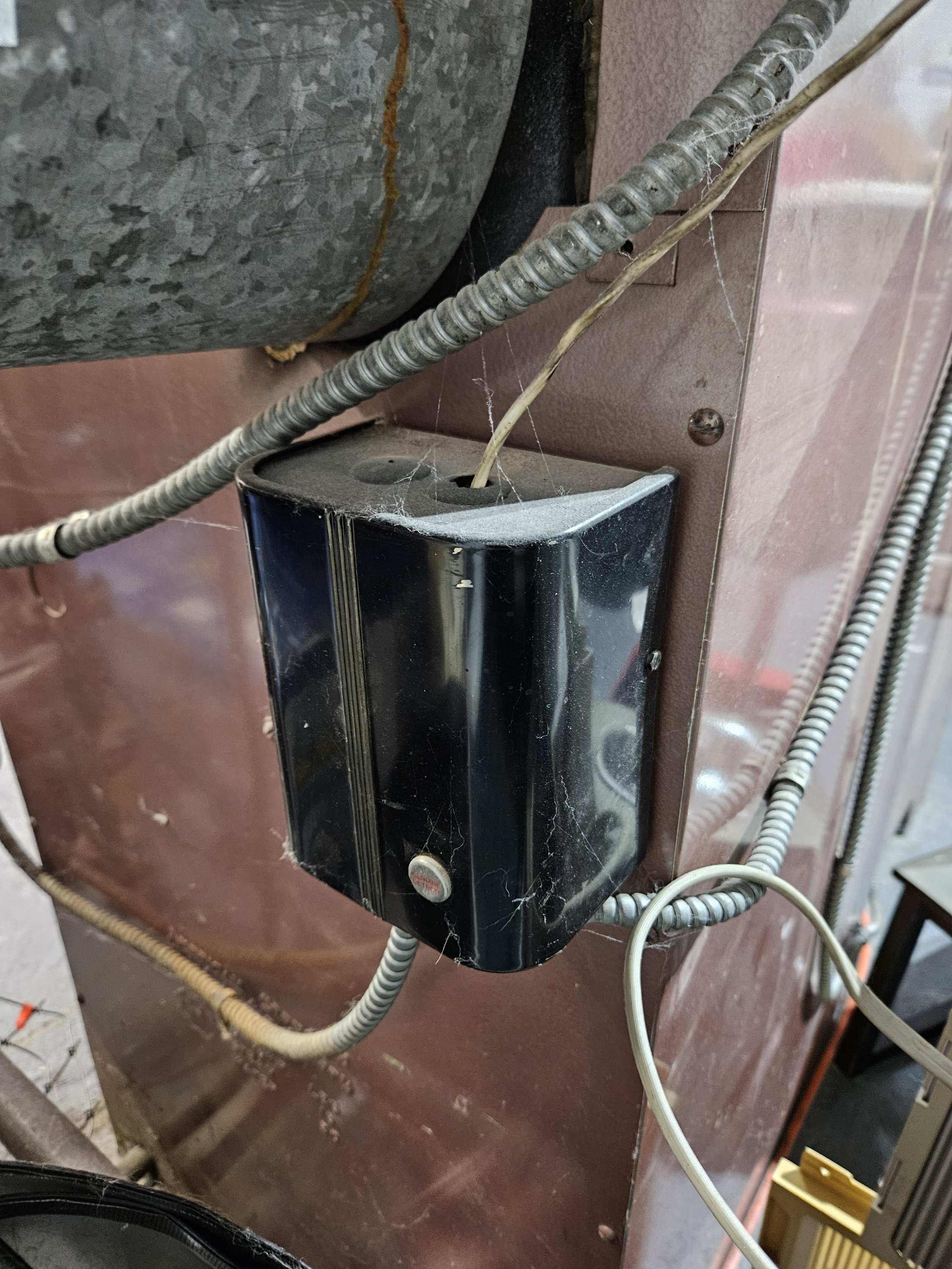

    Circulator Realy
    The thermostat is usually connected to this control. The burner is also connected to this control and the circulator pump is connected to this control
    On a call for heat the burner will operate as long as the water temperature in the boiler is belos the high limit setting
    On a call for heat the circulator pump may operate as long as the boiler water temperature is not below the minimum reverse temperature control setting

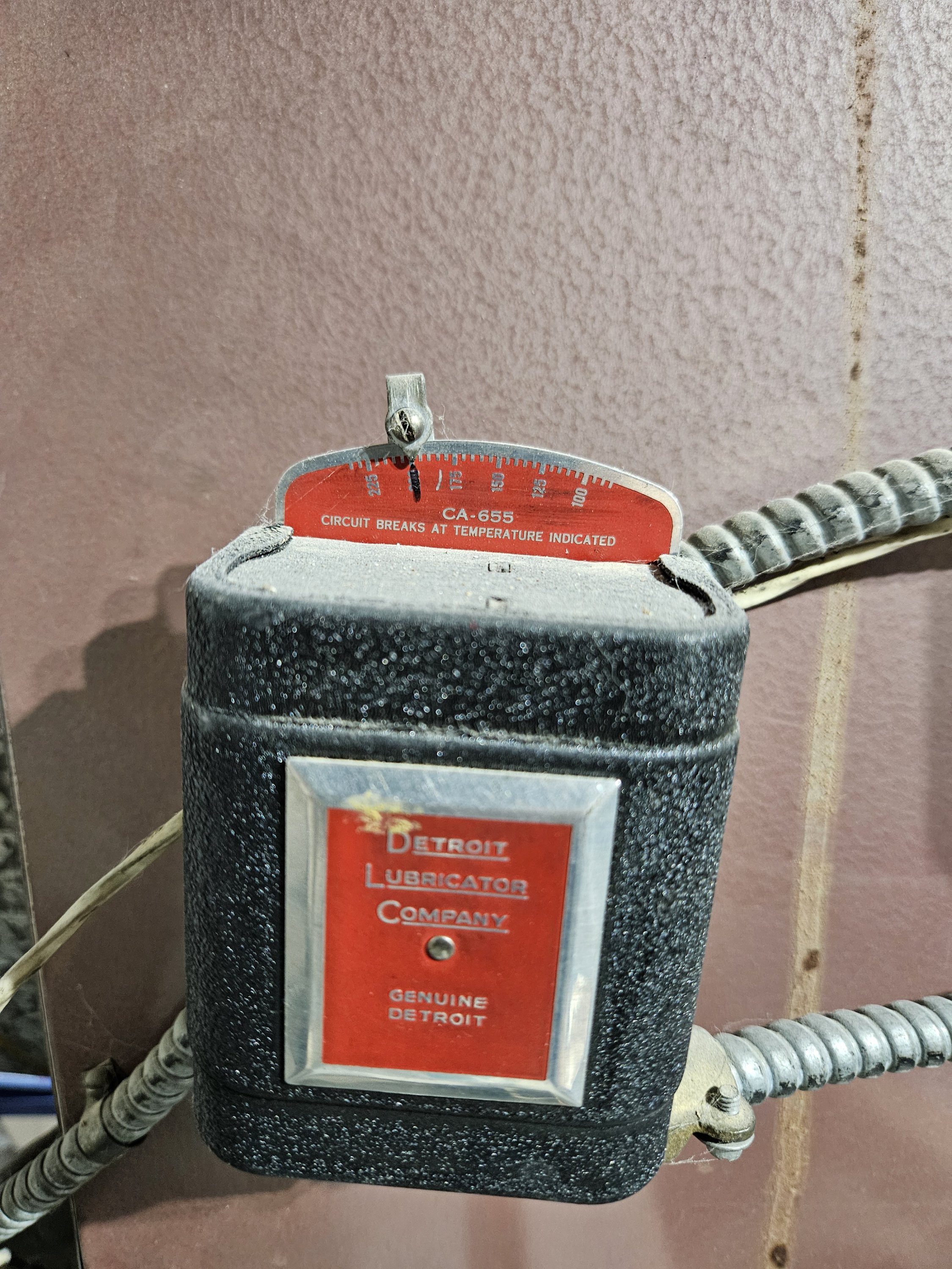

    Operating Control (Tankless Coil Control)
    The operating control is usually installed in the tankless coil flange plate.
    It operates the burner in a similar way to a thermostat, but it only controls the burner — it does not operate the circulator.
    It typically maintains boiler temperature between 150°F and 160°F:
    • Burner cuts in around 150°F
    • Burner cuts out around 160°F
    This keeps the boiler hot enough year-round to provide domestic hot water.

    Hi, About that tempering or mixing valve… Have someone run water while you feel the cold supply to that valve. If it cools down when water is being run, you know it's cooling down the hot water. Also feel the outlet of that valve and see what sort of temperature you're getting. If it's too cool for showering, that's a problem to fix. Those valves can be taken apart with Channelock type pliers by grabbing the ribbed brass piece which is directly under that black knob. Inside on a spring, is a wax driven element which often sticks open. You can get by with a squeeze of the pliers to depress the rod some back into the copper body. Use a little teflon tape on the fine threads of the brass piece before putting it back together.
    Yours, Larry
    This is the install and maintenance instructions for that valve: Watts 70A valve and this is the replacement temperature sensor: Watts 70A Repair Kit.

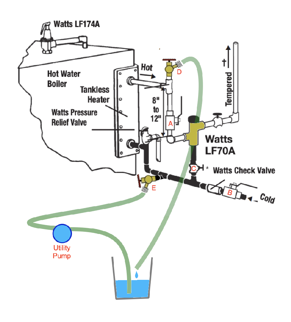

    That will involve adding some valves to that coil so you can pump a cleaning chemical (mostly vinegar) thru the coil for about 30 minutes. That procedure is done with the coil in place on the boiler so you do not need to remove it.
    Piping diagram to follow:

    More and more states are requiring ASME 1070 listed mixing valves on any water heater
    If you do a repipe to add flush valves, consider upgrading that mixer. It may not be much more $$ than a rebuild kit for that hw extender valve
    EdTheHeaterMan Member Posts: 12,084
    This is the piping arrangement you ahould be looking for. You should already have Valve B. You may need to add Valve A and C. Then you must add draw off valves (also called boileer drain valves) D and E and get an inexpensive utility pump. We used to use a really economical pump that you attach to an electric drill.
    Close valve A B and C then attach hoses as shown to D and E and open those valves. Pump the cleaning chemical thru the coil for about 30 minutes. Then close E and open B to flush out the chemical. close D whan the water runs clear and open A and C. You should be good to go.
    Agree with @hot_rod on upgrading to a ASME 1070 listed valve while repiping for the flushing valves
    Havent found anything indicating another temp settings for reverse control. The other possibility is this
    Thanks Larry for the advice and instructions. I went ahead and tested. Water has not run in a couple hours. I touched the output from the mixing valve and it was a light warm. Went to turn on the hot water and got hot and stayed hot. Going to be taking a shower later on to see what happens.

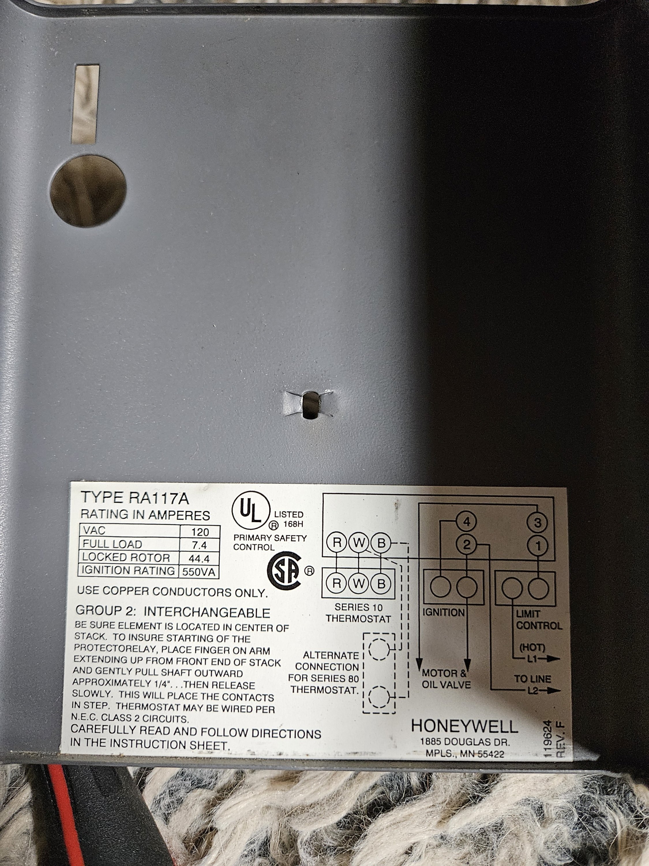

    WOW… you still have an RA117A primary safety control? That is obsolete and has poor safety performance. You should think about removing that from the system completely if it is still connected. Replce it with a much safer primary safety control like the Carlin 70200 PRO. It is a much safer control for your oil heat system, and it should be installed by a professional.
    The black covered box installed just below the vent connector (smoke pipe) is your circulator/burner relay. The thermostat wire connects tothat control and should turn on the circulator pump and also the oil burner by way of the RA117A primary safety control, Honeywell called the primary safety control a "Protectorelay®". I would strongly recommend upgrading that control. The Honeywell version of the Carlin 70200 is the model number R7184U protectorelay. But I would still recommend the Carlin control because it has the most safety and diagnostic features.
