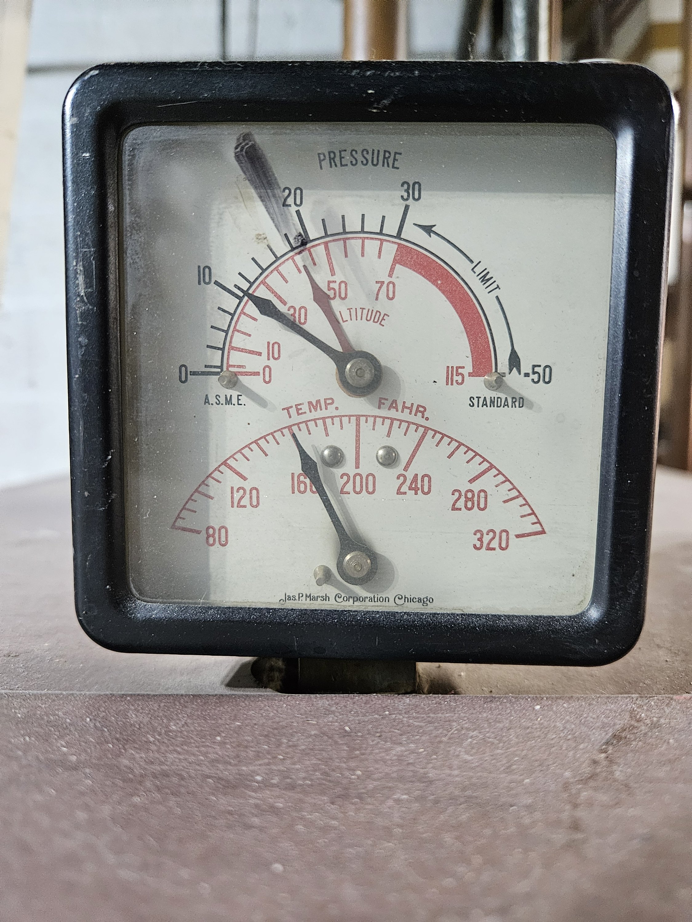

Hi,
Hoping the community can provide some insight on this old Acroliner tankless water system. The last couple of days, the hot water in the shower and sink would start off with the normal hot temp, then few minutes later, the temperature cools.
The pipes feel warm. 1/4 tank oil. Burner has fire, gauge needles havent changed. What could it be? I was thinking its the water sitting in the pipes but for how long its run, it should have already removed it all.
Any ideas?
Could it need a cleaning? Descaling? Also if anyone has any info on how to maintain this boiler, any info is appreciated!
Also, the water hasnt been turned on since 8am-6pm, but this has been a pretty normal routine.

    is the boiler set up as hot water or steam? i'm thinking the boiler is low on water so the coil isn't fully submerged.
    or the low setting on the aquastat isn't working right. or the heat call keeping the boiler at the heating temp was making more hot water

    There may be two things going on here.  The first problem may be that the mixing valve is no longer operating properly.  The second may be that the coil may have some scale build up on the potable water side of the coil.  That will need to be cleaned.  It does not appear to have the necessary fittings and valves in order to do the cleaning, so I would wager that the cleaning has never been done.
    I also believe that the tankless coil is not the original.  Since it may be only a few years old. I would tighten up on the flange nuts in order to prevent the gasket from leaking.  They should be snugged up after 500 hours of operation and again after 1000 hours of operation.  I hope that is is not too late to get that done.

    my bet is on the thermostatic mixing valve sticking.
    the coil looks newer but that aquastat looks original

    Thanks For the info guys. The thermostatic mixing valve - if thats the black knob on the bottom left, then yes, not turning. Im afraid of breaking it. It wont budge.
    <Edit> - yes that's the Thermostatic valve according to Google. Any suggestions on unsticking it? My first thought is heat but given the solder, I dont know, and don't think that'll work for scale build up <end edit>
    Any good way to test the aquastat? When I was talking to our oil guy, he said they made a line at black line and the current used mark. He said one was set for hot weather and one for cold?
    The potable water side coil cleaning. Whats the process? Like flushing a heater core/radiator with cleaning solution in one and out the other, or unbolting those7 bolts and taking out the unit?

    Thanks Ed for this information on how this all works! I think Ive located most of what you mentioned
