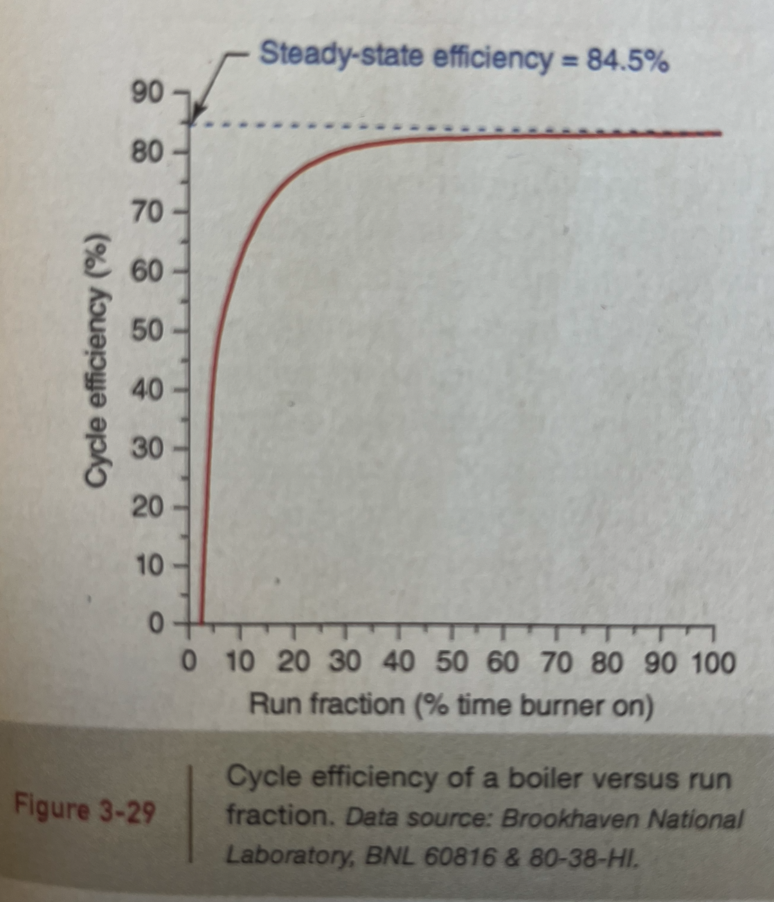

    Most agree a boiler should fire for at least 10 minutes once it lights off. On a design day if everything was sized correctly, it would run non stop.
    The run fraction determines how efficiently the boiler operates
    If you could watch the operation, or record it.
    Run fraction= lets say it runs for 2 minutes, then 10 minutes off
    The elapsed time is 12 minutes 2 ÷12 = .16 or 16%
    The chart below, enter the bottom axis at 16% run up to the red line. The boiler is running 65% or so. A tuned oil boiler should run closer to 83%
    So run your numbers to get a good idea of how efficient the boiler runs.
    The worse number may be on a mild day, when the boiler is most over-sized.

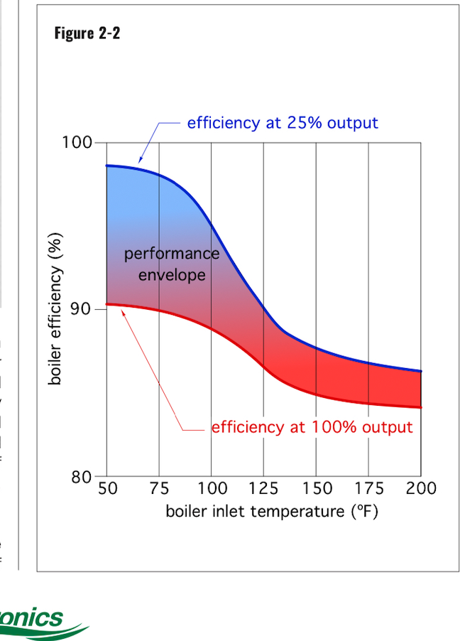

    Combi boilers rock for efficiency. An oversized mod con, (sized for DHW) adjusted to the heat load running 180 swt would be mid 80% efficient, and would not short cycle. The lower graph shows a mod con at 100% and 25% firing. so with a 160° return to a mod con you jump a few points above 82%.4. A gas fired mod con running outdoor reset is hard to beat for efficiency.
