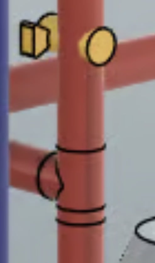

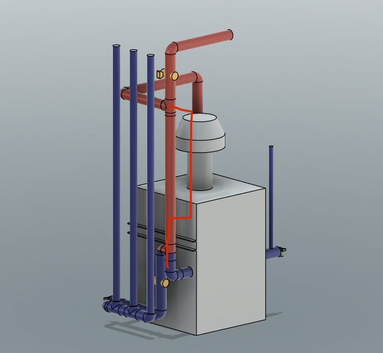

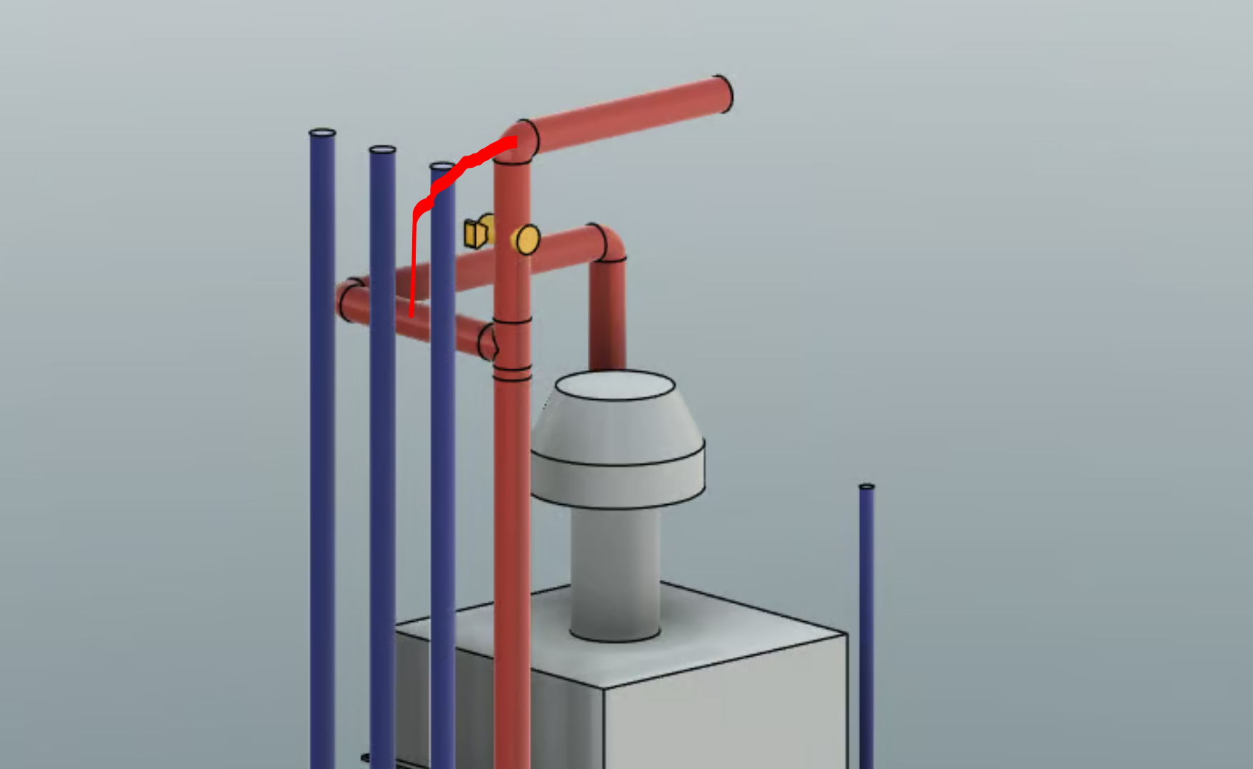

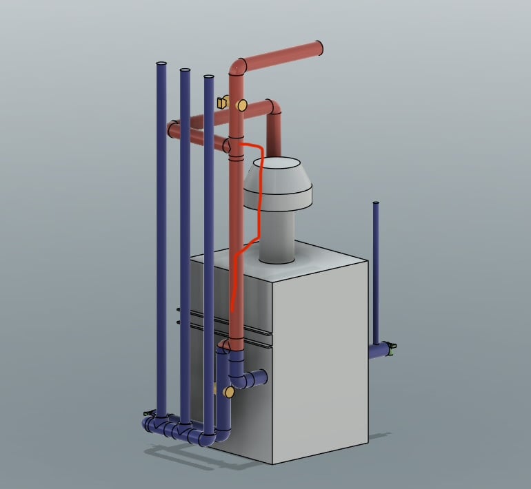

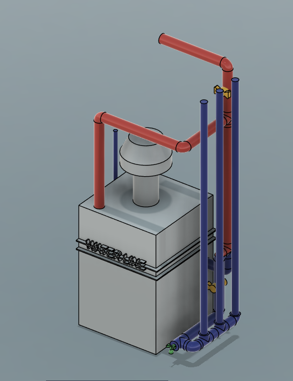

    1261693708758268820.png 346265365521242167.png 1206481286576402385.png 2375424265053123730.png
    The technician and I teamed up to do a CAD of the next pipe rework. Thoughts?
    Any issue with the tee in the equalizer pipe vertical position?:
    mattmia2 Member Posts: 17,563

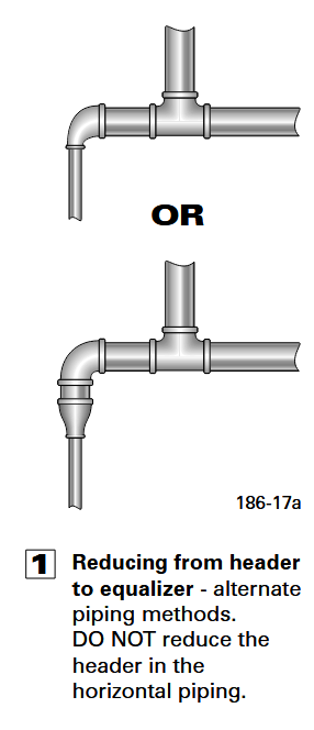

    the header isn't right, the main should connect to a horizontal tee in the header then the end of the header should turn down to the equalizer. the horizontal tee where the main connects encourages any water to continue on to the equalizer. what you have now forces the water to turn when it hits the tee and it will tend to divide between the steam traveling up and gravity pulling it down to the equalizer.

  • markmarlatt
    markmarlatt Member Posts: 106
    edited February 14
    Could we come past the horizontal tee the into an elbow then down into other elbow to keep the placement of the exiting vertical in the picture:
    edited February 14
    you could if you make the offset in the equalizer with 45s so it doesn't have a horizontal section or you make sure the horizontal section has pitch and is above the water line. what would be better would be to use 2 45s and offset the riser to the main if you have the distance to do it. or 1 45 in the riser and turn the ell at the end of the main at a 45.
    109A_5 Member Posts: 4,227

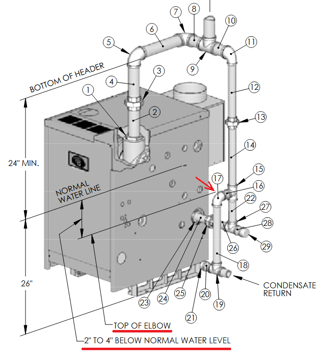

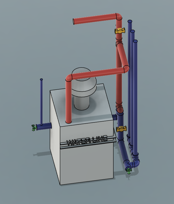

    These are the issues I have with the CAD rendering.
    Maybe the color change is not accurate.
    From a Weil McLain manual.
    you could turn the ell 45 degrees and use a 45 in the riser to do it like this without refitting everything to the boiler to move the boiler:
    your offset in the equalizer would be ok too.

  • markmarlatt

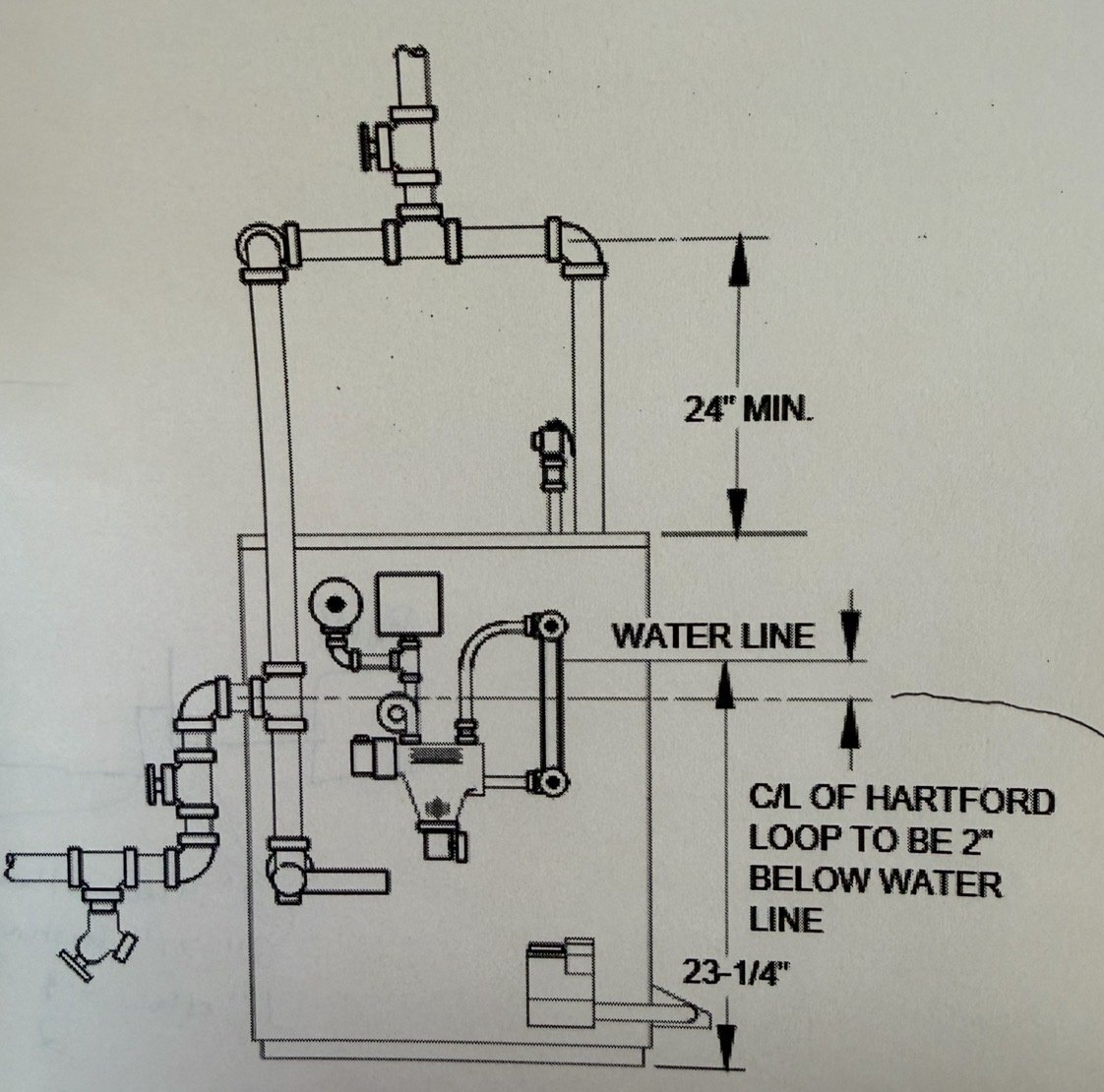

    It’s a color misplacement in the CAD, the elbow is positioned at 2 inches below water line to center of the elbow.
    edited February 14
    Looks to me if your are going to go with the pipe center it would be more than 2 inches. That 2 inches would be to the top of the pipe. I think the idea is the have that short horizontal section of pipe always submerged or full of water within the boiler's usable water level range. If steam can't get in there there won't be any water hammer.
  • markmarlatt

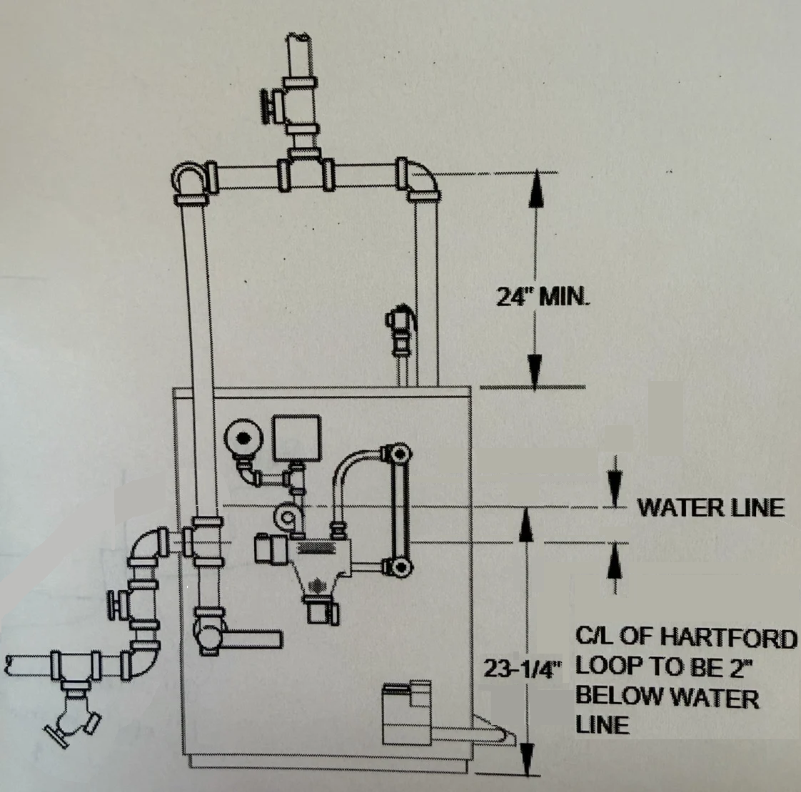

    Interesting, we went from the HB Smith (manufacturer of this boiler) diagram:
    OK, I can't fault you for that. Did you actually measure the 23-1/4" ? The water line in the boiler's drawing seems kind of high the way it is drawn.
    I would have thought it would have been more like this.
  • markmarlatt
    the model in the CAD is not to scale of this boiler as it’s taller. All measurements will be followed per the HB Smith diagrams and documents.

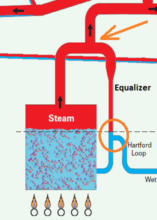

    Captain Who
  • Captain Who
    Captain Who Member Posts: 883
    edited February 16

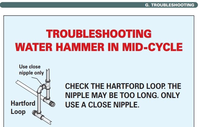

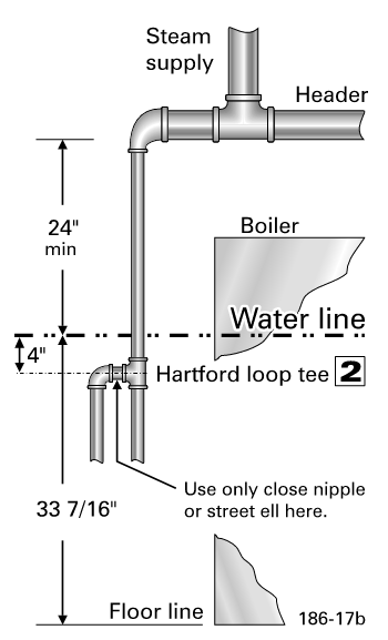

    This just may be Wye the manufacturers prefer a Wye but where can I get one in copper to fix my high Hartford Loop?

    OK so do you think the entire header after the last supply and the rest of the equalizer remains full of air? Or does a gradual interaction occur that removes the air aided by the venturi effect of the steam rapidly flowing through the last supply remove that air? Why do you think hammer doesn't occur early in the cycle but tends to occur mid cycle?
    ethicalpaul Member Posts: 8,933
    edited February 16
    there can be some mixing (even though I’ve read they don’t mix). But by then the water is pretty warm and shouldn’t be hammering anyway. There’s no hammering in the main for example, even though it has condensate running all along it.
    And regardless of the height of the Hartford loop if there is steam down there, it will contact the water, and yet there’s no hammer so your high loop may not be the problem.
    Some consider it a feature. Ignore the incorrect diagrams showing that system pressure causes water to rise at the end of the main, just like in those otherwise good peerless diagrams that you post.

  • Captain Who
    edited February 17
    @DanHolohan says:
    "Steam rises up through the equalizer, just as it does through the boiler sections. When the relatively cool return water meets that steam at the close nipple, the rising steam bubbles quickly condense. Naturally, the return water rushes in to fill the void left by the collapsing bubbles, and this creates a slight water hammer inside the tee connecting the return to the equalizer."
    EBEBRATT-Ed (who's been around forever) @EBEBRATT-Ed said it well: 'Steam goes down the equalizer until it hits water. The air rises up and goes out with the supply steam. If the equalizer stayed full of air it would be cooler and they are always steam hot."
    The venturi idea was sort of my own and may be not the main effect here actually. But as the steam bubbles in the boiler can pass out through the return nipple into the equalizer they will naturally rise within that column, being lighter than the hot condensate and when they reach higher up and cooler strata they will implode, shrinking in volume and creating mild hammer which is probably inaudible. But this collapse in volume, along with the steam pressure in the header will cause steam to flow down towards the Hartford Loop within the equalizer displacing the air and pushing it out up through the header, into the main. This steam is also condensing which further pulls more steam in to make up for that.
    Then later in the cycle, like mid cycle, you can get an audible hammer in that nipple of the Hartford Loop, if it is long enough to allow enough velocity from the acceleration, but it is again due to the implosion of trapped steam between water waves, and only if the water level in the equalizer is low enough.
    Even if there is no problem mid cycle, there can also be late cycle water hammer in the Hartford Loop that can happen later in the cycle when the water level drops too low. From Dan:
    "If [the water level] drops below the close nipple, steam will push down through the equalizer, enter the wet return and create water hammer. This usually happens near the end of the firing cycle, and it causes a very noticeable racket."
    "Check to see if the water level in the boiler can drop to a point where steam gains access to the wet return through the boiler's equalizer. If it can, the steam will quickly push down into the wet return and create water hammer. This usually happens toward the end of the cycle."
    Peerless Boilers:
    "WATER HAMMER ON SHUTDOWN... CHECK THE HARTFORD LOOP. THE NIPPLE MAY BE TOO CLOSE TO THE BOILER WATER LEVEL. IT MUST BE 2 TO 4 INCHES BELOW."
