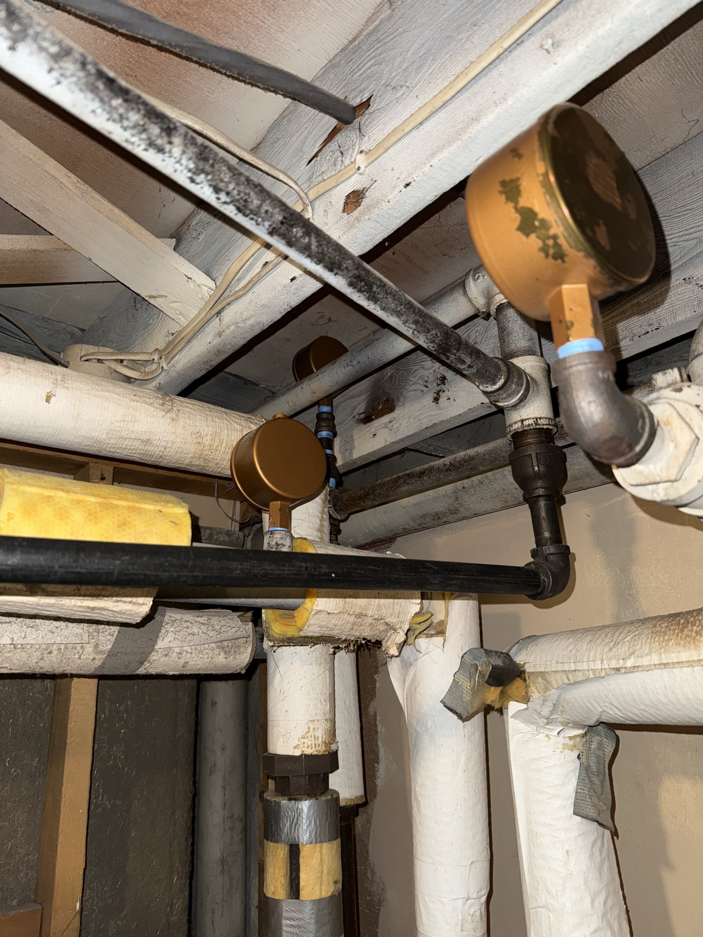

Today return piping at boiler was corrected and vents added to other steam leg and dry return:
Two hours of running the the system heats quickly, no water hammer and the pressuretrol is working correctly. The old piping had severe build up as pictured.
Still a few adjustments to make but the system is finally operating near correct. Many thanks for all the input and knowledge!

    mattmia2 Member Posts: 17,223

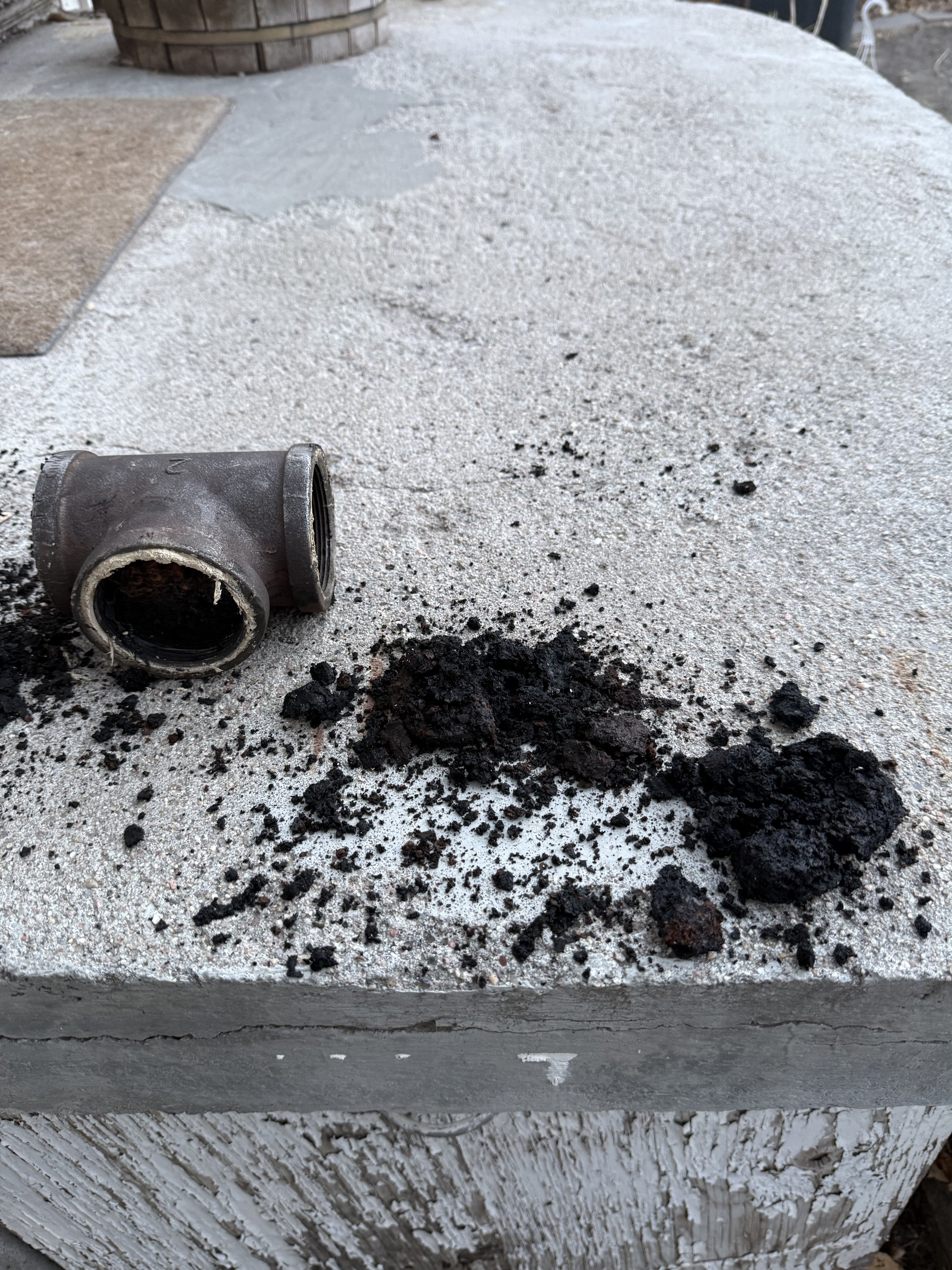

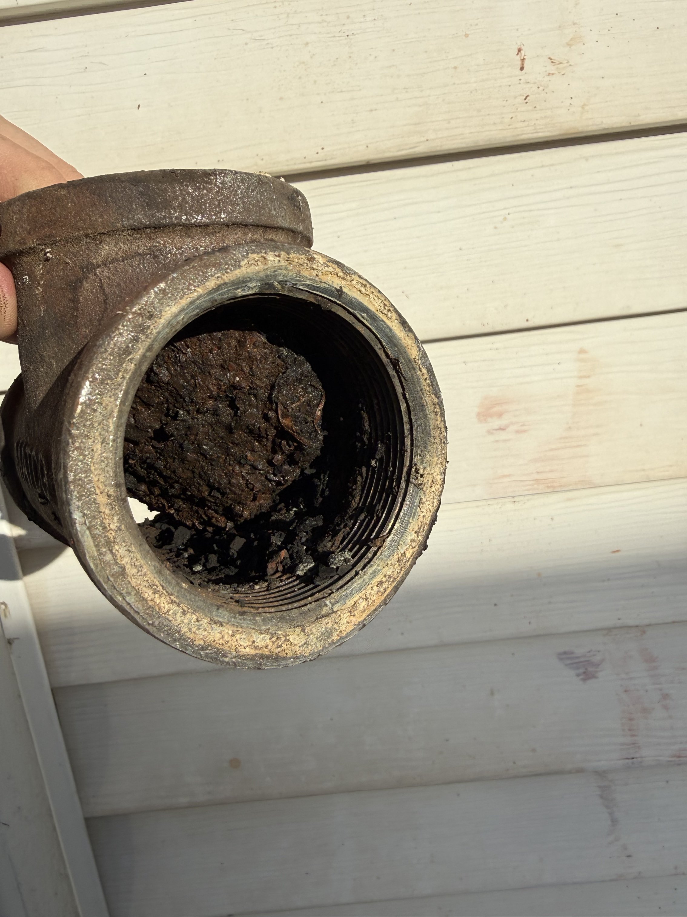

    i would like to see an autopsy of whatever that is blocking the tee. it could be scale that came loose from somewhere but it kind of looks like a piece of sheetmetal or something that got in there or came loose from something somehow and got plated with rust.
  • markmarlatt
    markmarlatt Member Posts: 106
    Lots of build up:

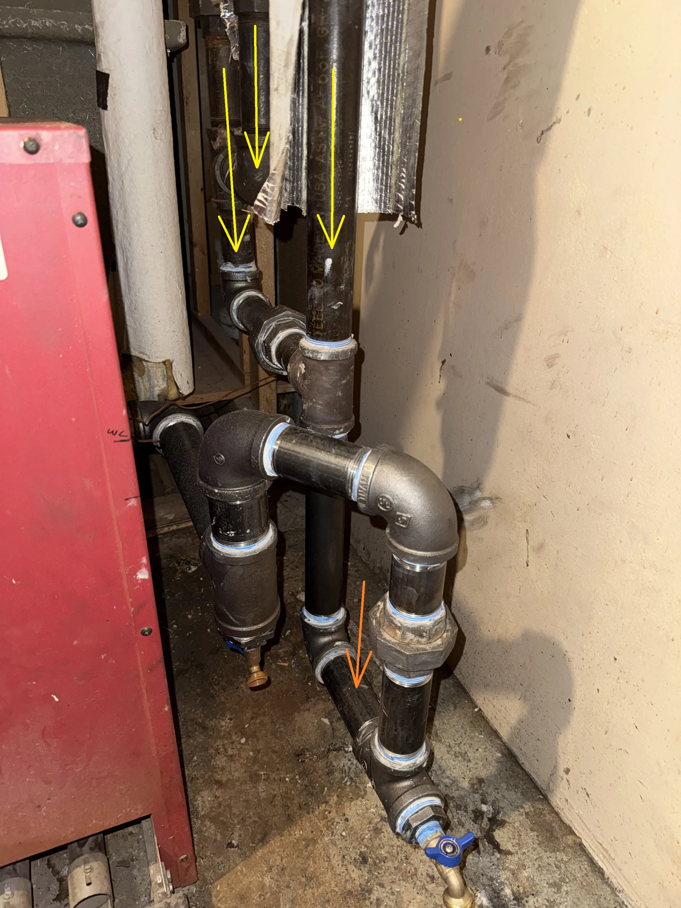

    109A_5 Member Posts: 4,160
    edited February 11
    Well I'm glad to hear it appears to work better. Probably not being clogged up may help.

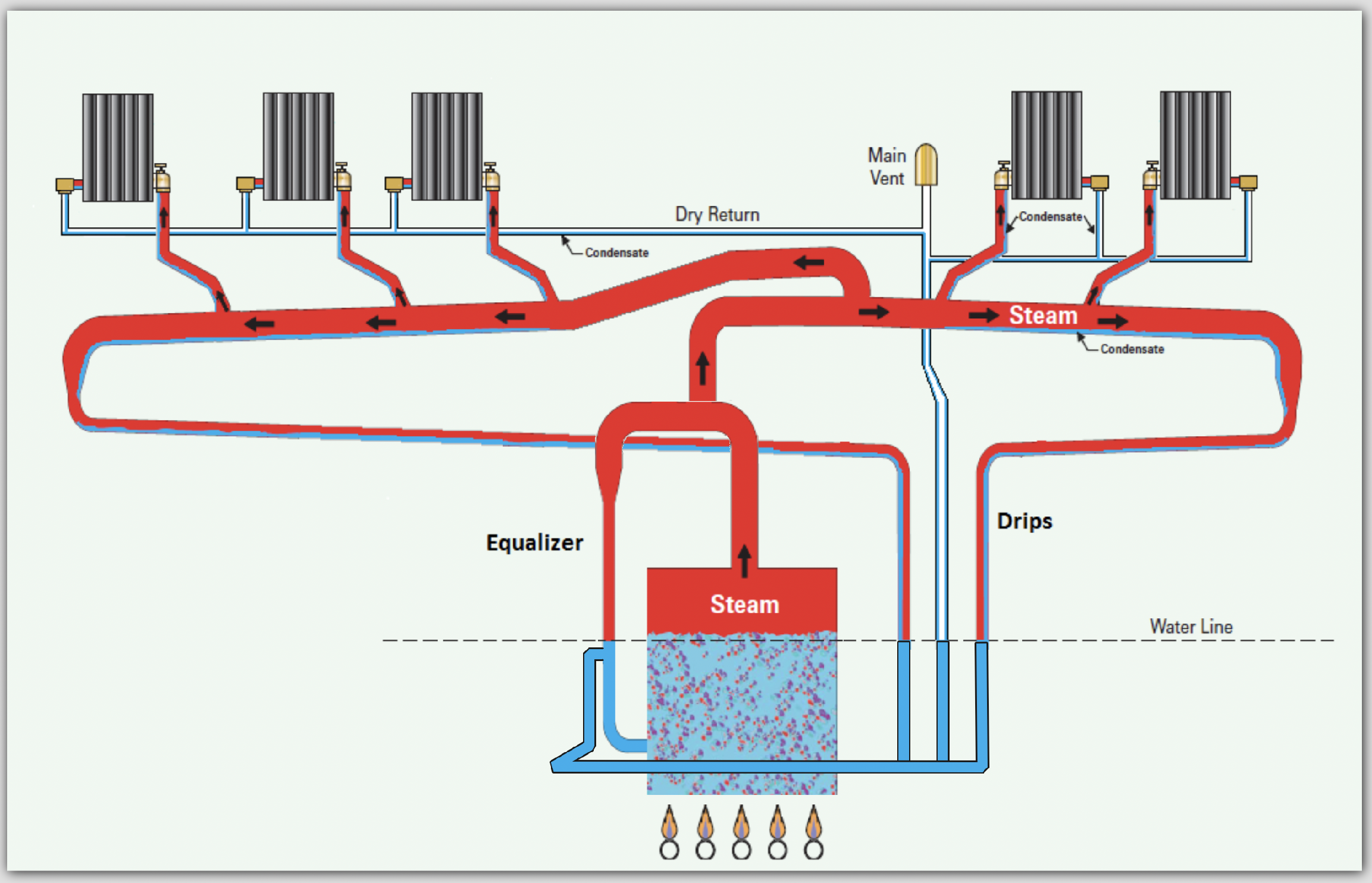

    However we clearly failed with the other thread !!! So I will try again. Since I'm not sure where it all went wrong.

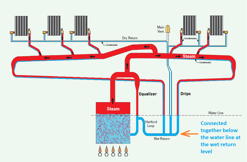

    All three vertical pipes (Yellow arrows) should be Teed together at the level of the wet return which is at the level of the pipe at the Orange arrow, all Tees well below the water line. Also the (kind of) Hartford loop is kind of useless since it looks like the equalizer is not connected to it. So if there was a leak at the level of the Orange arrow there actually is no siphon break.
    I thought I posted this image example below in the other thread (I have not gone back and looked yet). Look at the piping below the water line (it provides isolation so steam can't pass) and the Hartford loop to the equalizer connection (siphon break).

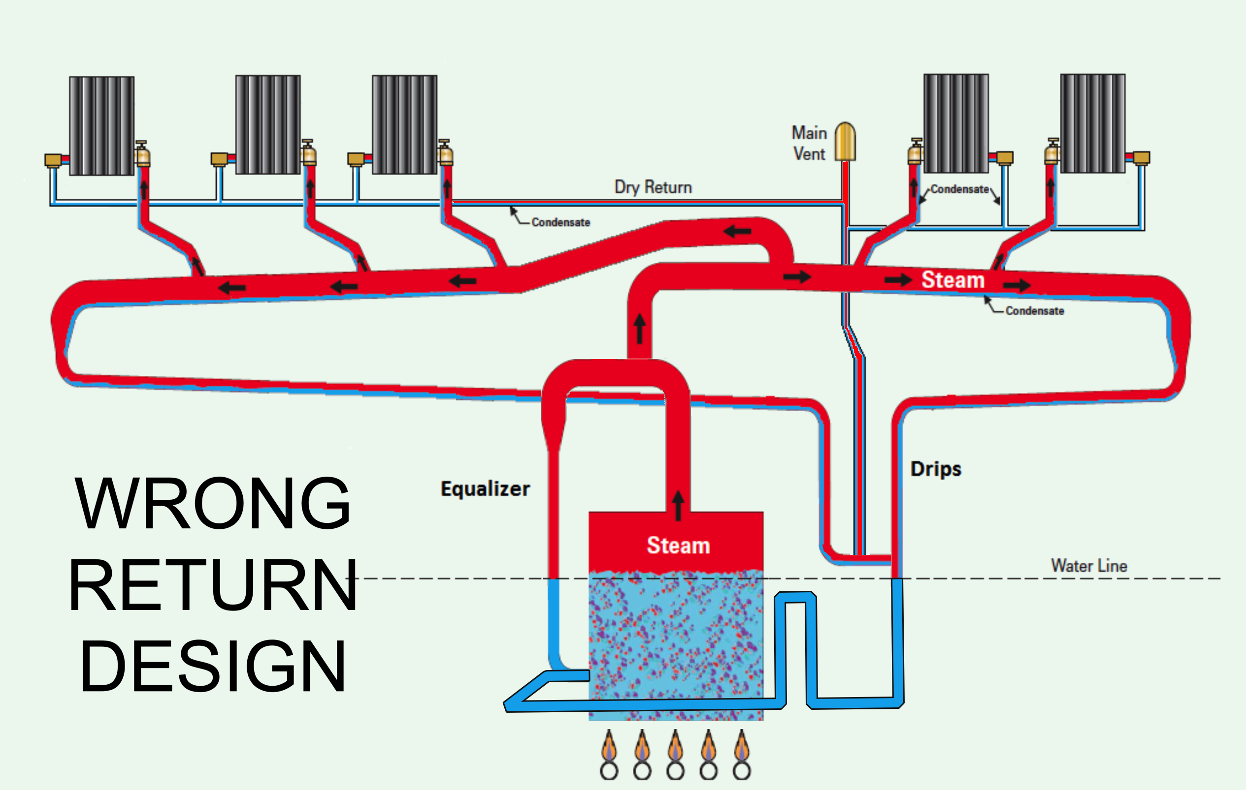

    This is what you have pictured.
    There is no true Hartford Loop if that raised portion of the wet return does not tie into the equalizer just below the boiler water line (and above the minimum safe water level). In your current design, steam or air cannot break the siphon if the wet return fails.
    In the @109A_5 yellow-arrow photo, the three return drops are above the water line, which allows steam to pass from one return drip to another. They need to connect below the water line so a water seal prevents that cross-connection.

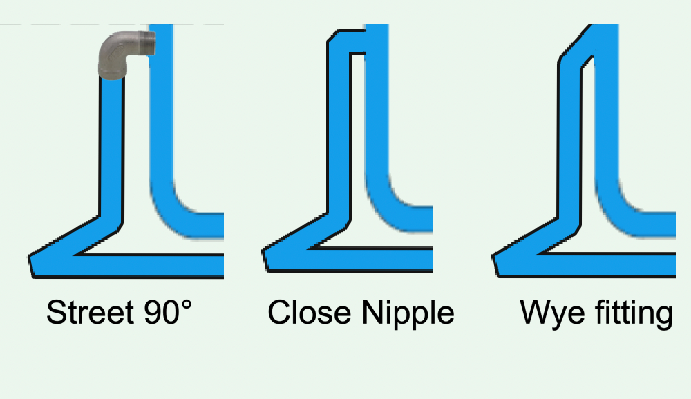

    And don't forget the connection at the Hartford loop should be a close nipple or street elbow, or a Wye fitting.

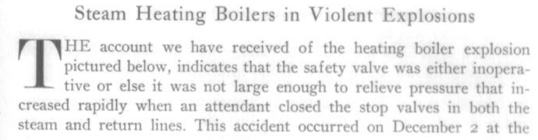

    Did anyone see in that document any cases where the Hartford Loop or lack thereof was involved? Most of these cases are hot water tanks it seems.
    Was there something about wet returns back then that caused thousands of them to catastrophically fail every year??
    This case is indicative of what I believe were most of the explosions. Simple human error or inattention:
    This guy was apparently experimenting to see how fast his pressure would increase…kind of like what I do in my videos haha

    Right now the piping is connected to the second 2" port on the boiler rather than the equalizer line. This will be reworked to tie into the equalizer pipe which itself returns to the boiler on the left 2" port of the boiler. The right 2" port will be converted to have only a drain valve.

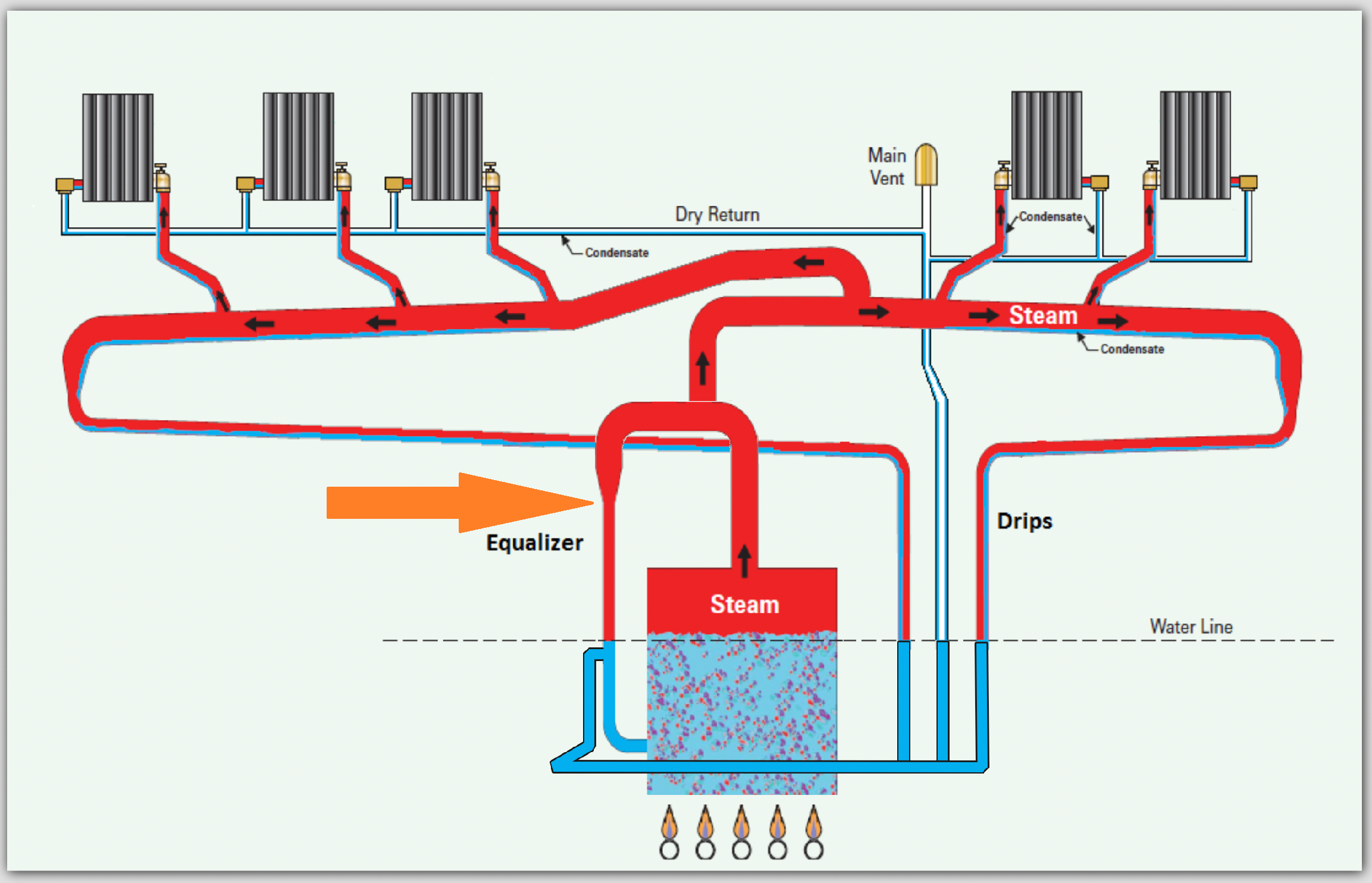

    The equalizer pipe size is 2" and the drips and dry return are 1.5". Question; where is the best place to reduce from 2" to 1.5"?:
    • At the tee in the equalizer pipe
    • After the street elbow coming off the equalizer tee
    • The vertical after the street elbow
    • The horizontal at the floor
    Thoughts?
    Any of those are fine. As long as you don't reduce it in the horizontal in such a way that it can trap water(and in an equalizer even that is less important) you can do it whatever way works out best.

    Thank you, its looking like just after the street elbow in the vertical will be the best place given the spacing.
    edited February 12
    Often the reduction is in this area (Orange arrow) I forget how old your boiler is. If there is an install manual available for the boiler that information of the manufacture's recommended pipe sizes would be there. Bigger won't hurt so if it were reduced just above the Hartford loop connection that would be fine too.
