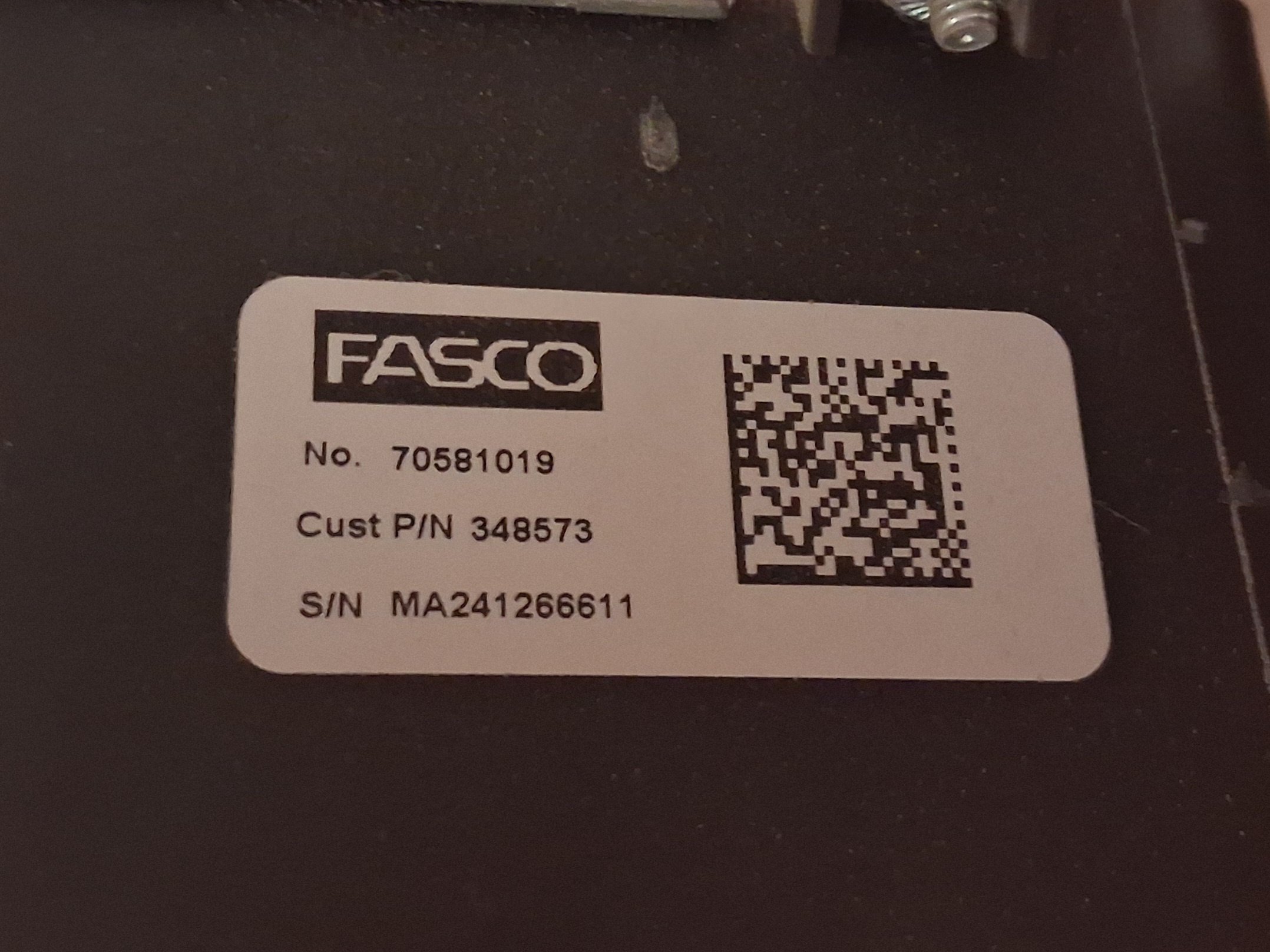

Need help id-ing this blower
Tried using all the numbers on the decal but nothing comes up. It's working but starting to vibrate.

That is a different number, 7058119, when i googled mine, nothing came up and supply house couldn't find anything on it as well.
You think that is a good replacement for the 70581019?
Thanks

Edit: found it
Bryant 245-8, 430k btu, 2-pipe steam in a 1930s 6-unit 1-story apt building in the NM mountains. 26 radiators 3800sqf
Just checked based on your model number The OEM number changed twice since that was built, the "customer p/n" also changed to "S1-026-42550-000" which is discontinued and replaced by
S1-026-49696-000 which is a different number than the supply house link that I posted. the correct part number also comes up there with no photos, the master distributor I checked this with has a description that matches supply houses description. they have photos but they are too blurry to read anything
York S1-026-49696-000BLOWER COMBUSTION 120-140 BTUhttps://www.supplyhouse.com/York-S1-026-49696-000-Blower-Combustion-120-140-BTU
There is also someone on ebay selling an original for about half price if you want to roll the dice
(the link doesn't work but it comes up with a google search if needed)

If its a brand you deal with regularly my best suggestion is to text your wholesale sales guy, they should have distributor logins to check part numbers via serial numbers. All wholesalers have a valuable tool with a well known master distributor that lets us look up parts breakdowns, cross references etc for products we don't have easy access to. It's basically like supply house on steroids but only sell to wholesalers. Depending on your wholesaler you might get faster results here anyway though lol
1 -
Your probably better off searching by using the boiler or furnace model and serial # that the fan #
