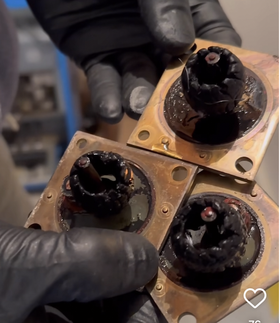

    The life expectancy of the ball inside and the stem o-rings has a lot to do with water quality, I believe.
    As I recall theses were only a few years old and the ball completely deteriorated, Perhaps a combination of aggressive fluid and excessive velocity eroding the ball.
    Other HW are running fine after 15 years or more.

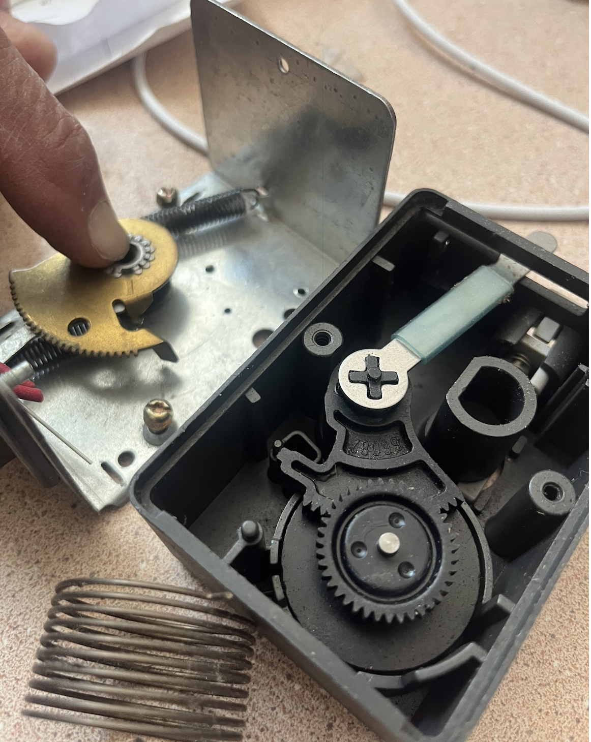

    We estimate perhaps 5000 cycles per year, most manufacturers design the components for 100,000 cycles or a 20 year life span. We have cycle testing machines in the lab, a few years back we put some Sunnywell, a HW knockoff, valves on the test bench and got about a years worth of cycles before they failed.
    I did see the You Tube where a tech completely cleaned the old grease out, but he put oil on the plastic gears, I doubt that rebuild will last too long, the grease is an important part of the design.
    Normally open valves have a shorter life span as well as valve inside the fin tube enclosure due to ambient temperatures.
    A HW - Caleffi comparison, gears and springs are substantially different engineering

    I've not seen any as bad as those. Boy oh boy. Luckily the repair is pretty simple. In my experience I think it's been unmaintained antifreeze that's cause the trouble but I'm not sure.

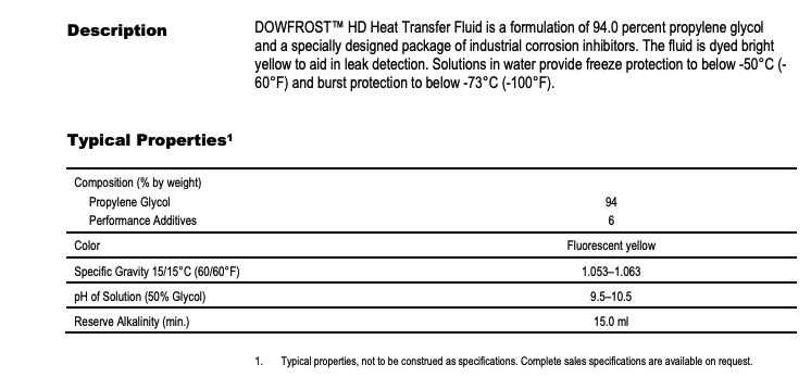

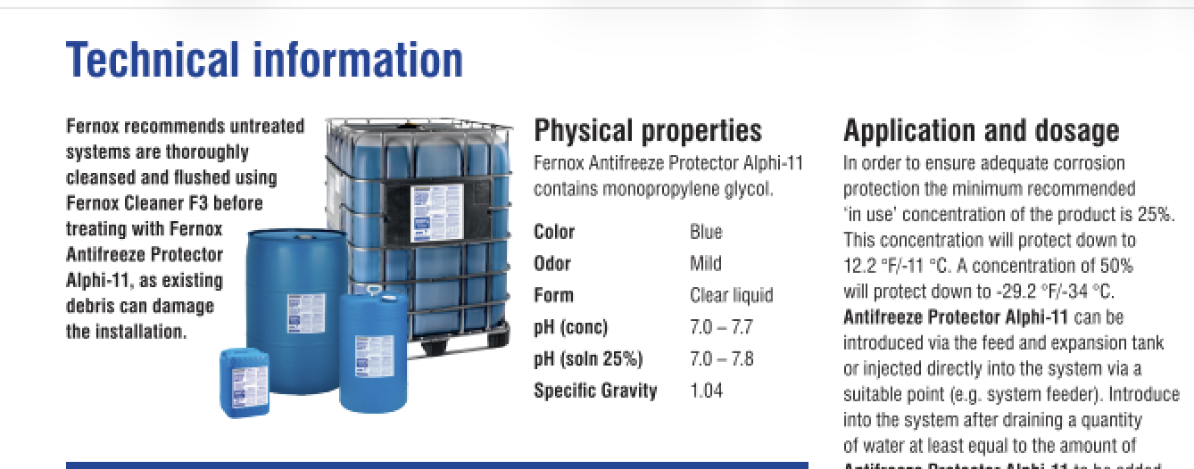

    yeah, any time you work on ANY glycol systems, take a ph meter and get a reading. The acceptable ph varies a bit from brand to brand.
    DowFrost PG vs Fernox, for example. I think Dow suggest dumping the Dowfrost if it gets in the 7s?
