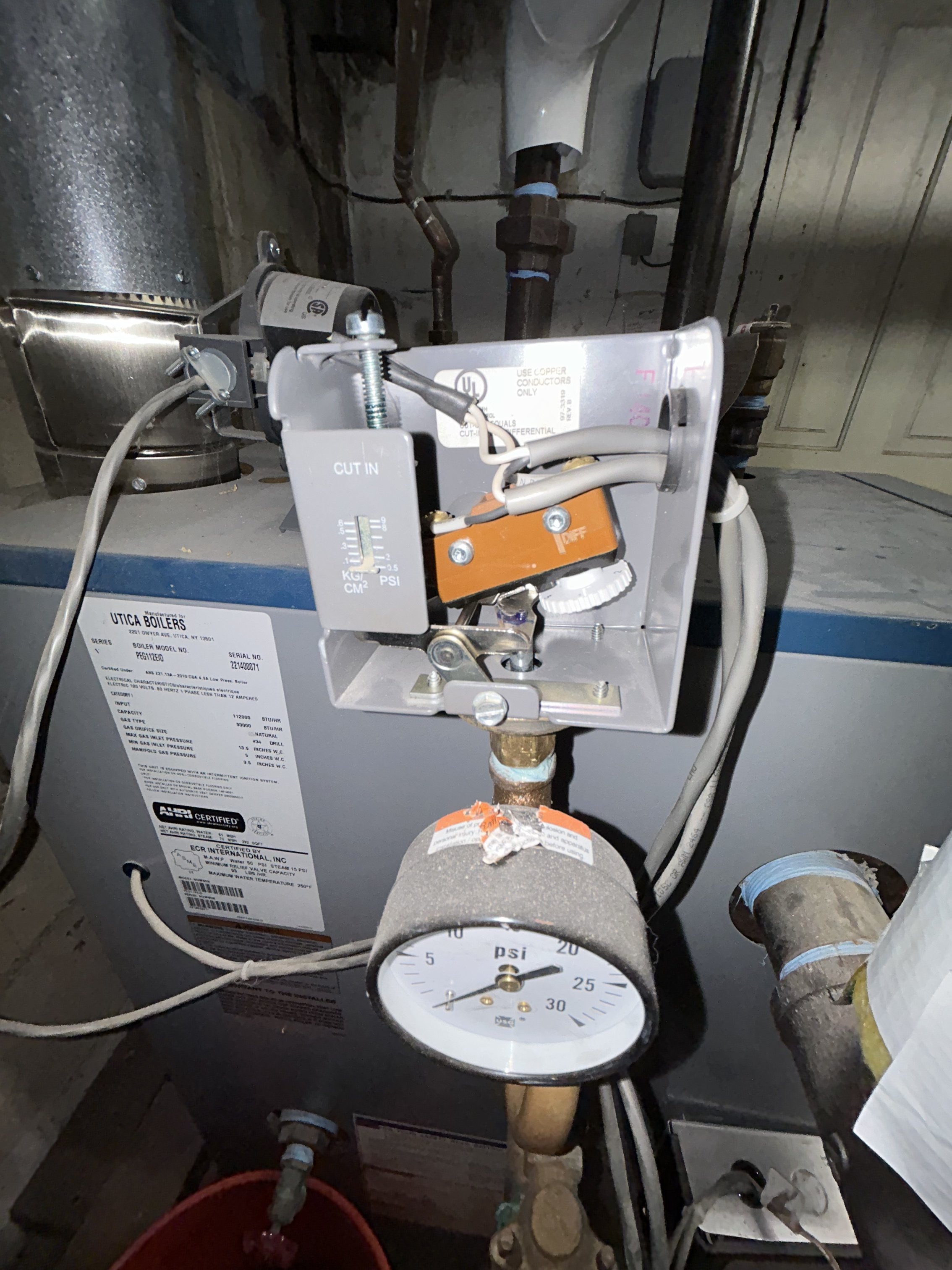

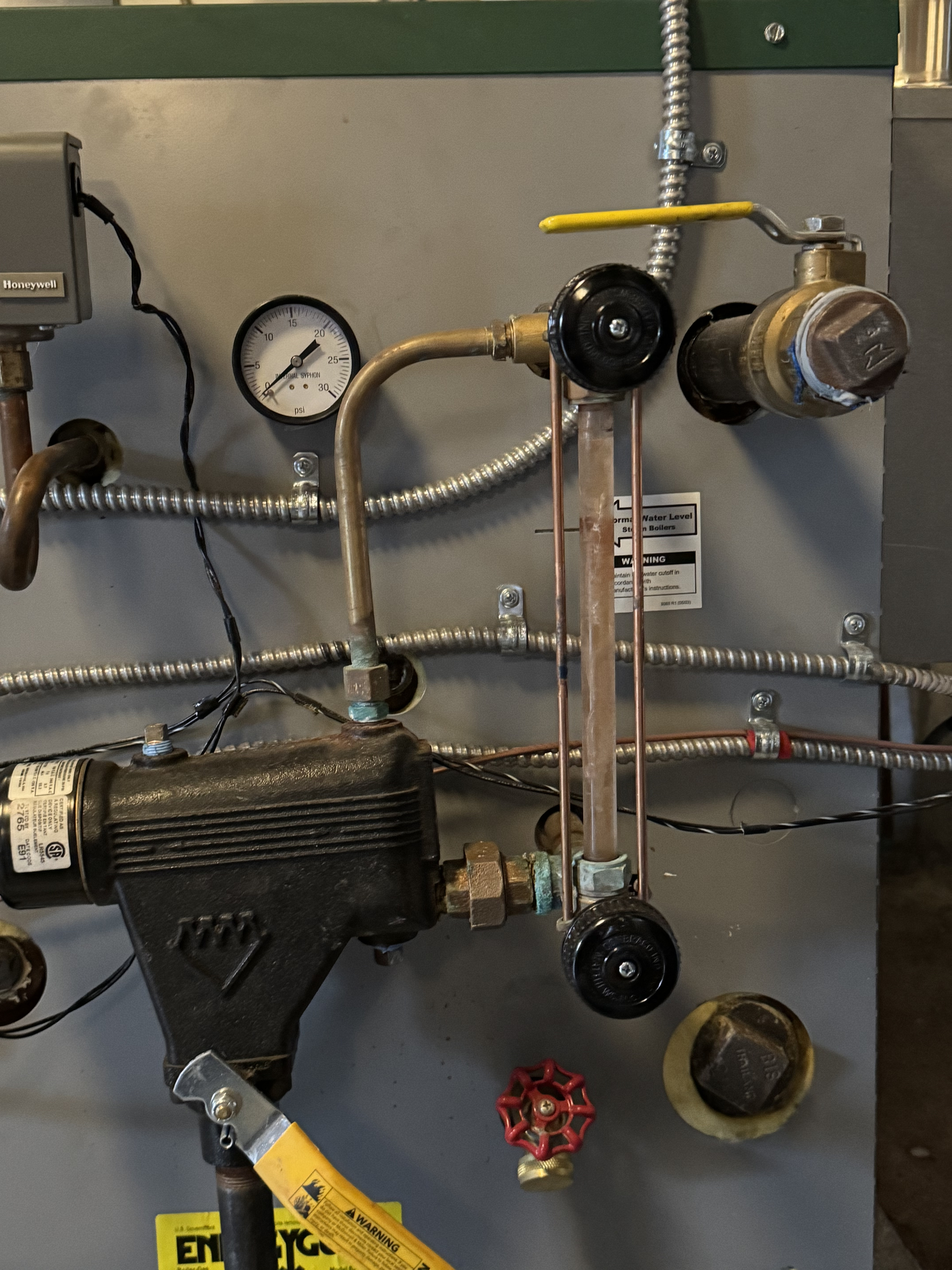

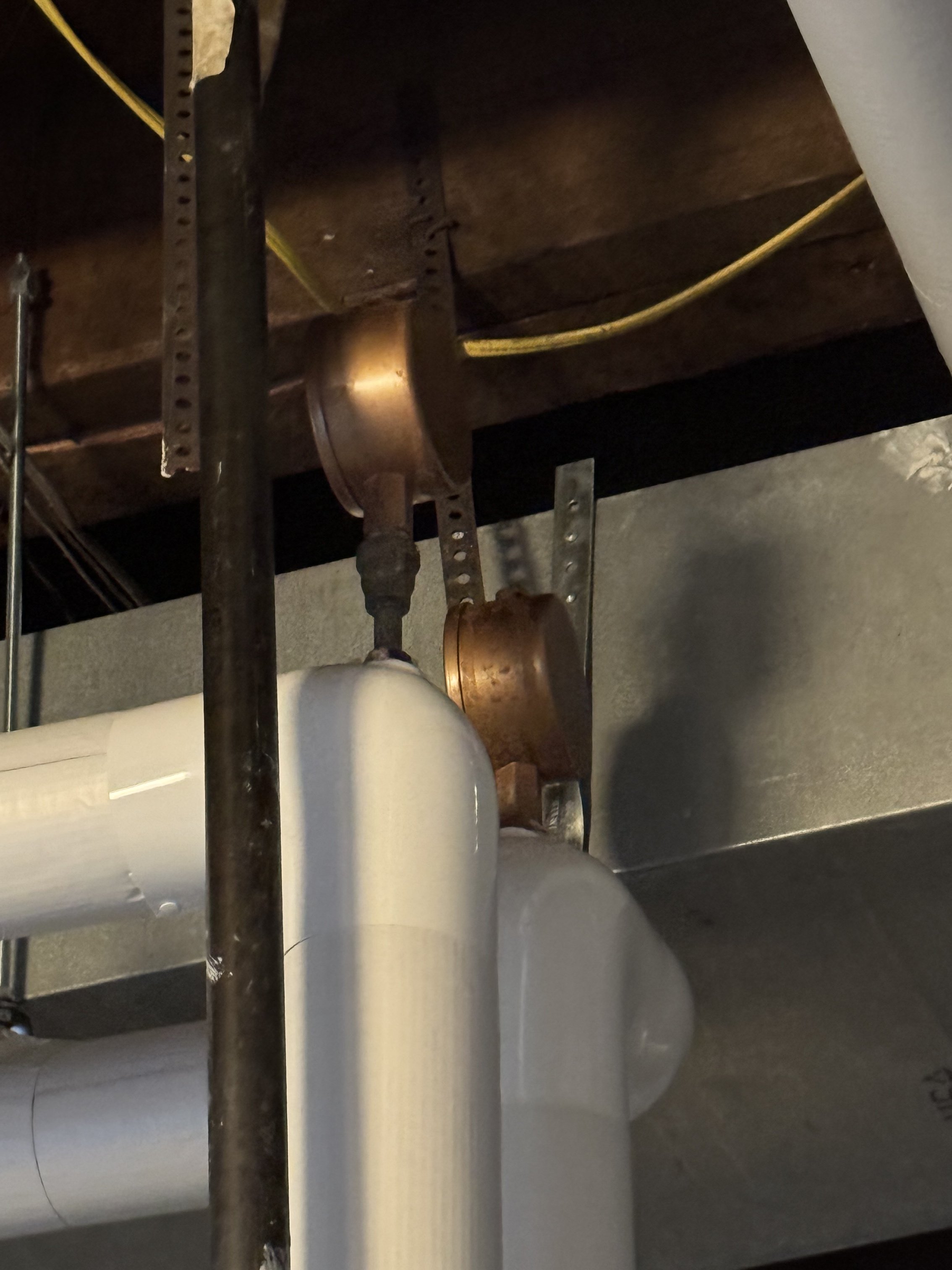

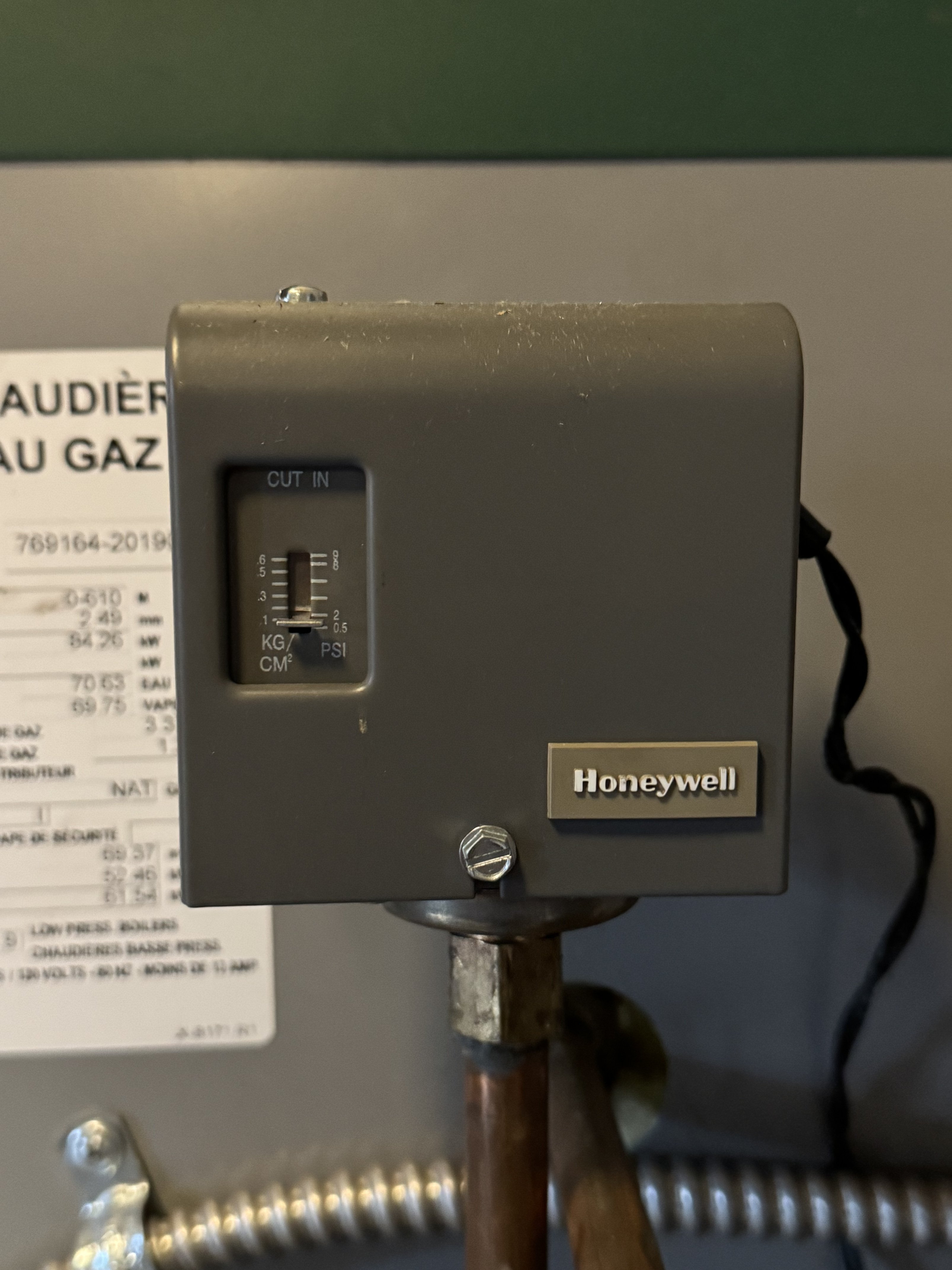

    I don't remember if I mentioned this, but I do indeed have a pressure gauge, and it never moves at all whatsoever (Not sure why Utica uses a 0-30PSI for their pressure gauge assembly). I fully disassembled and cleaned the piping down to the top of the sight glass and replaced the pig tail last off season. This is why I keep saying I think something is wrong with the POS Honeywell pressuretrol. I looked at every piece including the brass tee, the 1/4" nipple. I ran a pipe cleaner and water through it. I watched every single Silent Steam video. Nothing. Thanks!
    Also ignore the absolutely disgusting water, this is a picture I took right after we moved in. I doubt the previous owners even looked at the boiler except to dump endless cold water make up water from the manual valve.
    ethicalpaul Member Posts: 8,405
    edited January 23
    All the manufacturers supply a 0-30psi gauge because it is code that the gauge must be rated to twice the maximum operating pressure of the boiler (I have been told). The pressure relief valve on a residential steam boiler is at 15 psi so that's why the gauges are always 30psi.
    If you doubt the pressuretrol, then it would be good to purchase a low pressure gauge to put in that spot (temporarily) or in another spot (could be permanent) to see what the actual operating pressure is when you are hearing the hissing.
    Then you'll know if you the vents are bad, or if the pressure is just too high.

    Go to youtube. search on Silent Steam Team. Go to "videos". Search on "pressuretrol". That should get you to the ones for your pressuretrol.

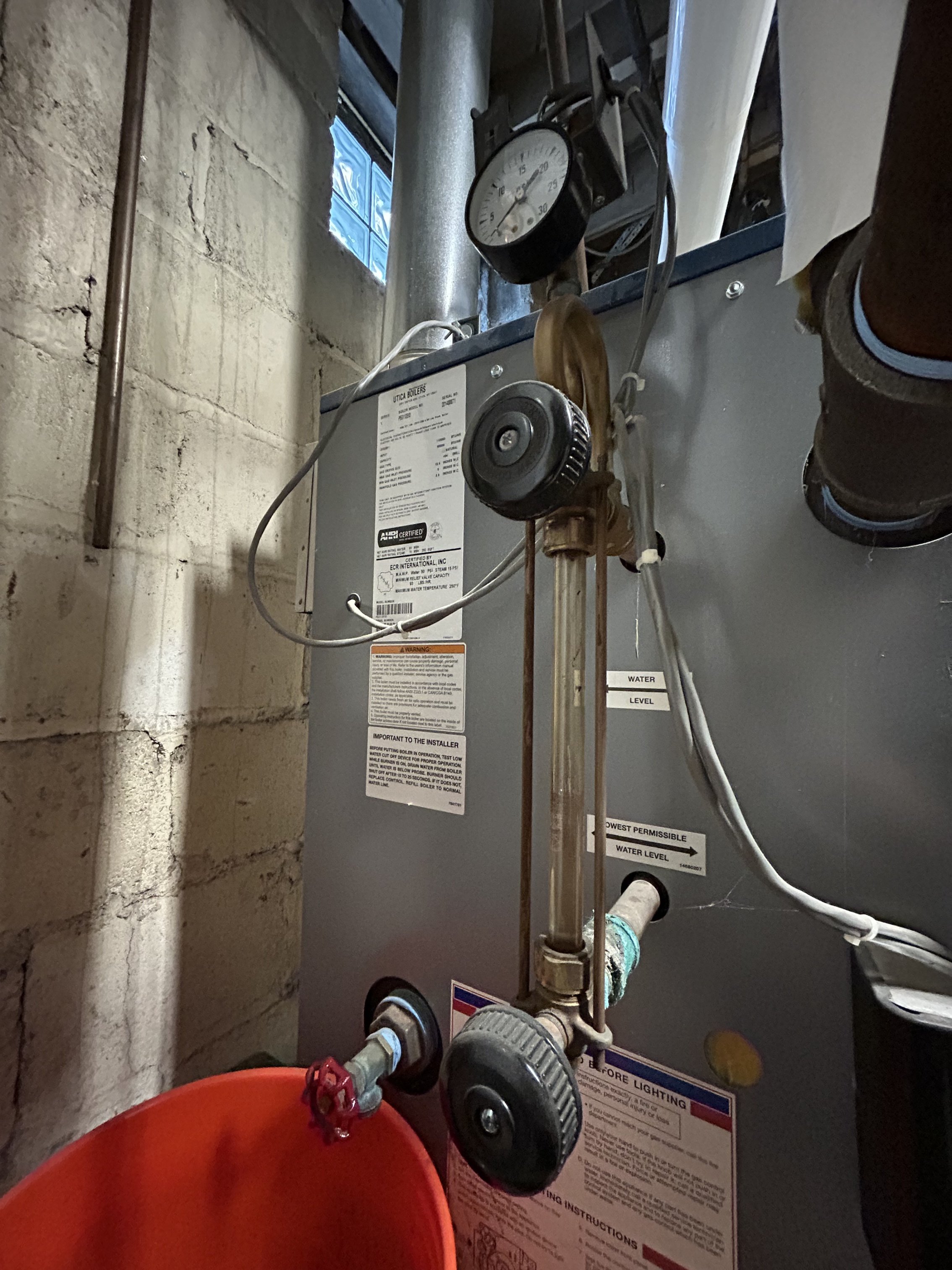

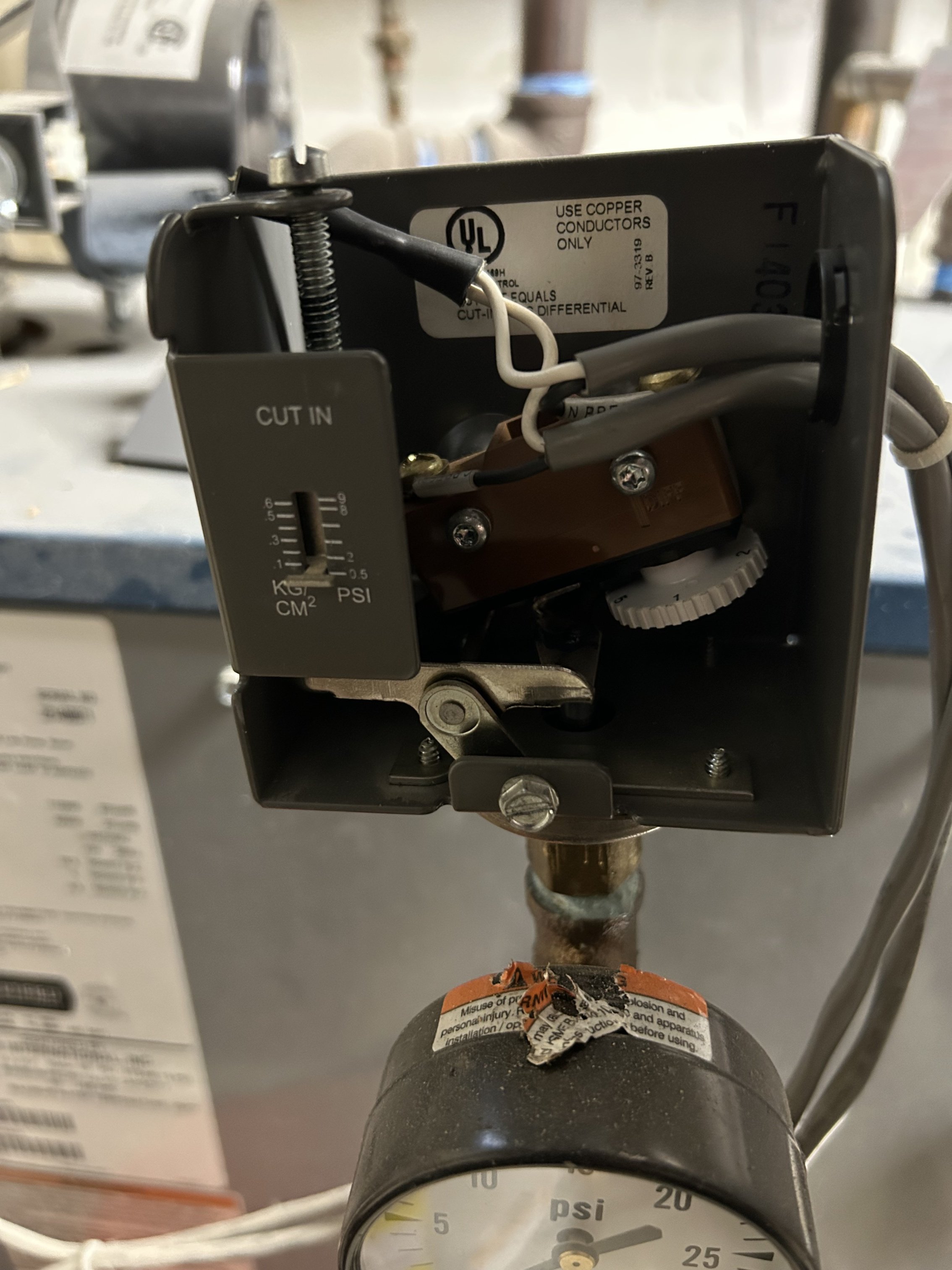

    We need more pictures. Front, and other side of the boiler, showing all the piping going out of and into the boiler.
    Better picture of the pressuretrol, closer up and in focus, with and without the cover (only one screw to remove cover)

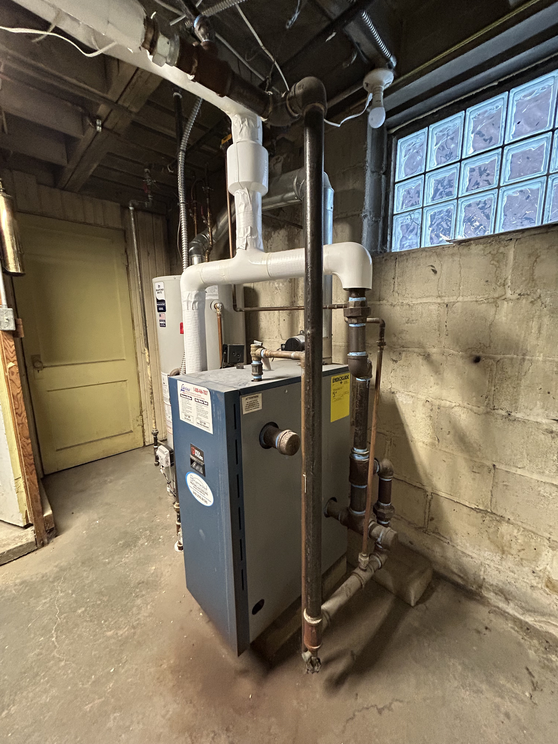

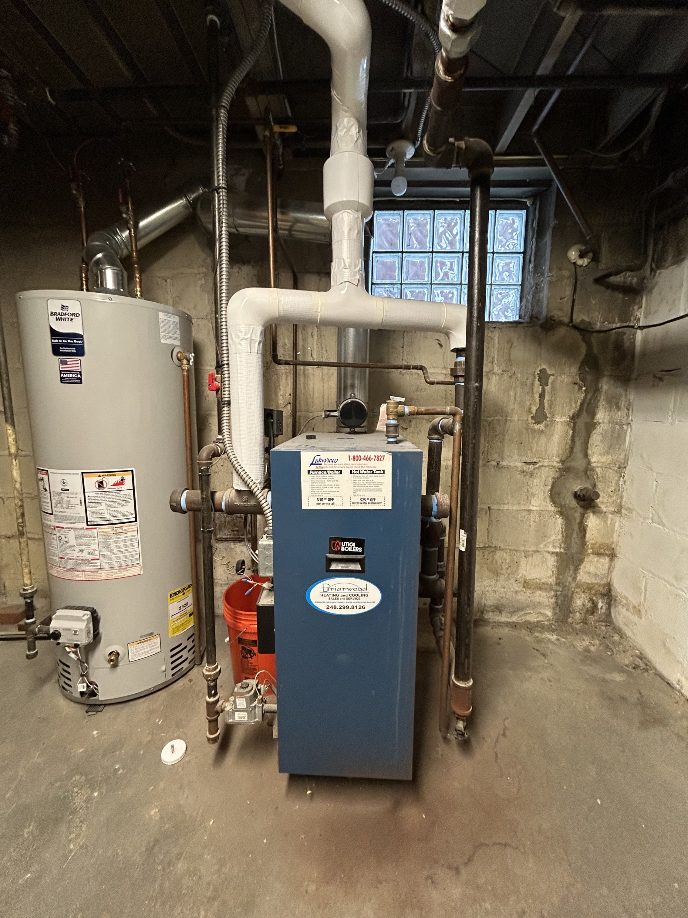

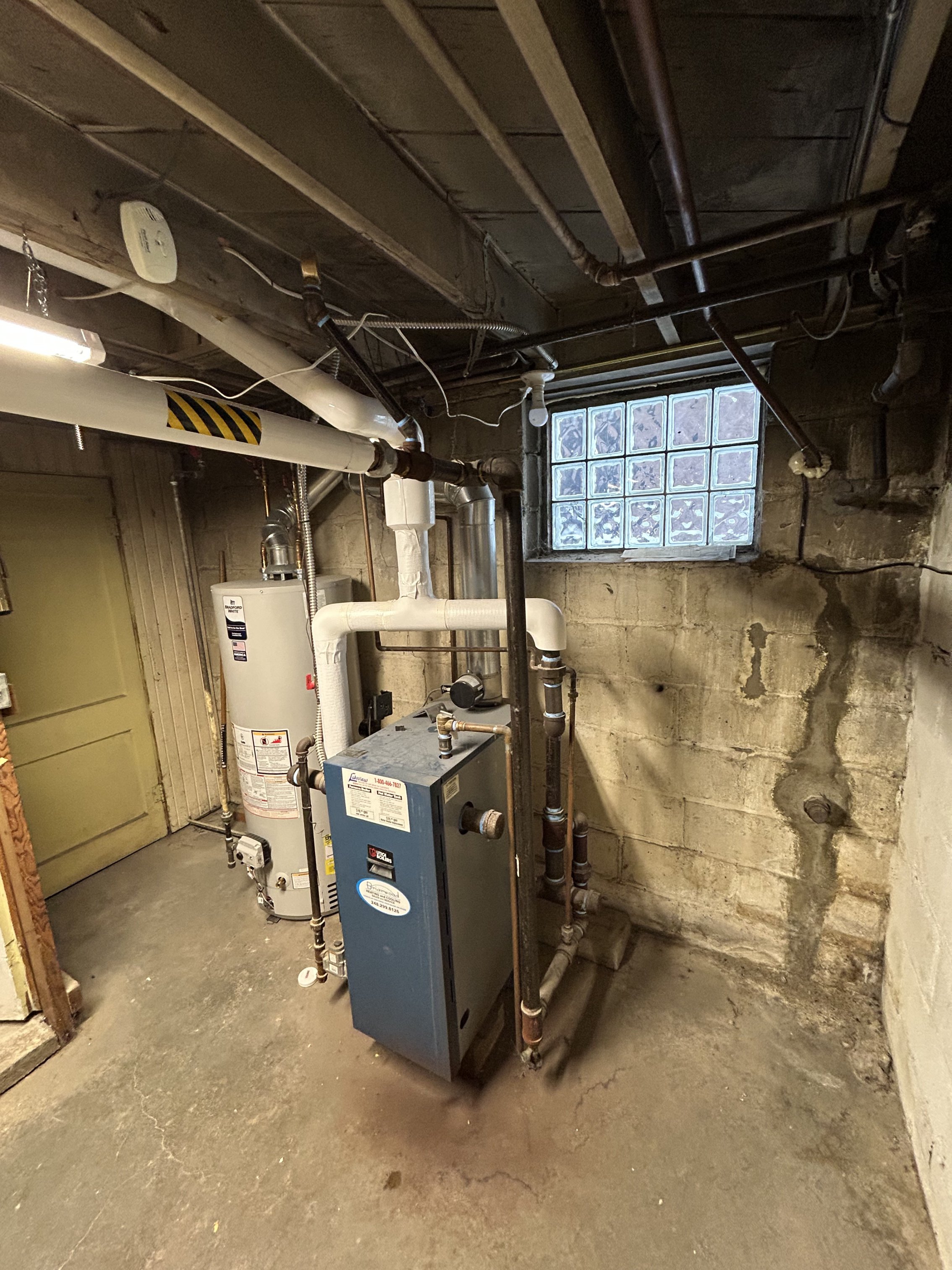

    Here are some pics of the system when running

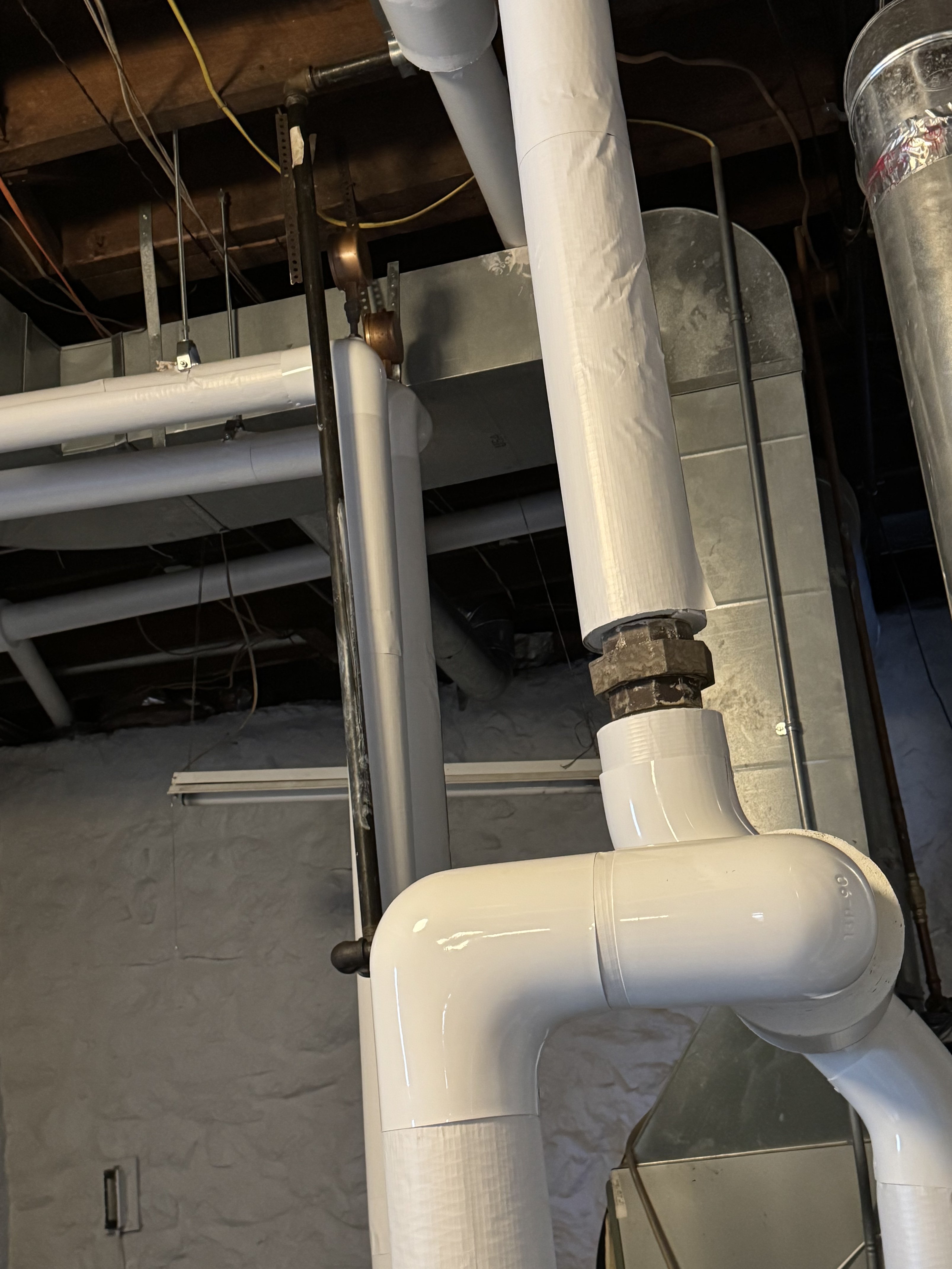

    Can't tell what I'm looking at with your boiler piping photos. Need pictures a bit further away and from multiple angles. But, it looks like your header goes into a bullhead tee with one side going up to the main and the other becoming the equalizer. That would be super wrong.
    We need photos of the other side of the boiler showing the Hartford Loop. Measure with a liquid level (clear tube with water in it and a helper) or something, from the top of the Hartford Loop close nipple or elbow to the normal water line of the boiler (should be marked by manufacturer)
    We still need that crucial photo of your pressuretrol with the cover off (remove one screw at the front bottom), showing the internal dial setting. It looks like your cut-in may not be as low as it could go.

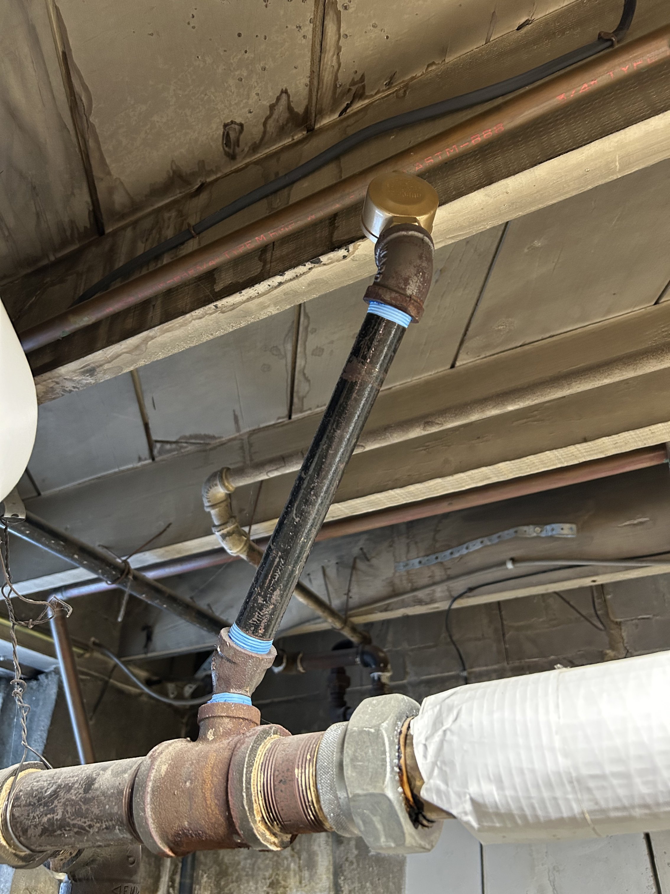

    Now we're getting somewhere with those pictures. Supposed to have a 3 in. riser and header on your boiler, for only using one riser. See if you can find out what you have. My 63-04L is supposed to have 2-1/2 in. but only has 2 in.
    That different angle shows what I suspected is not the case, with a bullhead tee.
    We still need the pictures of the critical Hartford Loop side and the inside of the Pressuretrol showing the dial. I feel your pain with dirty water on carpets.

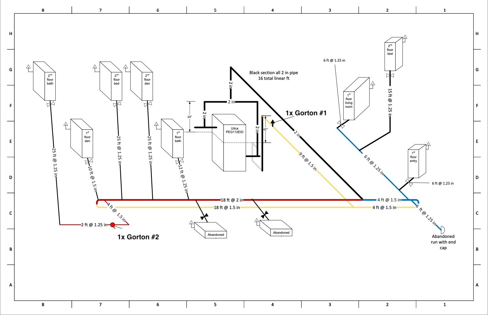

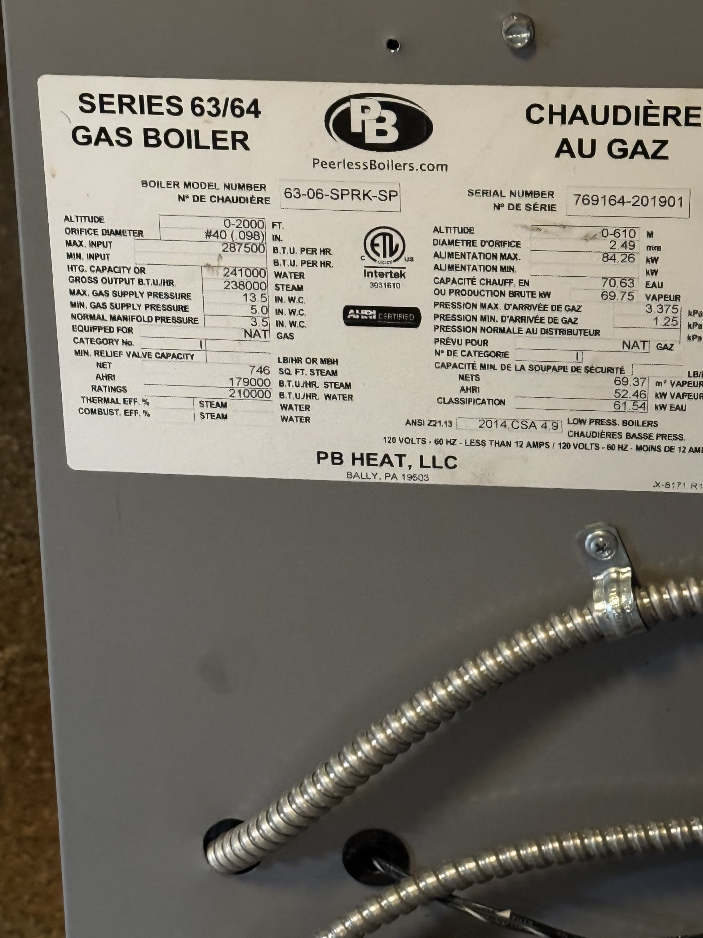

    I don't know what your overall connected sqft of radiation is relative to your 746sqft of boiler rated steam capacity but if your boiler is at all oversized you have to make adjustments for extreme cold weather. I have a 35% oversized boiler yet most of the winter am able to do 5 or 6 degree setbacks and recoveries without issue because I manage those recoveries broken up into controlled on off cycles that limit continuous firing time of the boiler thus avoiding pressure rise. Pressure only rises in the system as radiators one by one start to completely fill up since then there is less place for the steam to go and the boiler doing what boilers do continues to make the same amount of steam until either the thermostat, the pressuretrol or the low water cutoff tells it to stop. So, to avoid all this in extreme cold weather think about what you can do to avoid all or most of your radiators completely filling and thus building pressure. Answer:
    1. Minimize the required heat - Lower or eliminate your setback if weather is going to be extremely cold. Only you can define what extreme cold is for your system based upon your experience. I am one of the few proponents of setback on this forum but where they do save me money on normal winter days, once night time temperatures get below 15 degrees or so they don't do anything for me but make morning recoveries noisy. If your system only needs to raise the home temperature a degree it is going to take less cycle time than 2, 3 or 4 degrees. I normally go from 59f to 66f but last night and the night before here in Michigan I just set the temp on hold a 65f and went to bed… (-14F this morning)
    2. Run more shorter cycles - Setting your pressuretrol or vaporstat lower will do this to some extent but they are both still reacting to some level of pressure rise which indicates you are already running a longer cycle than optimal. One simple thing most people can do depending upon your thermostat is to adjust your thermostat control to help minimize cycle time. If a cycle per hour type setting then set it for the cold snap on 2 instead of 1. If a swing temperature range type control set it on +/- 0.5 degrees instead of +/- 1 degree. You can always switch it back if you care to after the polar vortex has passed.
    When it comes to the main venting it looks like you have a Gorton #2 on each main which may be sufficient. Have to know your total steam main lengths and pipe sizes to know for sure. Where more main venting makes the most difference on a system is during extreme cold snaps because most of the heating cycles start off with very warm steam main piping and thus the rate of steam advance is less hindered by condensation in the mains themselves from heating up the mains. This isn't going to change your late cycle hissing though, only any hissing that may occur early in the cycle after the boiler starts creating steam and before the main vents closed.

    After holding the temp at 72 during the day, and 71 at night the hissing has mostly subsided. When it does hiss it's much shorter. Putting my finger or phone near the vent fogs just a bit. I just spent $500+ last season to replace all my vents so I'm not spending another dime on these POS.
    The dial on my pressure gauge on my boiler never moves during operation and the pressuretrol doesn't do anything during operation. It is completely broken. I have every setting correct and have checked the piping from the close nipple through the pigtail to the top of the sight glass. The pressuretrol is f*cked. There is no reason my vents should be hissing if my settings are correct because the system should never operate above 1.5PSI.

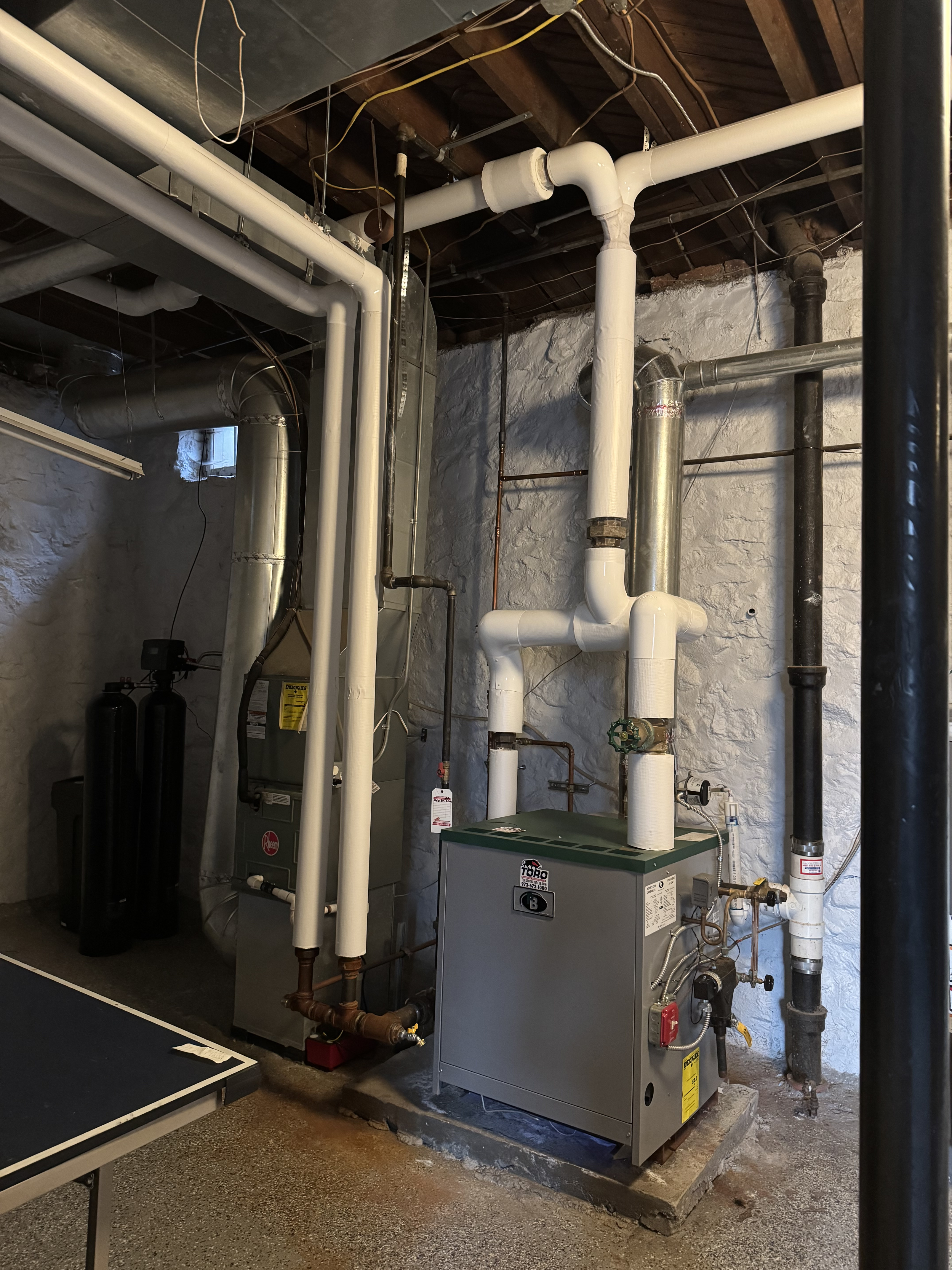

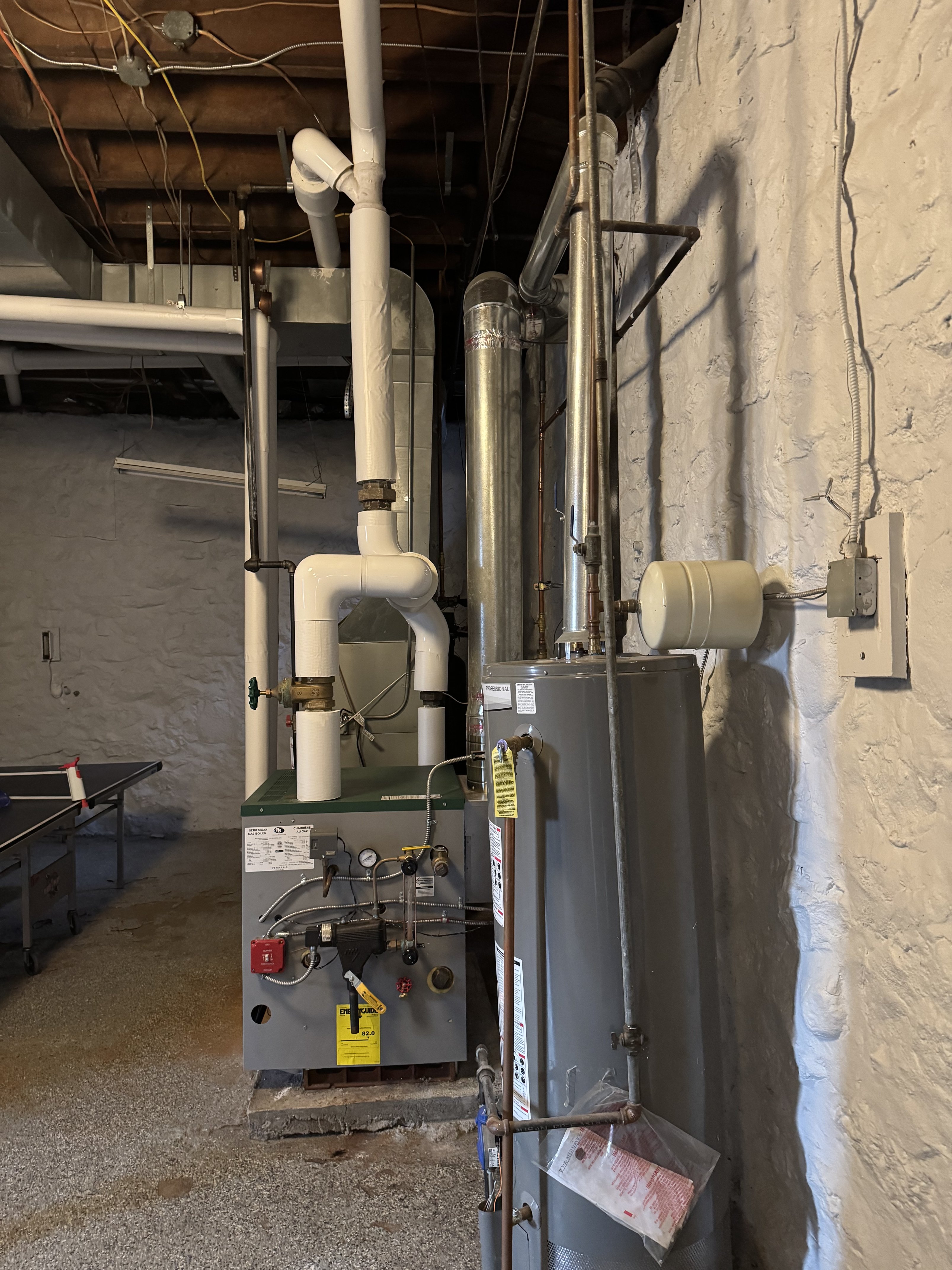

    IMG_4644.jpeg IMG_4645.jpeg IMG_4646.jpeg IMG_4647.jpeg IMG_4648.jpeg IMG_4649.jpeg IMG_4650.jpeg System Diagram.jpeg

    If you don't have a low pressure gage there is no way you know your pressure trol is not working. Vents will start hissing at more like 0.5psi. It doesn't take 1.5psi to make them hiss particularly if your boiler is oversized or it is after a few radiator vents have closed.
    Day_Tripper
  • Day_Tripper
    Day_Tripper Member Posts: 42
    Thanks @dabrakeman I have a low pressure gauge ordered and on the way. It's just odd that the needle never moves even a mm off of 0 even if the range is 0-30. I feel like I should see the needle a bit in the 0-5 range of my current gauge. Reducing setback during the cold stretch has helped with the hissing.
    dabrakeman
  • dabrakeman
    dabrakeman Member Posts: 906
    Yeh, my 0-30 gage doesn't move even when when my true pressure reaches 1.5psi. I verified this when I was tweaking the settings of my pressuretrol.

    @dabrakeman ok so if my gauge is worthless what, if any functionality, should I see from my pressuretrol? Should the normal cycling operation take the system pressure from 0.5(1st heat cycle start) to 1.5(1st heat cycle stop/temp not yet reached) back to 0.5(2nd cycle start) back to 1.5(2nd heat cycle stop/temp reached) etc or something like that. It shouldn't just run the entire time until the intermittent low water check stops.

    That single Gorton #1 is way undersized for all that piping that it has to vent (mains plus dry return). You could do a tree and add a second one or you could just put a Gorton #2 in, which is about equal to 3 #1 and only slightly more expensive. Also, I'd insulate the long nipple you have going up to that vent.
    I don't like that type of main where it tees off in two directions but that would be super expensive to change so you are probably stuck with it. So hard to balance, especially with only one shared vent location after the dry returns tee back together. Would be much better to have separate main vents at the ends of each subsection after the tee in the main.
    What is the height of the top of the close nipple in your Hartford Loop relative to the normal water line in the boiler. That one photo showing the level in your sight glass looks like it could be below the Hartford Loop. That will cause water hammer and prevent proper return of condensate to the boiler. My opinion is too many clown installers are putting the Hartford Loop way too high.

    I have a #2 at the end of my 'red' line. I addressed this when we moved in with the help of the forum (https://forum.heatinghelp.com/discussion/201019/need-help-balancing-steam-system). I need way more venting on my 'red' line because it's much longer than the 'blue' line. So i tried to balance this with a #2 at the end of the red and a #1 at the return so the steam wouldn't wrap around a trap the red line. As you said it would be quite the expense to repipe this.
    I can't get an accurate measurement of the height from the hartford loop close nipple to the water line because the indicator is opposite the loop. My guess is it's between 1" and 2". I looked at the utica manual for my model and figured it was ~2" and then said it doesn't really matter because I'm not repiping s*it. We don't really get any water hammer fwiw. Thanks again.
  • Captain Who
    Captain Who Member Posts: 584
    My bad missing that other main vent. I'd prefer to see another vent at the end of the blue line but I see your runners are exceedingly long. And then you could do away with the one at the end of the shared dry return. Kind of a tough call.
    You need to get a section of clear vinyl tubing and make a water level. Have a 2nd person help you. It will wrap around the boiler and you will be able to find out where that Hartford Loop is installed relative to the NWL. Look at your boiler manual for further guidance as to where they want it to be. My Peerless manual says top of close nipple 2 to 4 in. below the NWL. Dan Halohan video had a different take and was even lower than that. You won't necessarily get audible water hammer. You could still have serious problems from this without hearing that. Condensate has to be able to return freely to the boiler.
    I don't know if you have mentioned whether or not you have checked all the pitches of all the pipes. 1" per 20 ft. downward pitch for mains and returns and 1" per 10 ft. for runners.
